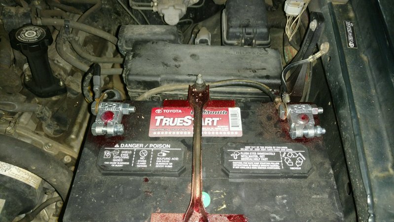

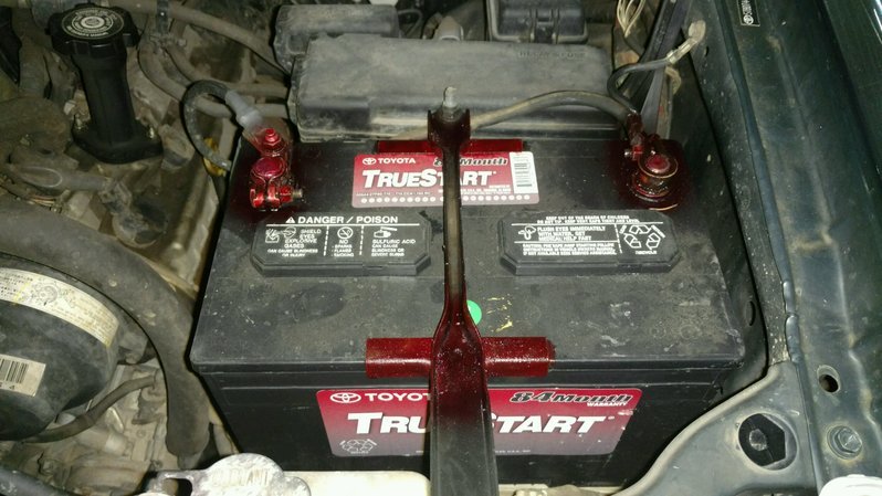

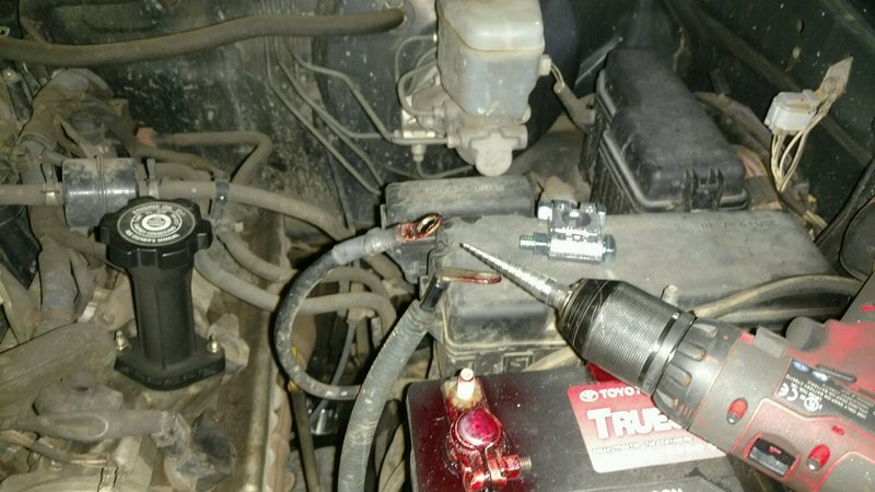

    Getting to do some prep for the coming mods. The battery terminals on any Toyota are fairly weak under high load conditions. I don't have a high load now, but should by the end of the summer in the form of a winch.
    I like the MIL spec terminals for my applications, every one of my trucks/4runner have them installed. They are rated over 600 amps if I remember correctly. I decided this time to enlarge the factory ring terminals to fit the new terminal end. I just used a step drill and went to town.
    Final install allows for more connections at the battery terminal and a cleaner look. I should be installing my switch-pro this next week some time. Not in a hurry because it might not power anything before Moab, depends on lighting showing up.

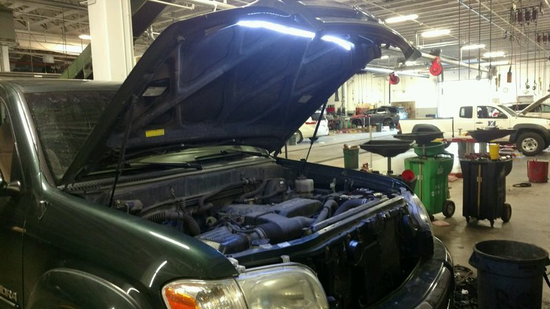

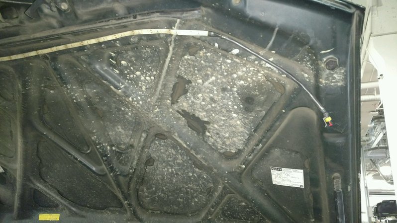

    I saved my Anti-Dark from the Tacoma. It is a nice quick install job so I took care of that tonight.
    I cleaned the old adhesive off and applied new 3M trim adhesive, easy enough.
