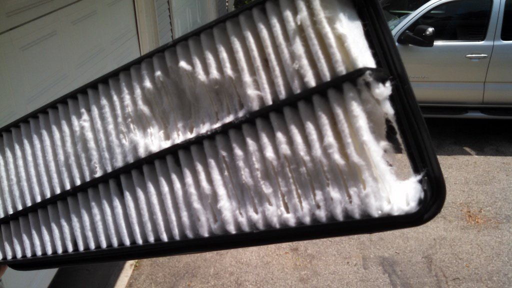

    I was going to work, got a 1/4 mile down the road and the engine died on me. Multiple restart attempts failed. Engine would start and run for about 1sec. and die again. Walk home and take the wife's car to work. My first thought was fuel pump. After work I checked the Ultragauge, no codes, and it would still die right after start. While digging in the engine I found it...

    The big reveal...
    MICE!
    SUCK!
    Chewed right through a brand new filter and made a nest in the plenum. The nest sucked against the screen starving the engine for air. So a good cleaning and new filter, the Tacos record remains spotless.
