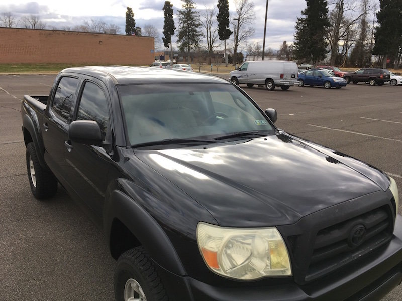

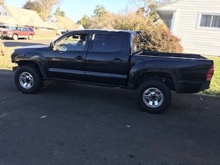

    Thought I would share my experiences disassembling & re-assembling my base model/Pre-Runner 2005 DBL cab for new paint. It will be going to my local MAACO shop as I cannot afford a $6k paint job. So I need to remove anything I do not want masked off for paint.
    I purchased this truck from my son after he had it shipped here to PA from Hawaii, his previous duty station. Since it has not been exposed to road salts and extreme low temps, it has no body or frame rot, and very little surface rust on the frame! The paint has taken a beating though and the roof & hood took the worst of it. It was purchased used from a company that had coated the roof with a bed liner to keep the rust down, which did not work.
    All of the exterior plastic has taken a hit as well. The flares and front bumper are totally faded, so they will be re-painted as well. The rear bumper has been dented & twisted, so that will be replaced.
    The only thing I am not removing myself is the door window trim and roof trim that covers the seams. That way weather is not an issue.
    The rear bumper was no big deal, four bolts and done. I will transfer over the supports, if they aren't too out-of shape. The front bumper I have had off before, so again, not a big deal. The big challenge for me was the fender flares. I have read the different threads covering this, so they were a big help. However, doing it yourself is always different. The big problem was not the clips, but the mounting brackets on the flares breaking off. No one warned me about this, WTF Toyota!?

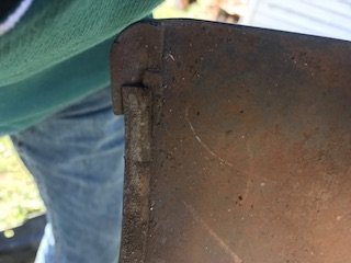

    The wall thickness is about .032 or 1mm!! Planned obsolescence for sure. So I had to come up with away to prevent this from happening. What I came up with keeps that from happening. I used two spackel knives and a panel clip removal tool to get the flares off of the fenders. When you place the knives on either side of the clip and pry with the panel tool, you have to lean up against the flare to keep the other clips from breaking. Worked perfectly! ( see how faded the plastic is ) I'll have the repair the brakes or order new flares! #*@#^!!

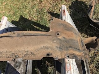

    I also removed the wheel houses as well. They were a huge pain because you cannot access the backs of the plugs that hold them in place, I had to cut the heads off of all but three of them! I will re-paint them if a good cleaning does not get a nicer look.

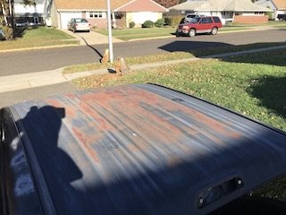

    Thanks JBCjr! Its good to see behind all of the sheet metal. I'm glad my truck does not have those rust issues!! As soon as I get the truck back, I will be applying fluid film to the fenders and wells, the frame too. Then the plastic will go back on.
    EDIT!!!... I have held off on the fluid film so I can clean & paint the frame first. I do not want to have to remove fluid film to clean the surface rust off and paint it.

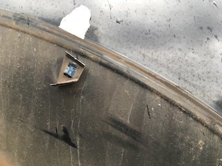

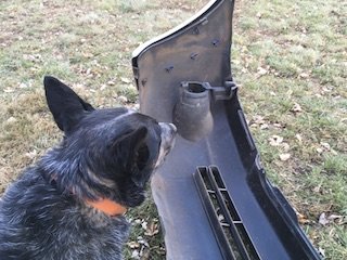

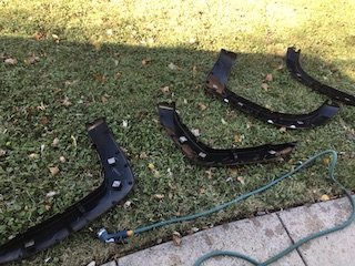

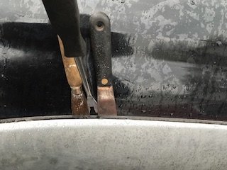

    Did some repairs and prep work on the flares. Had to clean them first, they were caked with Hawaii red-clay dirt on the back side.

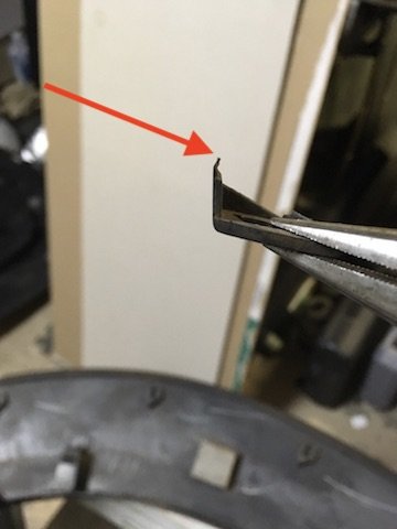

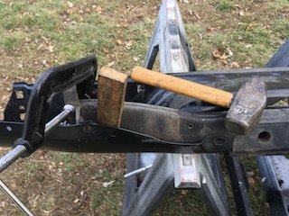

    Now I can repair the broken clip mounts. The thickness of the wall where they broke away from the flare is .020". ( less than 1/32" WTF Toyota!!!! )
    I found a Youtube video on how to repair broken bumpers, etc. Using heat and a steel tool, some metal screening and PVC tubing, I was able to make the mounts stronger than factory.
    I also removed the gaskets and the glue left behind. Lacquer thinner and a spackle knife got the rest off.

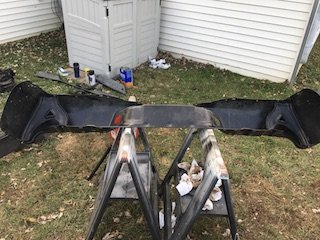

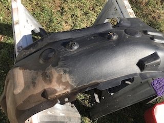

    Completed cleaning & painting the wheel houses and prepping the rear bumper.
    Again, more Hawaii red clay dirt. The stuff has stained the plastic, so I did my best to clean it off with soapy water and then lacquer thinner. I used Valspar outdoor plastic paint, black gloss. I turned out nice I think. Good enough for a 'little' restoration.
    I pulled the dented and bent bumper apart and then straightened and test fit the internals to the new steel.

    I did try the petroleum jelly, but as I thought, the staining remained. I was hoping it would work so I could return a bunch of paint!
    Sanded the flares with 400 to remove minor scratches and blemishes.

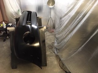

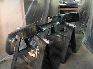

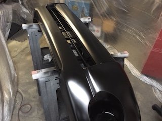

    After turning my model shop into a paint booth, time to prime & paint. I had my temporary booth set up so I just ran the plastic to it. I used Rust-oleum 2&1 primer and Satin black to for finish. After a second coat, they turned out great so far. One down, three to go and then the bumper parts. Also received all the parts I ordered through Amazon today, clips, screw anchors and gaskets. Big thanks to @chertzog for listing the parts in his thread!!

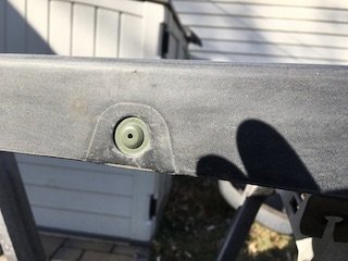

    Got the center section of the bumper painted, and I tried some Meguiar's Ultimate Black plastic restorer. It worked as advertised and better than I thought it would!
    Tested Meguiar's on one of the bumper pieces.

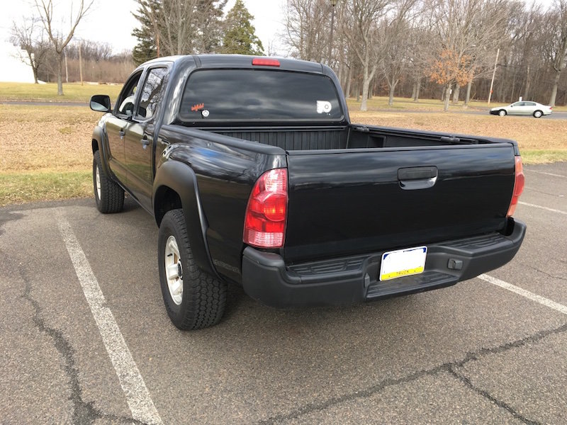

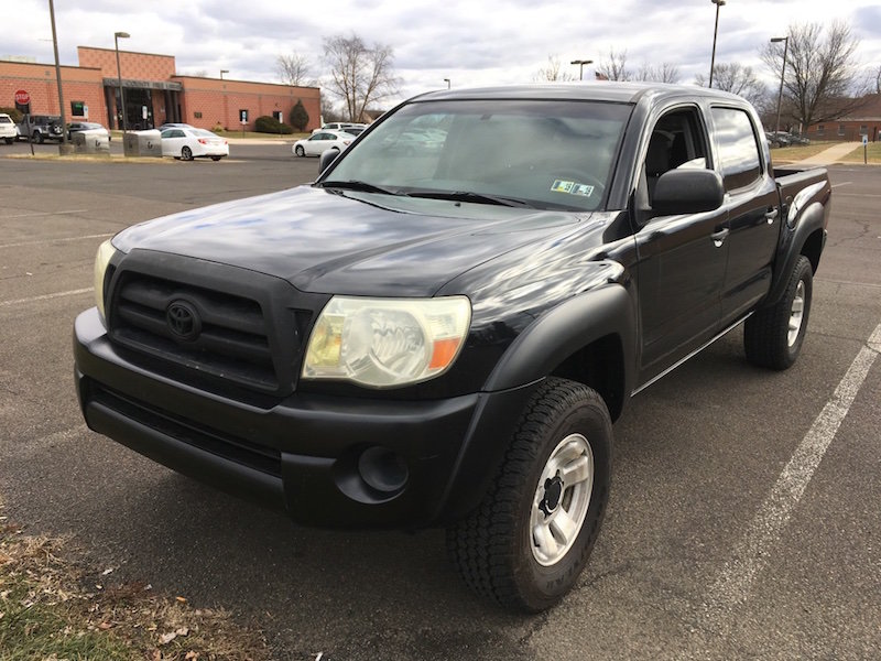

    Been quite a while, but here is the finished product. They missed a dent on the left bed wall and it was a week late getting finished, but the 209 color match looks great! I painted the flairs, front bumper cover. I replaced & painted the rear bumper. The paint is the single stage urethane. Still need to finish the grill and put in the fog lights. I also want to paint the wheels gloss black & replace the headlights. Warmer weather first!

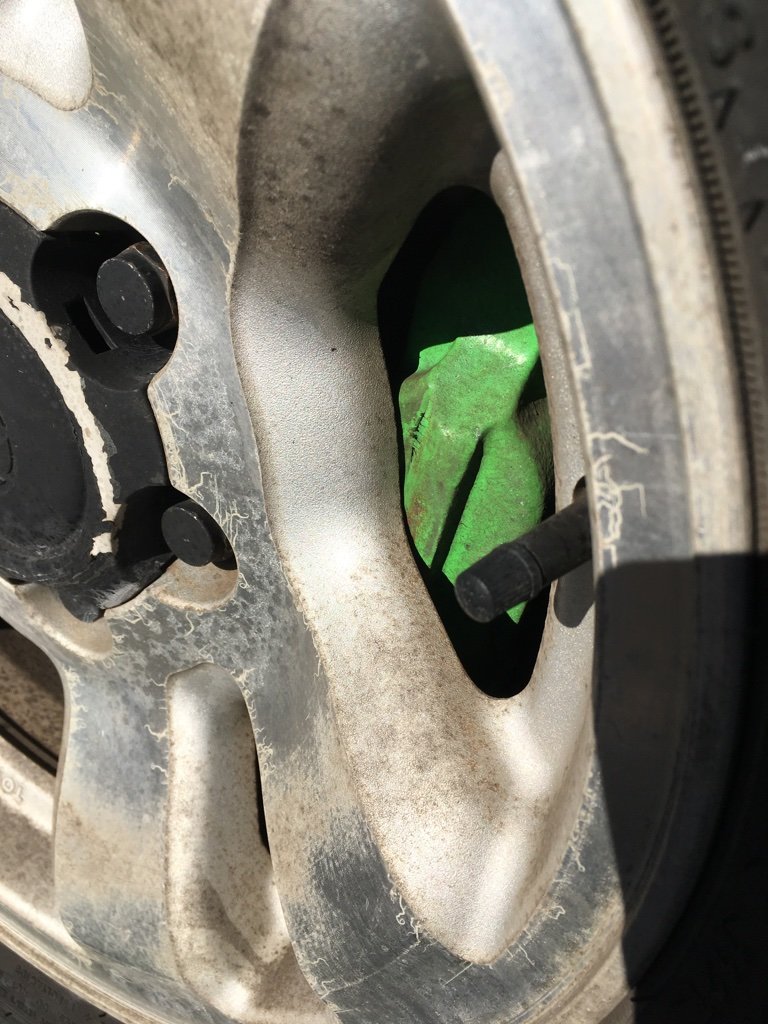

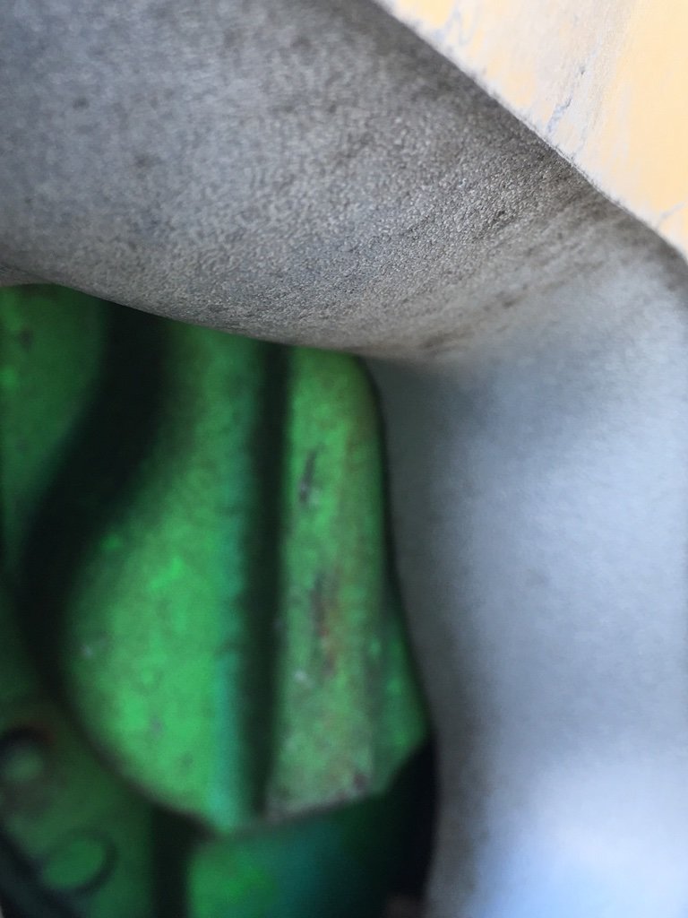

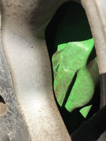

    So I have another issue that I would like some help with. The previous owners seems to have installed after market calipers. The reason I think this is, how close the calipers are to the wheels. The images show how close they are, barely 1/32"! There are also some rub marks on the calipers that tell me they are hitting the backs of the wheels.
    What would be the proper calipers to replace them with? I also wouldn't mind spending good money on nice black powder-coated calipers.
    I know Rockauto is our friend, but good quality is preferred.
    Along with that, the plastic center hubs need replacing- any suggestions?
    My intention is to have the wheels blasted and powder coated in black.
    Thanks in advance!

    Those look like OEM 2nd gen calipers.
    Those wheels are 1st gen wheels.
