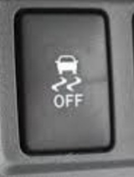

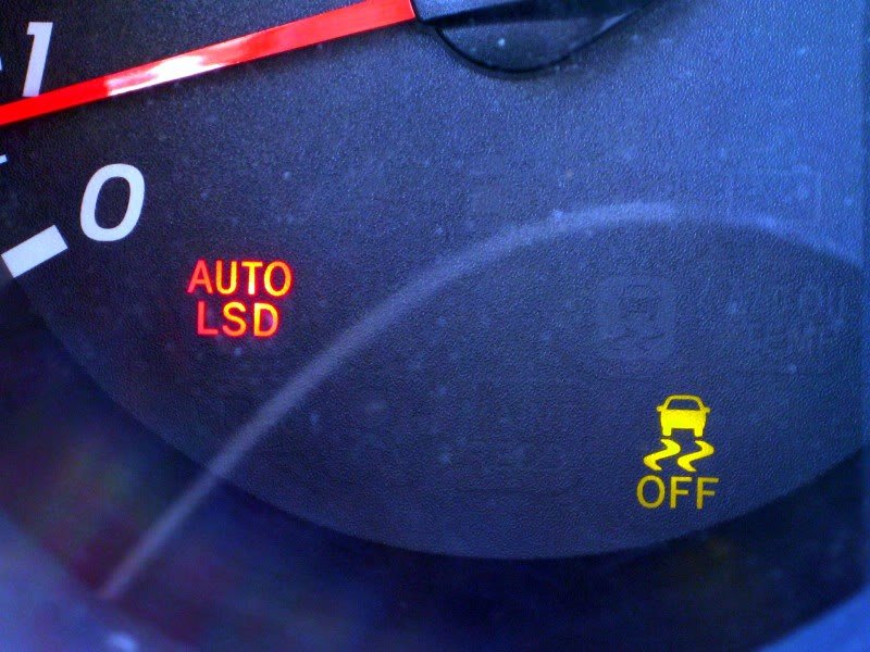

    I am wondering when I would use these functions and how they work. Anybody know? I have a 2wd so it would be great to know i have alternatives when I get stuck. Yes i used the search bar but not any clear answers. You either know or you don't lol...
    What does it mean when the lights turn on? The traction control is off i know but what about A-LSD? Is it making the 2 wheels spin like a locker? Ahhh so confused lol

    A quick push of that button enhances the limited slip if one tire spins to help the power go to the other tire with traction. AUTO LSD is not as 'pure' as a locker, but better than standard TRAC.

    For sand driving DO NOT turn off the traction control. Use AUTO LSD if you are a 2WD and have no locker.
    Understand that traction control (limited slip) divides power between the two back tires... not evenly as a locker does, but more so than with no traction control... which will likely find you having ONE rear tire spinning/ digging in and the other doing nothing (Hasn't everyone seen 'My Cousin Vinny' yet?).
    In sand, you don't need power as much as you need floatation. If your tire spins, back off the gas and do NOT dig yourself in deeper... Just more work to get you out. Instead, STOP and let MORE air OUT of the tires. 2WD, would best start at 10 psi and no worries. If you start at 20 and get stuck, then it's too late to try 15. Just go to 10, all four tires... do not drive fast and do not turn sharply or brake suddenly.
    4WDs can start at 20 psi and if the truck doesn't float (ie. struggles), stop and drop to 15. Use H4 and leave the traction controls on. 2012+ do the quick press for TRAC OFF mode. This is NOT traction control off, this is TRAC with engine regulation off.
