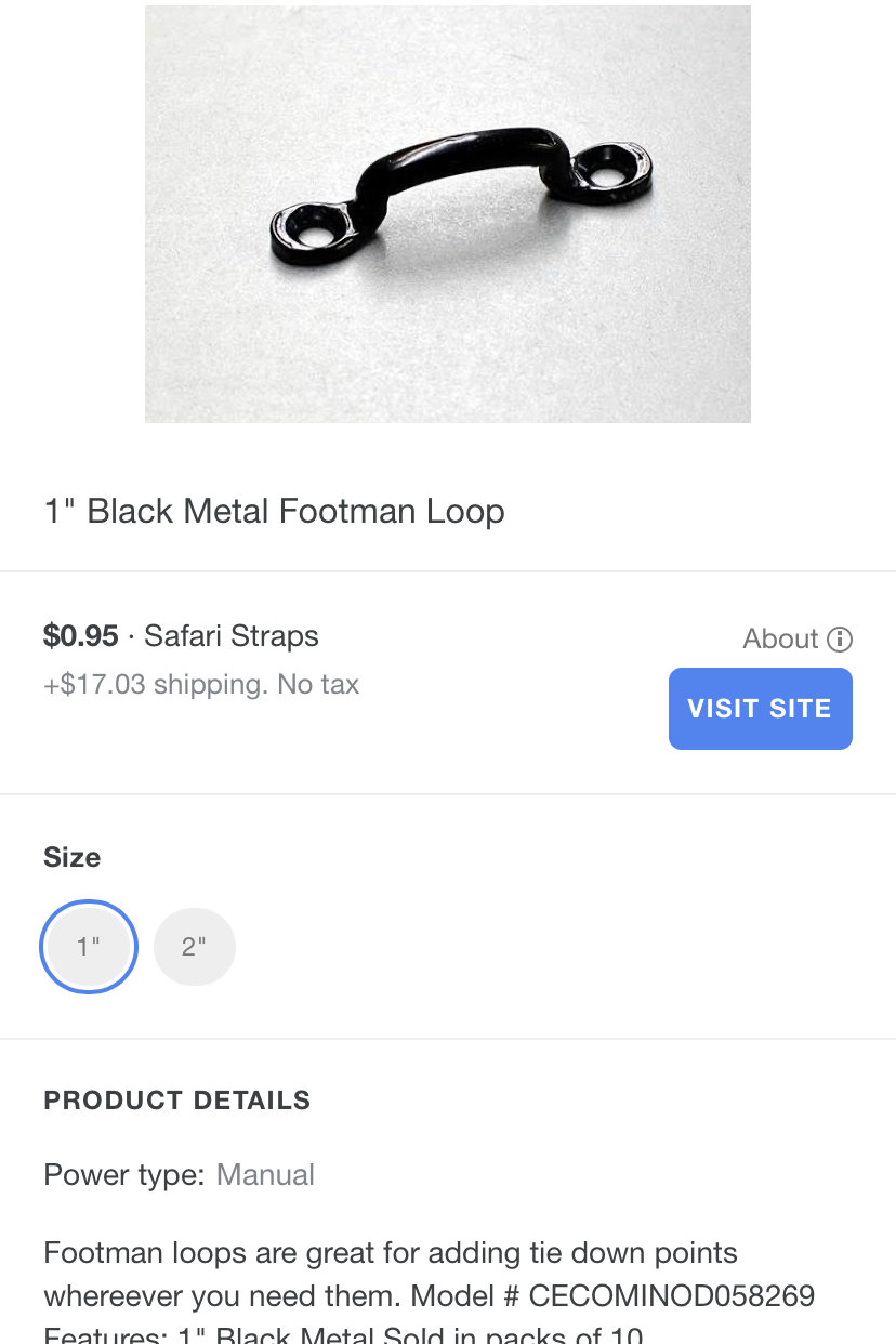

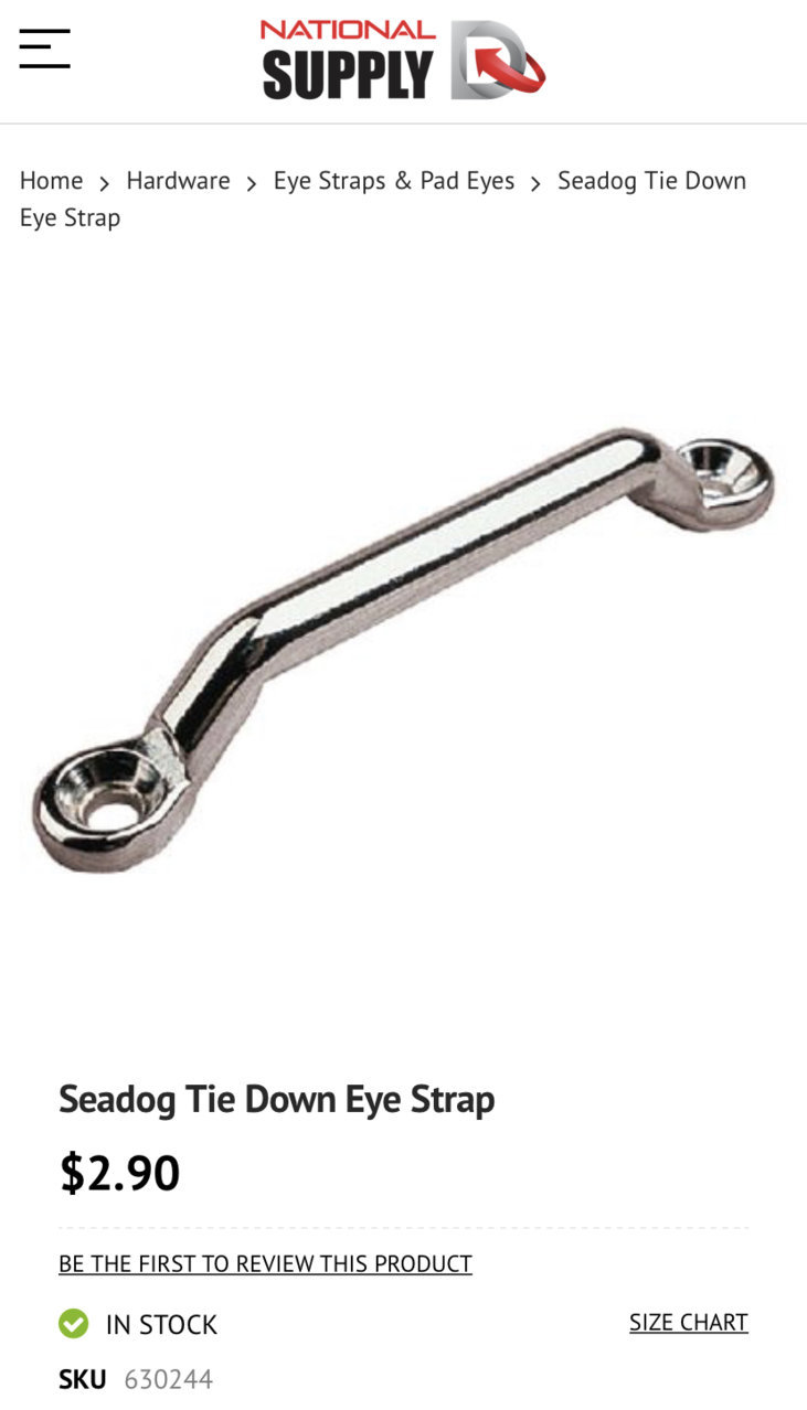

    I understand the purpose of the u shaped clamp, to hold the strap in place, but I was curious if you used the protruding metal clamp(painted black) for anything else?
    Edit: I removed the rest of your pictures in the post and only left the one I was referencing.

    I see what you're saying. It kinda looks like the u-bolt is rigged as a mounting point for something. Unfortunately, it has to stick that far out to allow passage for the strap buckle, allowing me to fully remove the trash bag from the truck for cleaning. The u-bolt doesn't serve any other purpose.

    Are there nuts inside the cover that hold the u-bolt in place? I have some scrap aluminum flat bar (1/8th inch thick by 1.5 inches wide) that I could counter sink a couple holes into and use a couple other small pieces of flat bar as spacers to allow the strap to move underneath. The spacers would mount to the center console and the top bar would screw into the spacers using countersunk holes. You would need to remove the top flat bar by loosening a couples screws to remove the strap, but that would only take a minute. Color matching paint would make it almost invisible and get rid of the u-bolt. Does that make sense?

    Makes perfect sense, and would look a helluva lot cleaner than my solution made of spare parts.

    Send me the measurement of the distance from center to center between the two holes and I will see what I can come up with.

    argh...

    Looks like a great solution. The only challenge will be seeing if the width matches up with the holes that were already drilled.

    true, theY come in all sorts of widths, or...
    thick washer(s) (as thick as the strap), flat bar, done.

    That, and spacing it out far enough to fit the strap buckle through. I don't want a permanently-attached trash bag, since I'm gonna want to hose the thing out eventually.
    That is the exact solution @ACEkraut came up with, manufactured, and sent me free of charge. Does this mean I'm sponsored now? :D
