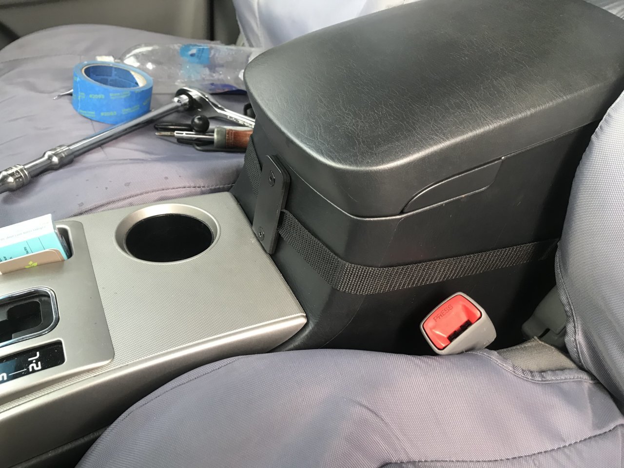

    Center console strap retainer (for back row trash bag)
    Before: u-bolt I had lying around
    After: color-matched detachable bracket, manufactured pro bono by @ACEkraut (thanks again!)

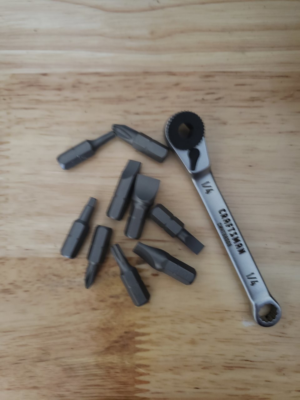

    I picked up a little craftsman racheting set when I installed mine. 20201101_102429.jpg

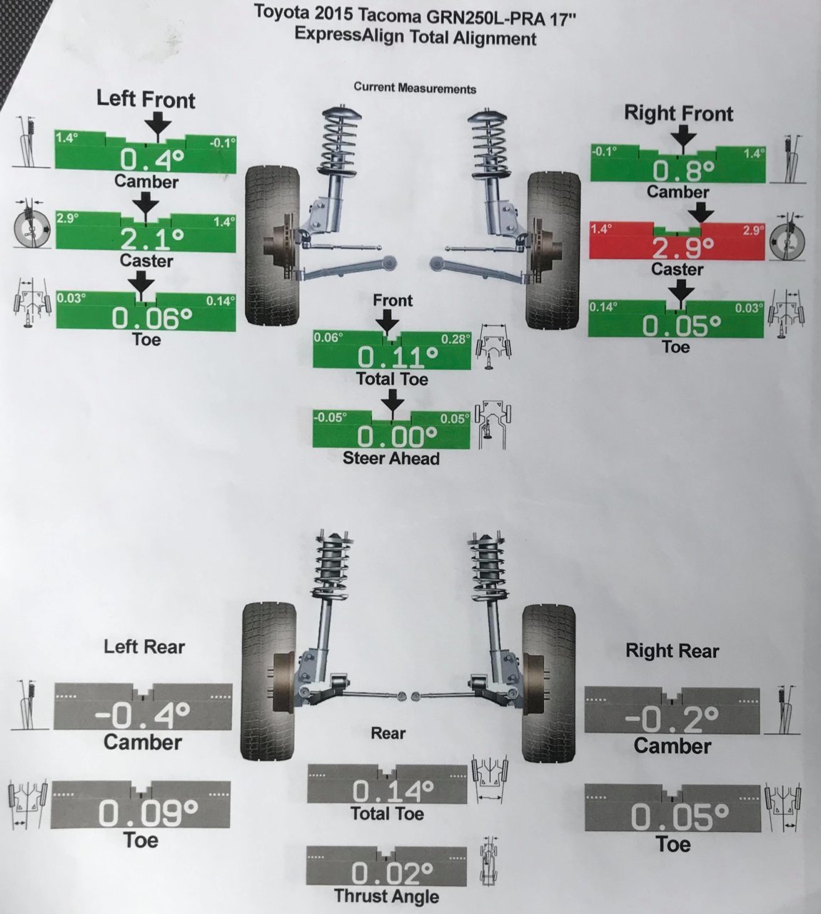

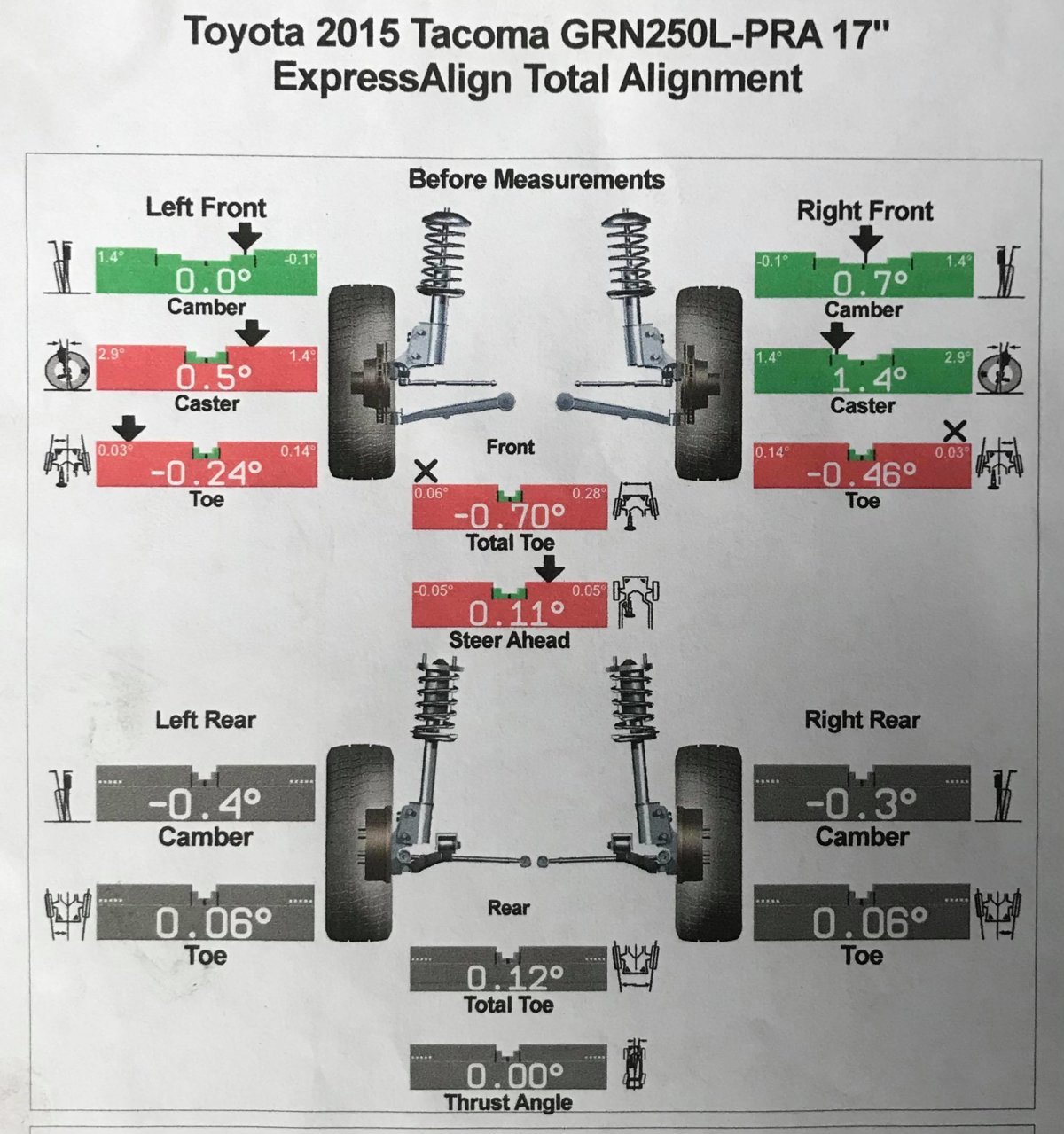

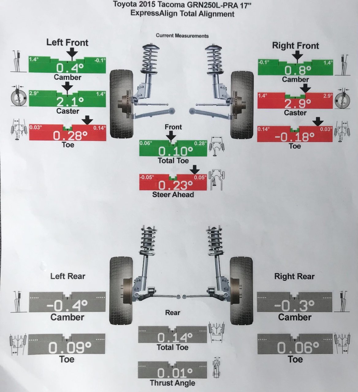

    Follow-up on my alignment from about a month ago. It turns out that my request to have around 2.5-3 degrees of caster, about the same between both wheels, was ignored by Bert's Alignment (the aforementioned "highly-recommended" alignment shop). The following measurements were taken by Firestone on 17OCT, about 3 days after the initial alignment was done:
    For the $110 I paid Bert's to get this alignment done, I expected better.
    I scheduled a followup appointment so the tech at Bert's could get the numbers where I specified. The tech was dismissive, snotty, and generally unpleasant during my followup. Since this shop doesn't have a computer, the tech wrote down the following numbers off the top of his head and told me "not to believe Firestone's computer":
    Yeah, nice try dude, but I'm getting verification. Firestone's reading, taken the next day:
    Not exactly what I was going for, but not awful either. Firestone tweaked the toe and gave me my final results:

    Ouch, I probably should run through Firestone for a print off of what I'm at after doing a custom alignment at a shop in Chester area of RVA.
    I tell you what, that lifetime alignment has already paid for itself!

    Yeah, seriously. I’ve had like 6 alignments/checkups at Firestone since I got the lifetime deal 3 months ago. That isn’t counting the 2 alignments I got at the dealership (part of the LCA replacement debacle) and 2 at Bert’s.

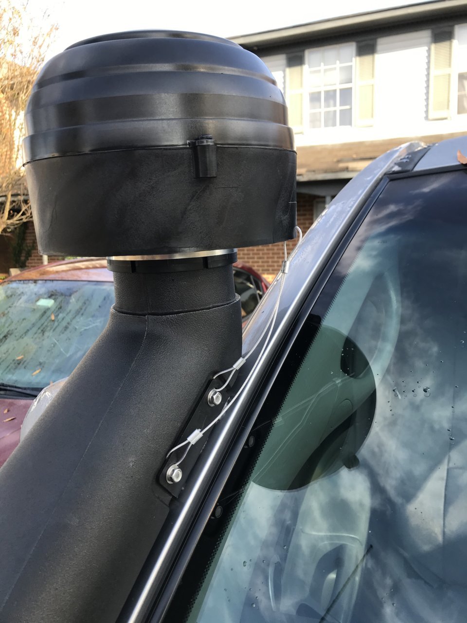

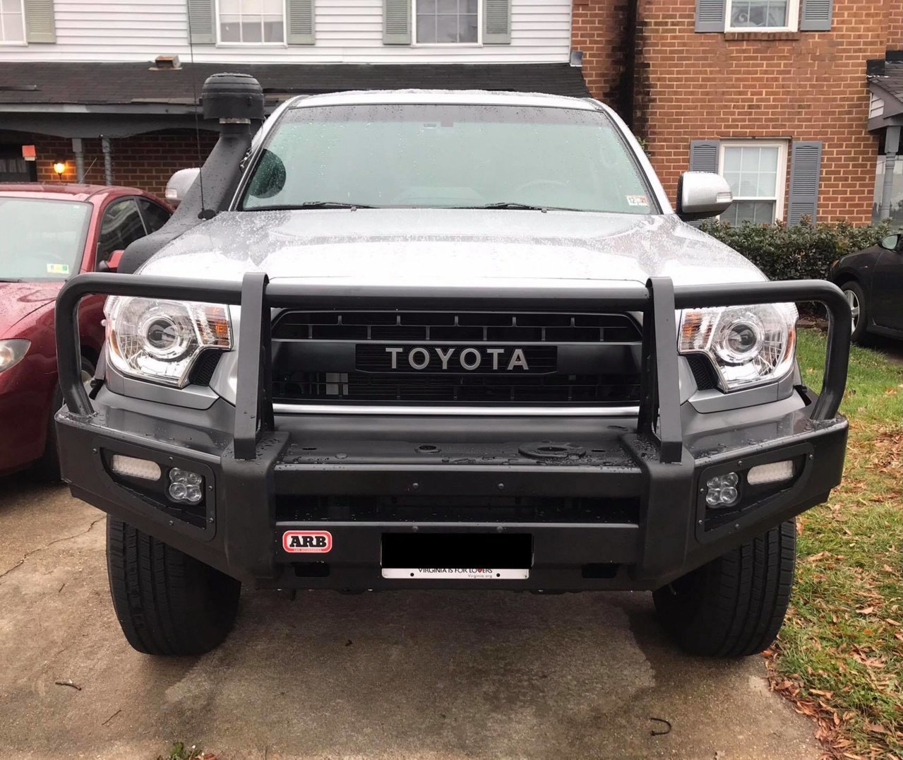

    On Monday 02 November, my original Sy-Klone 9001 prefilter decided that we should part ways. Unbeknownst to me, it made its exit somewhere on my 17 mile commute in the wee hours of the morning. I blame lack of caffeine and the time (about 0415-ish) for my not identifying the moment of departure. Suffice to say, I pulled up in my office parking lot wondering when and how my snorkel got decapitated.
    I installed the stock ARB ram air head, which I keep on-board for just this sort of occasion, in the parking lot. After posting up in my local Toyota facebook group, it became clear that spotting a relatively small and plain-looking part on the side of the road by a passerby was highly unlikely. Looks like I had to get another $200 prefilter.
    I contacted Sy-Klone directly, asking if the sudden onset of cooler weather may have affected the material properties of the prefilter (contraction, change in coefficient of friction, etc.). I didn't intend to pin the blame on them; I was genuinely curious as to how such an odd thing happened. They confirmed my suspicion that changes in weather do not have any appreciable effect on the material used.
    I then asked if they had any sort of "dammit I wish this didn't happen" discount. After a bit of hemming and hawing by their sales department, I was told that they couldn't do anything for me. Disappointing, but not surprising. They advised that I reach out to the retailer (Thermo King of Roanoke, VA) to see if they could help me out.
    Thermo King was a bit miffed that I got blown off by the manufacturer, so they offered to sell me a new prefilter at cost. I've gotta give it to these guys, they stepped up and helped me out entirely of their own accord, offering a 25% discount to ease the financial sting.
    I received the new prefilter yesterday and installed it today, with a couple extra security measures to ensure this situation never happens again. I bought a 1/16" stainless steel lanyard kit (P/N 97840A860) from McMaster Carr, which I used to lanyard the prefilter to hard points on the truck. This thing isn't coming off unless 2 of the compression sleeves AND the mounting hose clamp fail. Two is one, one is none, three is fun, rework can go f**k itself.

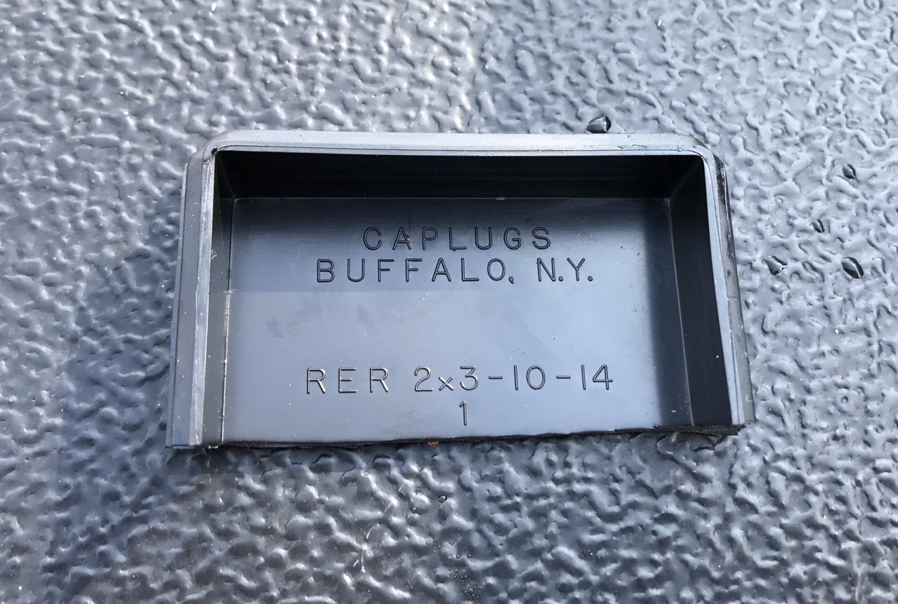

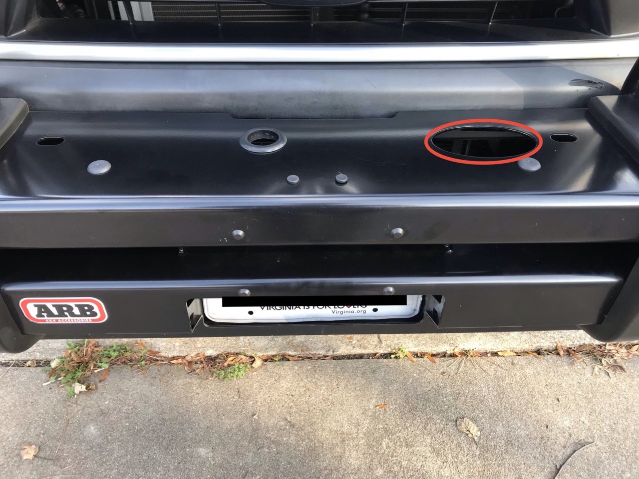

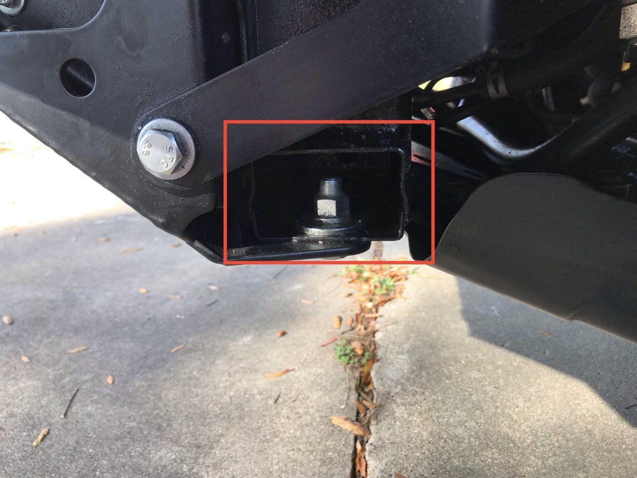

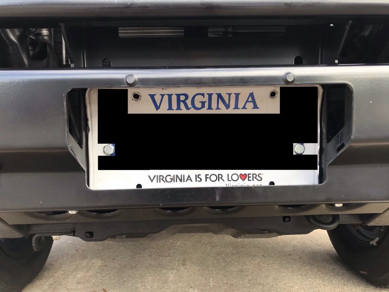

    Who buys just one thing from McMaster? Not me. I bought some plugs to fill in some unused holes on my ARB bumper. This isn't a vital task by any means, but I like protecting edges where I can.
    License plate bracket holes, qty 4: P/N 9750K41 (somewhat loose fit, but seem to be staying in place)
    Winch control box bracket holes, qty 2: P/N 9283K17 (very tight fit, needed a rubber mallet to seat)
    Auxiliary light mounting holes, qty 2: P/N 9750K88 (perfect fit, can be used to route cables if needed)
    Oval cutout for cable pass-thru, qty 1: P/N 9600K155 (outlined in red, part still en route)
    I figured I may as well try to plug the open holes in the front of the frame while I was at it. I ordered a 10 pack of rectangular plugs (P/N 9474K56), which are just slightly too large for the intended holes. I trimmed off the bottom edge:
    Which leaves a plug that is almost exactly the right size, and snaps into place fairly securely:
    As you can see, I also relocated my front license plate into the winch fairlead recess on the front of the bumper. It took a bit of bending to get it into the "pocket," but the plate perfectly fills the area. I did have to drill 2 new mounting holes in the plate itself, which may not be legal in your state. Or my state, for that matter.

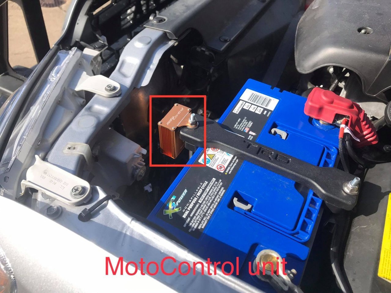

    Aftermarket headlights: The Phillips LED headlight bulbs I have installed are technically not legal. The RX350 HID retrofit headlights I have on the way are equally non-compliant.
    Side marker lights: These lights must be amber in color. While my stock side marker lights are legal, the ARB combination turn signal/clearance LED lights mounted on my bumper are not. The turn signal is amber, but the clearance (same thing as "side marker") lights are white.

    Front license plate: The way I have this mounted is legal, which came as a bit of a surprise. I thought the restricted viewability from the sides and top wouldn't be compliant, but the inspector's handbook is silent on the topic.

    Installing the wiring harness would've been a 10 minute job if I wasn't so picky about wire routing. This video helped quite a bit:
    https://youtu.be/RXugwDxO19s
    I would've liked to install the Motocontrol box in a less visible place, but there aren't many mounting bolts available.

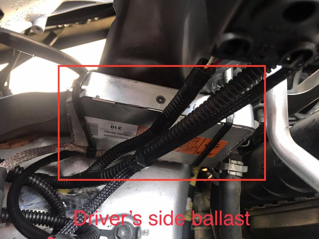

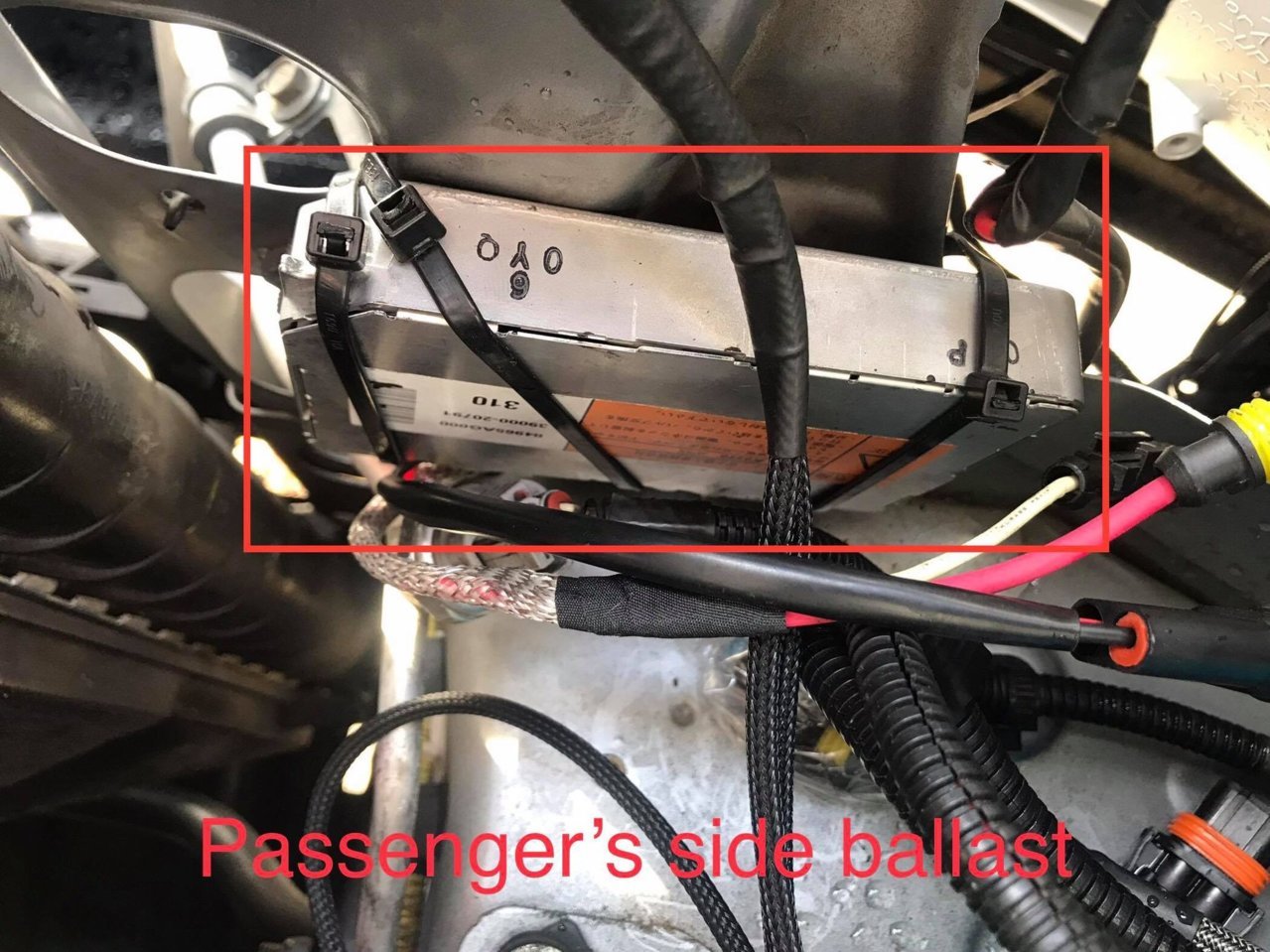

    Picking a spot for the Denso ballasts proved to be a pain in the ass. I wanted to mount them with the connections facing downwards to minimize the risk of water intrusion. I opted to have the ballasts "potted" (waterproofed) since they're exposed in the engine bay, but every little bit helps. I found a small spot just inboard of and below each headlight, which barely fit the ballasts. The judicious application of zip ties (3 each) should keep them firmly in place:
    134939878_120958046455371_8597397200293898843_n.jpg134993394_313949416591001_584223027953473639_n.jpg

    ... using an 8mm socket and my newly-acquired offset screwdriver, following @boogie3478's video:
