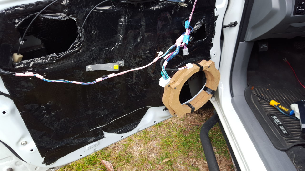

    20180319_142936.jpg had to make 2 adapters for that 8 to clear the window.

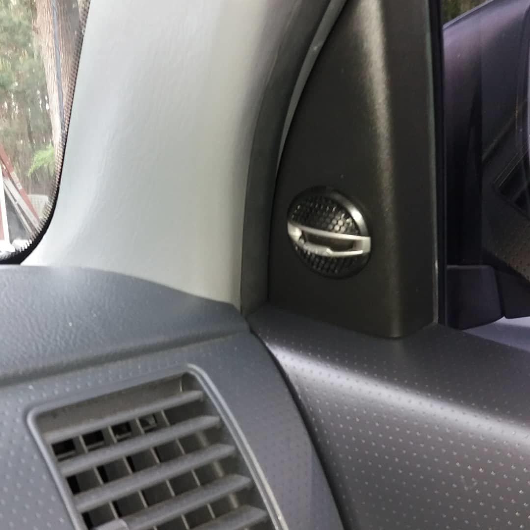

    Buddy those are gonna be really bright. Have you played them yet ?

    Yes..they sound great...I love highs...I'm going with the JL Audio twk 88 next....I'l get the brightness out...Lol. but yes they sound good just need tuning.

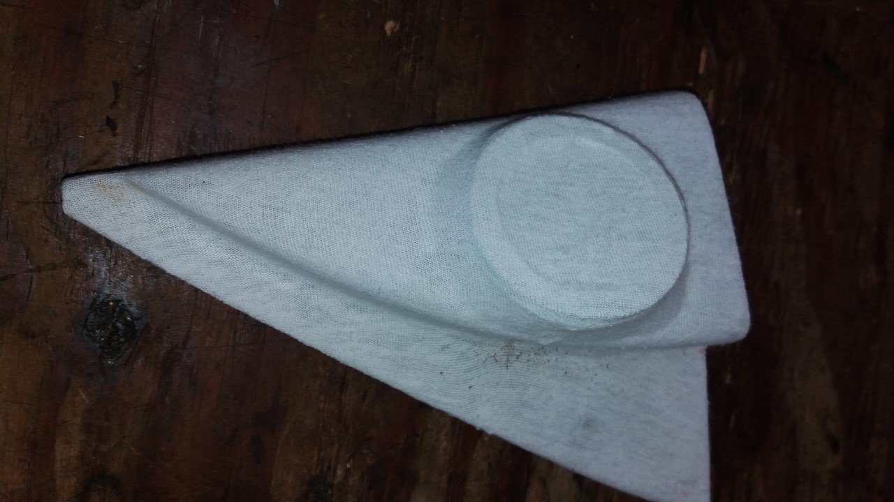

    Just messing around with Fiber Glass,First time i tried it.

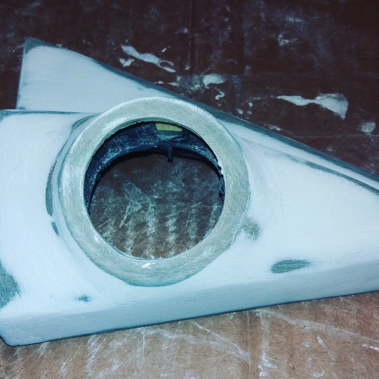

    Bondo and sanding today.

    Glaze then more sanding.

    I've never seen a first try go this well. Nicely done!

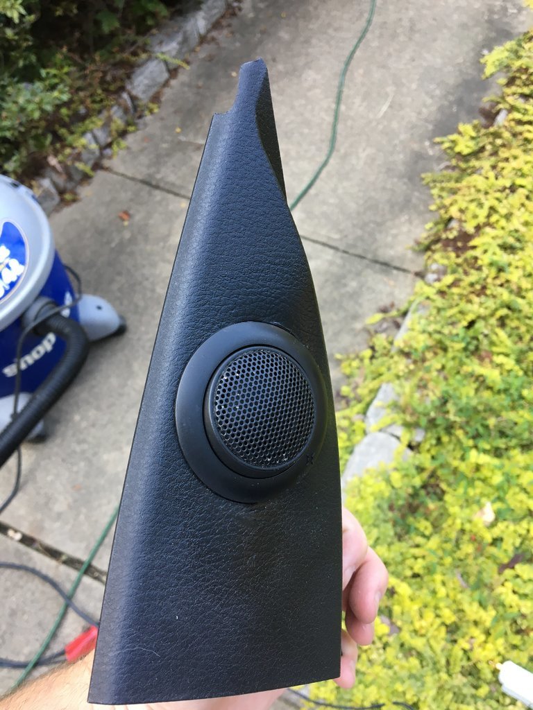

    Its a super easy location to place tweets. I put Hybrid Audio Technologies tweets in mine. You can heat up the sail panel with a heat gun and push pull the plastic so it is flush mounted. Hot glue and your done. Here's what I did:
