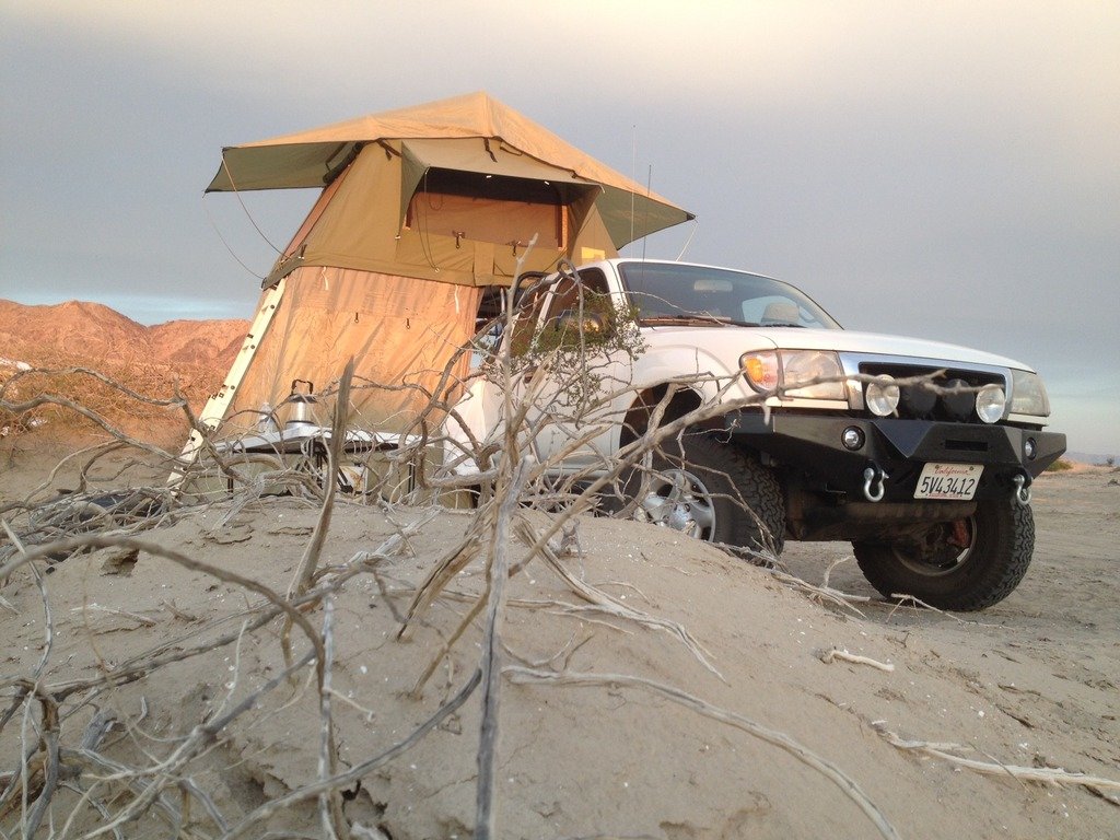

    I did it... 6 years ago. Still have the truck, drive it daily, 222,000 miles - 50,000 since the conversion. Total cost (w/ re-gear x2, ARB locker x1) came in about $2,500. It took me 6 months to convert. Drove it during the week, wrenched on it during the weekend in my 2-car garage. Sourced used parts from across the country - Thanks Internet!
    Still a great truck, completely reliable - I keep up on scheduled maintenance
    I'd do it again in a heartbeat... Great experience.
    I'd caution those with the 2.7 (which I have). There will be more 'customization' required than if you had the 3.4. The 2.7L 'pushes' the drivetrain 2.5" further aft than the 3.4 block. This requires custom-length driveshafts and modifications to the transfer case shift lever.
    IMG_0346_zpsperdwvym_b18130ed6e93931f722c068f046d1a2f32756fd4.jpg Taco Dell had a hand in the build - back when we were young men
