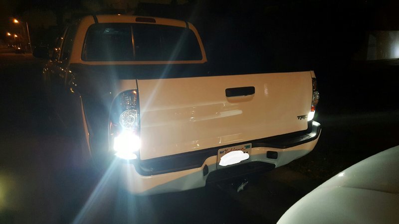

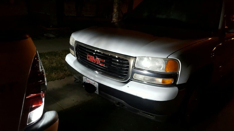

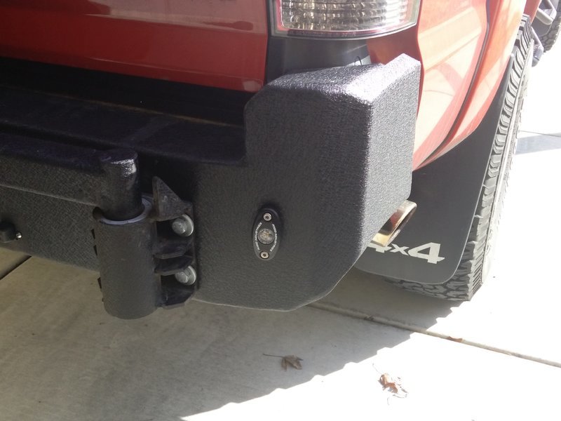

    Do you have any shots of the light those kick out at night? I mean looking out from your truck.

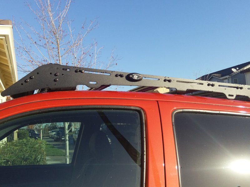

    Here are a couple.

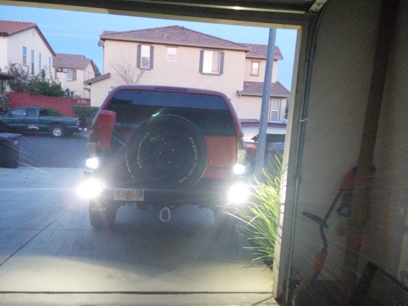

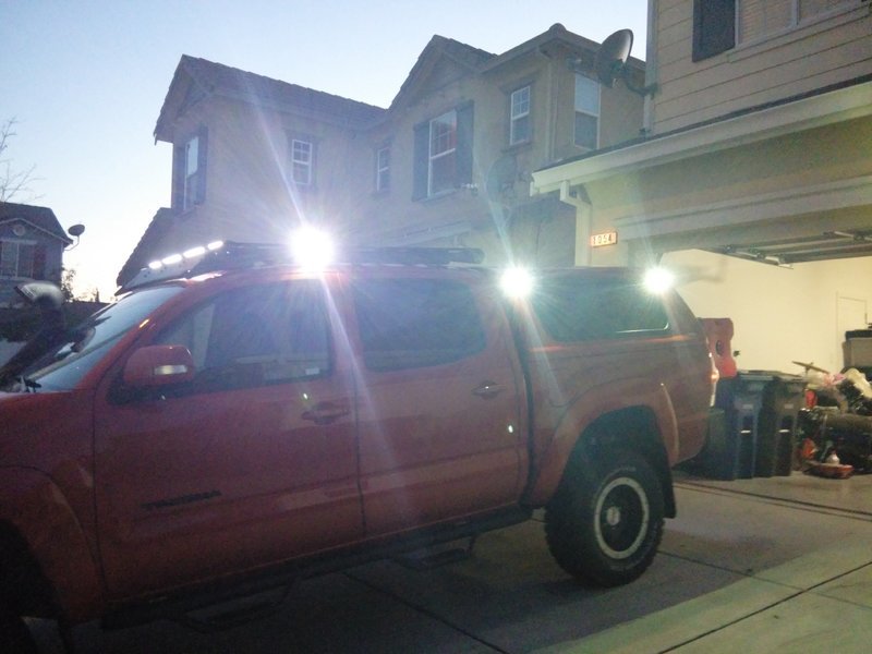

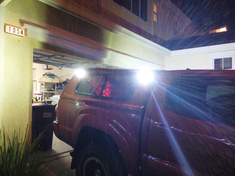

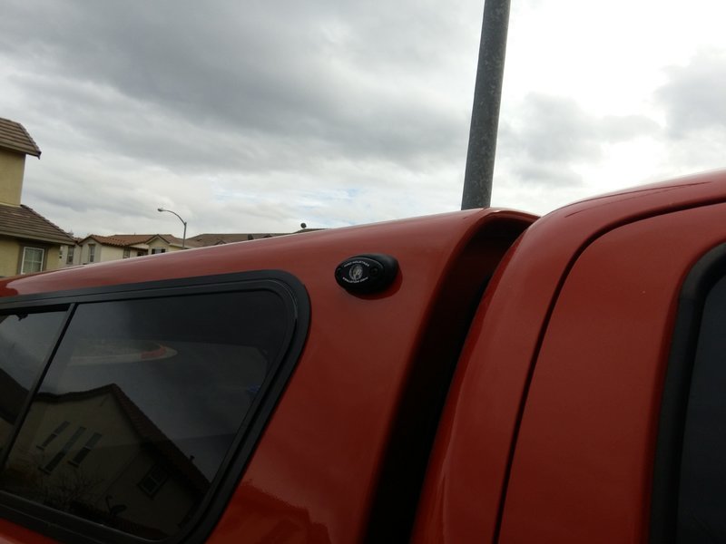

    Can you get a picture of the side camper shell lights off?Want to see how it looks.

    Here you go. They don't stick out all that far.

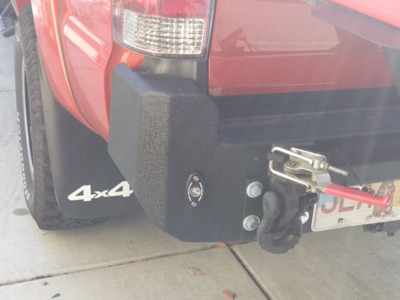

    I got them off Amazon. A Series Rigid Natural White High Output. I think they run about $160 for a pair and then about $30-$40 for the 30 degree mounts. But the are great lights and have good output.
