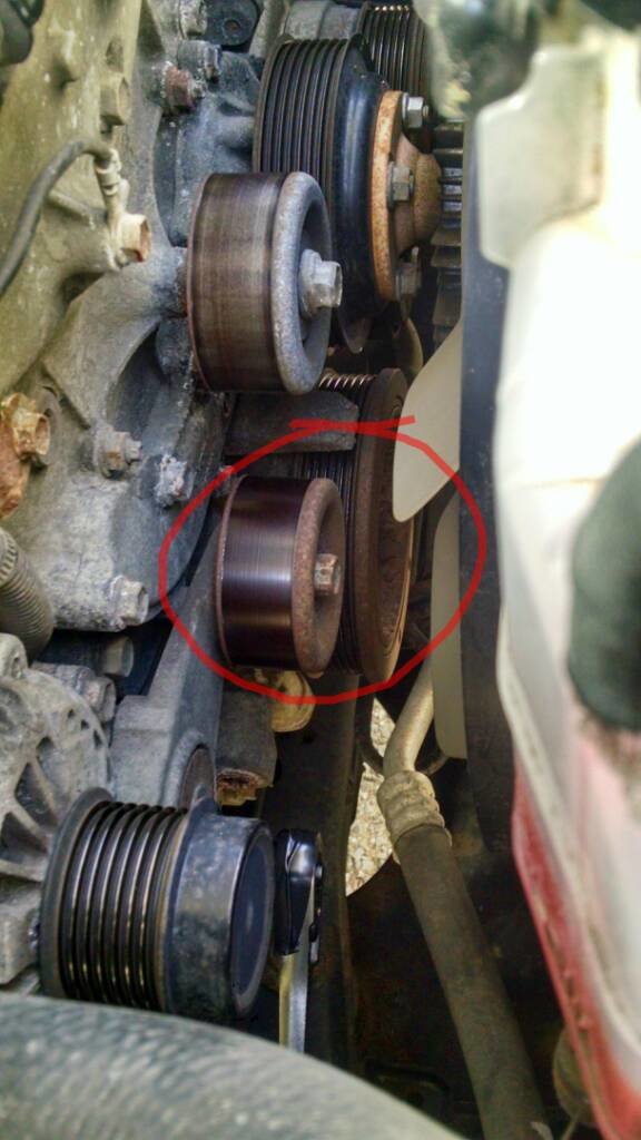

    Question about pulleys:
    I'm changing the belt today and noticed one pulley is loose and grinds when moved with my hand. This is obviously the source of the squeek I have had for 50k. Can someone confirm that this is an idler pulley and not a tensioner pulley? Want to make sure I buy the right one. Thanks!114f90deb36c69107ffadc96f7a42461_86ce63ee75dedc1d93dd0c4691642bd1f64e9ccd.jpg

    That's is the tensioner pully.
