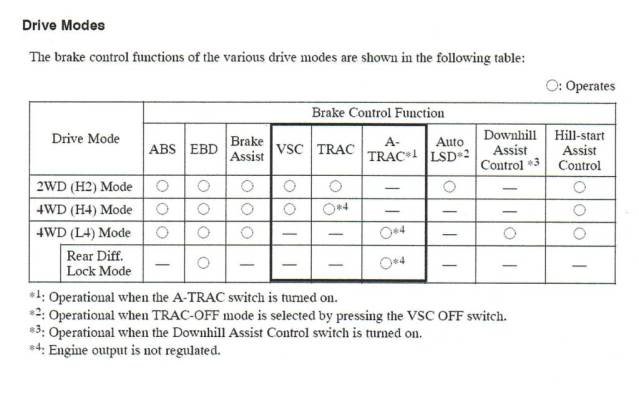

    Random Bob, TRAC is on in H2 and H4, and there is no engine output regulation in H4 with TRAC. Look again at my sig. and see that I never said A-TRAC on with H4... Only TRAC on... A-TRAC is on in L4 only.
    Here is the tech page that shows you what mode TRAC and A-TRAC are in and when engine output is regulated.
    Here is one that explains the switch operation for TRAC OFF (AUTO LSD) and VSC OFF (Open Differential) in H2 and VSC OFF in H4:
    Re read my 9 modes, I think I got the data right... but I appreciate feed back to make it better! See my post in the Tech forum where all this and more ways iof explaining the modes is.
    Thanks!

    Bob, trust me on this... I had an '01 and an '05 before my 2010... all three were Off Road TRDs (4WD)... The 2010 in 4H is way different than the 2005 or 2001 in H4... It has TRAC (LSD) on normally. The difference in deep sand is like night and day! I went into great detail elsewhere on this forum.. do a search of posts by me to find it. To turn off TRAC in H4 you need to stop moving, and then press the VSC Off switch for 3-5 seconds (car with wavey lines below it). VSC and TRAC will both turn off and THEN you will have open differentials.
    VSC uses TRAC to achieve stability (along with the other things it does)... It isn't the LSD, TRAC is. Now in L4, A-TRAC is different, stronger TRAC (LSD)... Just like in H2 there is AUTO LSD, a stronger LSD than standard TRAC in 2WD.
    Please review the chart I posted above called 'DRIVE MODES', that chart is for 2009 and 2010 OR TRDs, like yours. The Toyota written manuals are terrible, and I don't care for the names they have given to these systems, but that's what we got to work with!
    H2 you have TRAC (with engine regulation) /or AUTO LSD /or Open Differntial modes.
    H4 you have TRAC (without engine regulation) /or Open Differentials modes.
    L4 you have OPEN DIFFERENTIALS /or A-TRAC to 30 mph/ or Rear Locker/ or Rear Locker with A-TRAC to 3-5 mph.

    ^this
    A-Trac in itself is essentially (Trac ) + (A-Trac in 4L). Believe it or not. BTW A-Trac stands for Active TRAC / The name itself even applies that you have trac.
    Its night and day obvious, I dont know what your experience is you say that you tested, but have to question it. You seriously cant miss the fact that you have Trac funcitoning. You can see it, hear it, and feel it.
    Watch the dash for the slip indicator light. That light is shared with VSC, but when VSC is activating it it makes audible beeping noise. If its flashing with no beeping and your not sliding...its cause TRAC. You can actually hear the relay's clicking when trac is working. And you can feel the obvious difference when its working. Turn it off and you will see.
    VSC is not trac at all, nor is it some type of replacement as you have suggested. VSC is about vehicle stability. It uses steering angle sensor, yaw rate sensor and a G-force sensor. It has nothing to do with a wheel spinning (except with ABS and not spinning at all), it has to do with the truck sliding. Its not really a traction aid per say, its more of a stability and anti-sliding aid.
    Believing what your window sticker says versus the factory tech service manual is your mistake.
