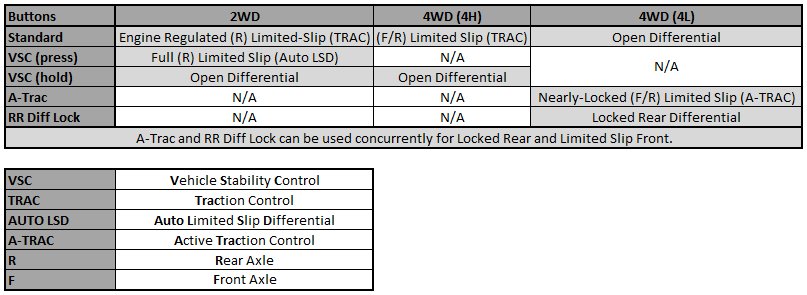

    I asked anyone who replies to watch the video! The Tundra just spins the tires on rollers in normal 4WD or even with the rear locked... Then the driver pushes the A-TRAC button... Please watch the video. But, the answer is:
    Yes, you can select to be in any one of NINE drive or traction modes with the 4WD OFF ROAD ('09 +). Normal L4 is open differentials. Press the A-TRAC button and it will now come on any time you go into L4, automatically. Or you can press the button again to go back to open differentials.
    The 'normal' mode listed below is the one you will be in without trouching any buttons in H2, H4 and L4.
    In 2WD (3 modes):
    *Normal Mode (TRAC & VSC) There IS engine output regulation in H2 TRAC.
    *TRAC OFF Mode (AUTO LSD) There is NO engine output regulation.
    *VSC OFF Mode (TRAC & VSC are both off) Open Differential.
    In 4WD High Range (2 modes):
    *Normal Mode (TRAC & VSC) There is NO engine output regulation in H4 TRAC.
    *VSC OFF Mode (TRAC & VSC are both off) Open Differentials.
    In 4WD Low Range (4 modes):
    *Normal Mode is VSC and TRAC both off (Open Differentials).
    *Rear Differential Locked (max. 5 mph recommended)
    *Active Traction Control (A-TRAC)
    *Rear Differential Locked + A-TRAC (up to 3 mph).

    BGrutter made this, on my other thread explaining the traction modes, to help show them:
