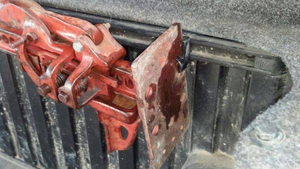

    This makes me wonder about my hi-lift being mounted to the bed rails... I was thinking of fabbing up a tire mount for the bedrail. Wont be doing that now.

    You should be fine. I have my 60" Hi-Lift mounted to the rails with no issues. The 60" Hi-Lift only weighs about 30lbs, whereas a full-sized spare (31"-33") is closer to 60-70lbs. Plus, the Hi-Lift's weight distribution is spread more evenly across the length of the rail itself.
    Not sure how you mounted yours, but here's the link to my mounts I used.
    http://www.tacomaworld.com/forum/2nd-gen-tacomas/260147-diy-hi-lift-tool-mounts.html
    They are pretty damn solid, and I have been on some rowdy trails without any rattling, movement, shifting, loosening etc.

    I used an old locrac that I've had in my shop for a few years that my dad bought me for my '89 toy when I had it. I just bolted it to t slot nuts in the rail. I should probably redo it so that all the weight isnt resting on the rails. I just have pics of it mounted up.

    That looks ok, I wonder if it would work with my shell. Since I have a short bed, bedspace is precious. I need stuff like this to take up as little space as possible. Here's another shot of the base mount.

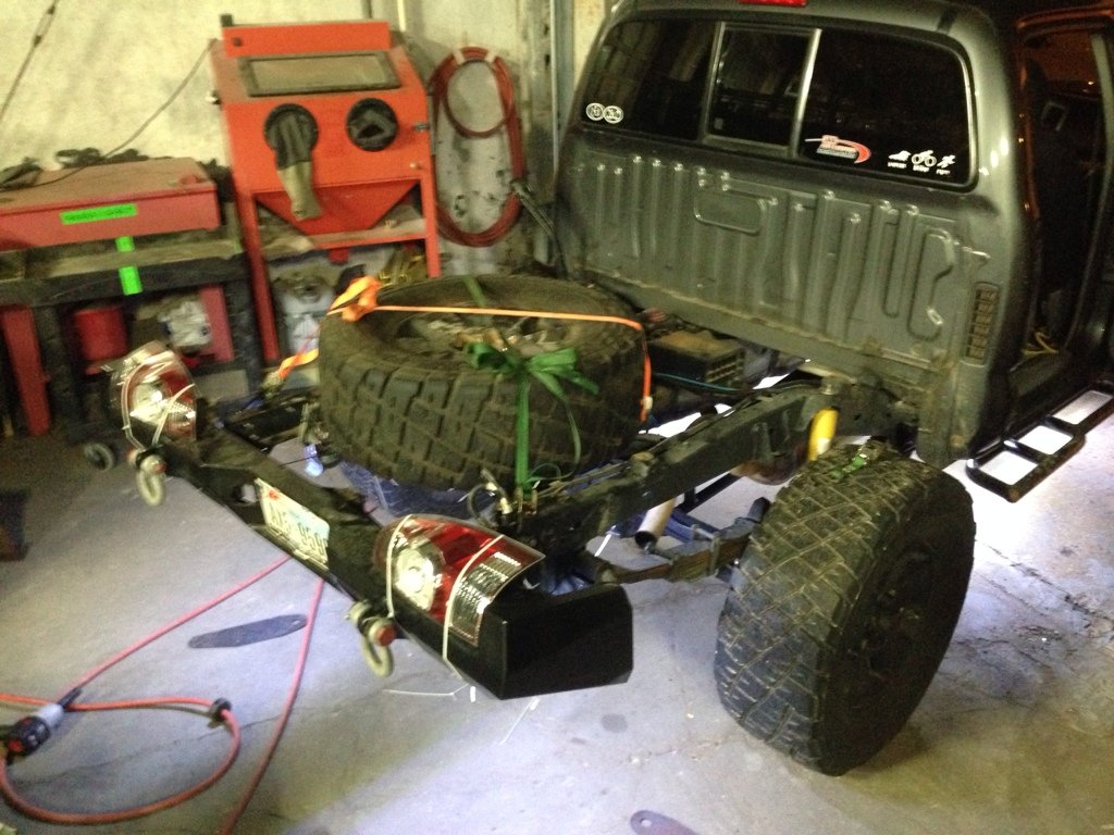

    That sucks. Thanks for the heads up. I seen a few LT guys in my town selling their bedside on CL or maybe its time LT yourself.

    It's been over a year since. I didn't think the dealer would warranty it.

    Your tail lights: 13 points
    They scored a "10" on the redneck scale, with a bonus point of +3 for the white zipties .
    :D

    I actually build a spare tire carrier that bolted to the OUTSIDE of the bed for a old dodge stepside pickup, with the cutout in the left rear fender for the spare. I used 20lbs of pipe, plate, bolts, spacers and such and it ten years it still looks fine. So, I wouldn't blame the BED, I would blame the spare tire mount. I also have my high lift jack bolted to my bed rails, with the t-slots, in two places.
