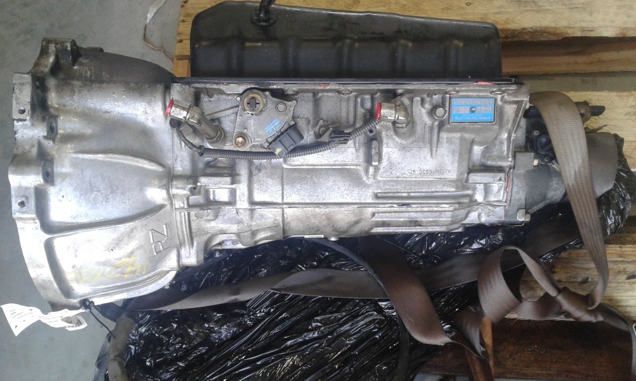

    If I'm not mistaken, we are looking at the drivers side of the new transmission. Do we know what year the donor vehicle was?

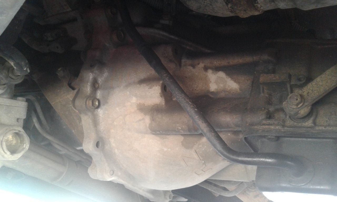

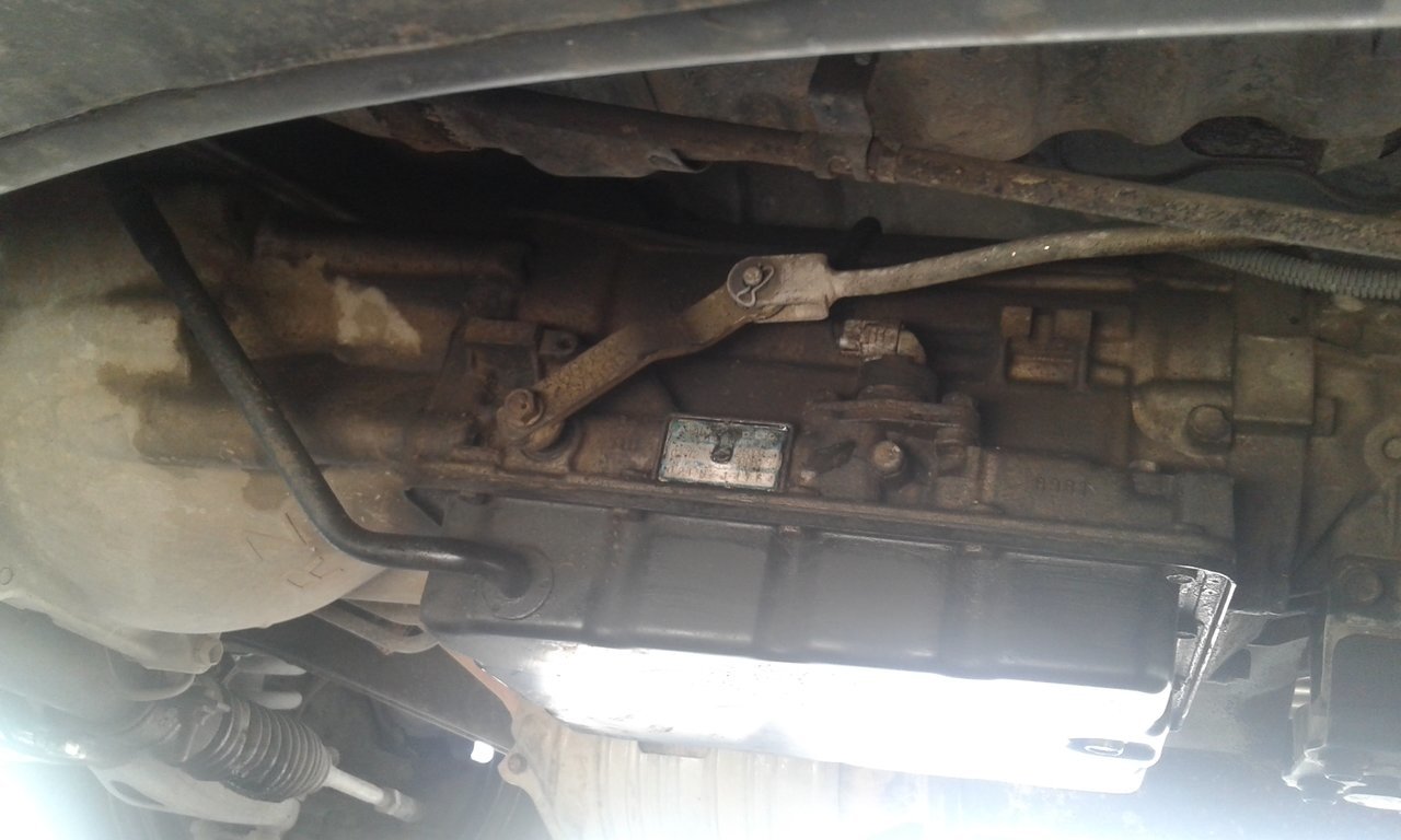

    Pic of mine on truck

    Other side of new..

    What does the casting mark on the bellhousing of the donor tranny say? The RZ stamped onto the tranny on your truck may indicate the 3RZ-FE engine, which you have. Just a guess.

    Another pic of current on truck

    Huh?? I have an A340E in my 1998, which is a fly-by-wire mechanical throttle.

    This is much more encouraging - there is that kick-down cable I was harping about
    These upside down pictures are screwing with me... ;)

    Im retracting my statment pending the kickdown cable on the image

    Yea sorry I don't see how to turn the pics around? I think this came out of a 02' tacoma ext cab 2.7.

    The kickdown cable is troublesome and was overlooked by myself. This may not be possible without serious modification to control the kickdown..
