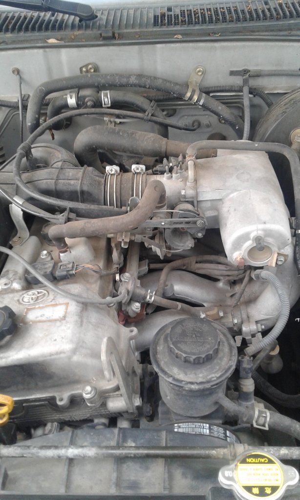

    @Austin_Mike can you take a picture of your throttle body please?

    Austin_Mike

    Austin_Mike

    Here you go

    So, that confirms you have a provision for a kickdown cable and no throttle by wire.
    Now, are there the same number of connectors on the new trans that are on the one in the truck?? What differs and where?
    Just trying some deductive reasoning at this point.
