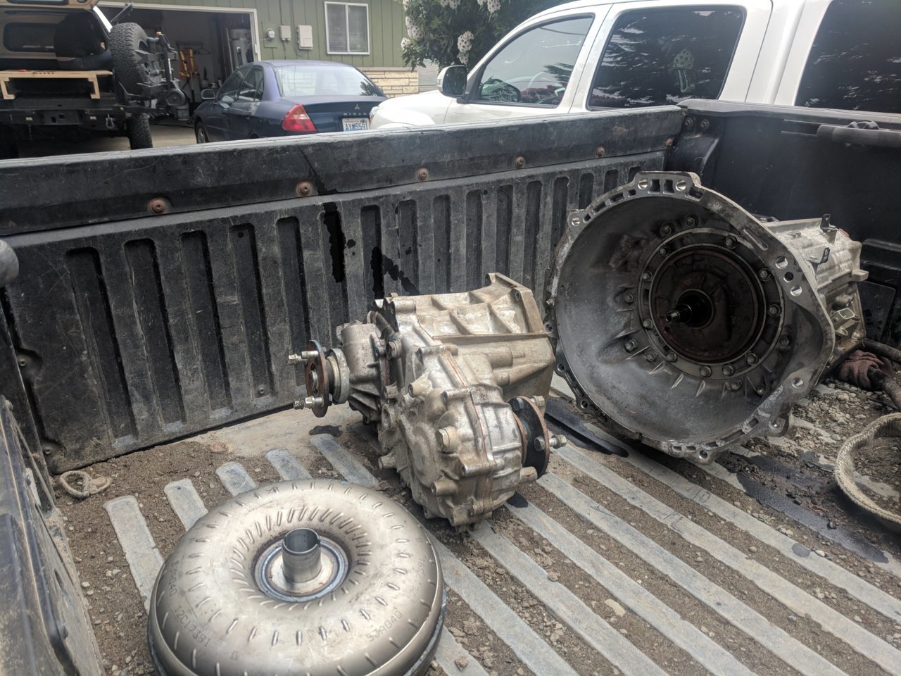

    Well here it is. 2012 t4r a750 w/80k. Got the tq converter, flex plate and tcase also. Time to get this thing on the bench and go through it.

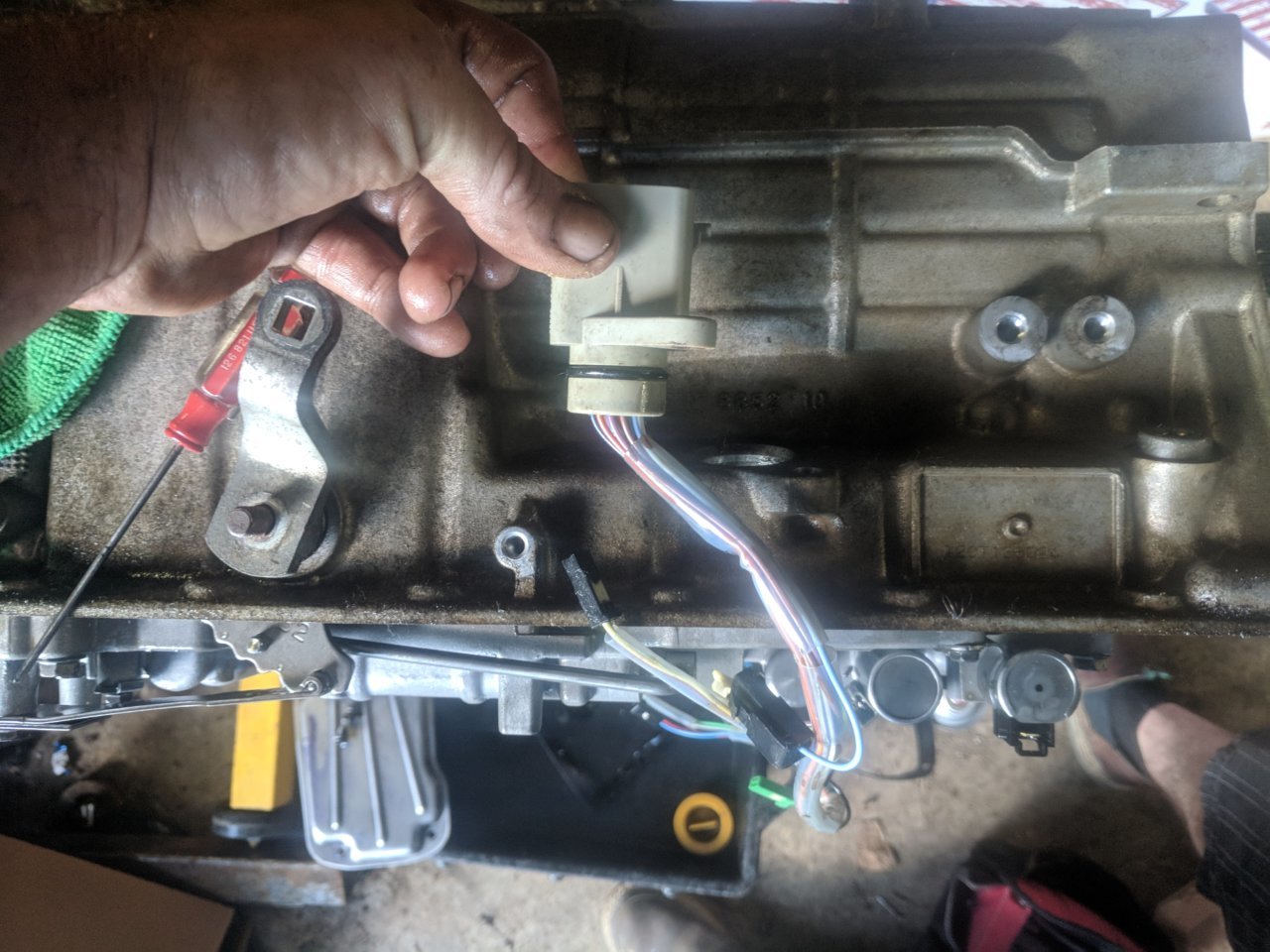

    Still in progress. I've been busy with work and kid stuff and my current transmission is still working for the time being. I haven't had much time to concentrate on this project lately. Still looking for the middle section of the trans that mates the tcase and trans together. Didn't realize it was missing till I did more research.
    I've got it on the stand and recieved the new replacement solenoid harness. That's about it.

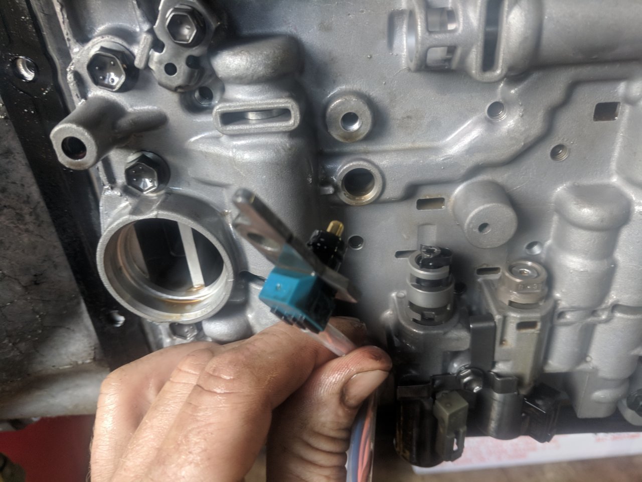

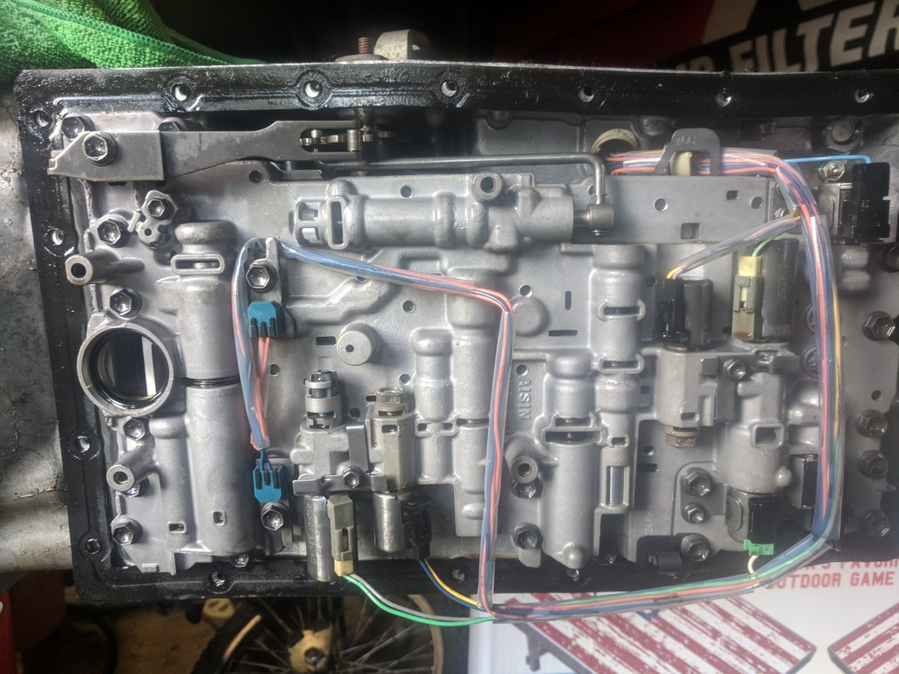

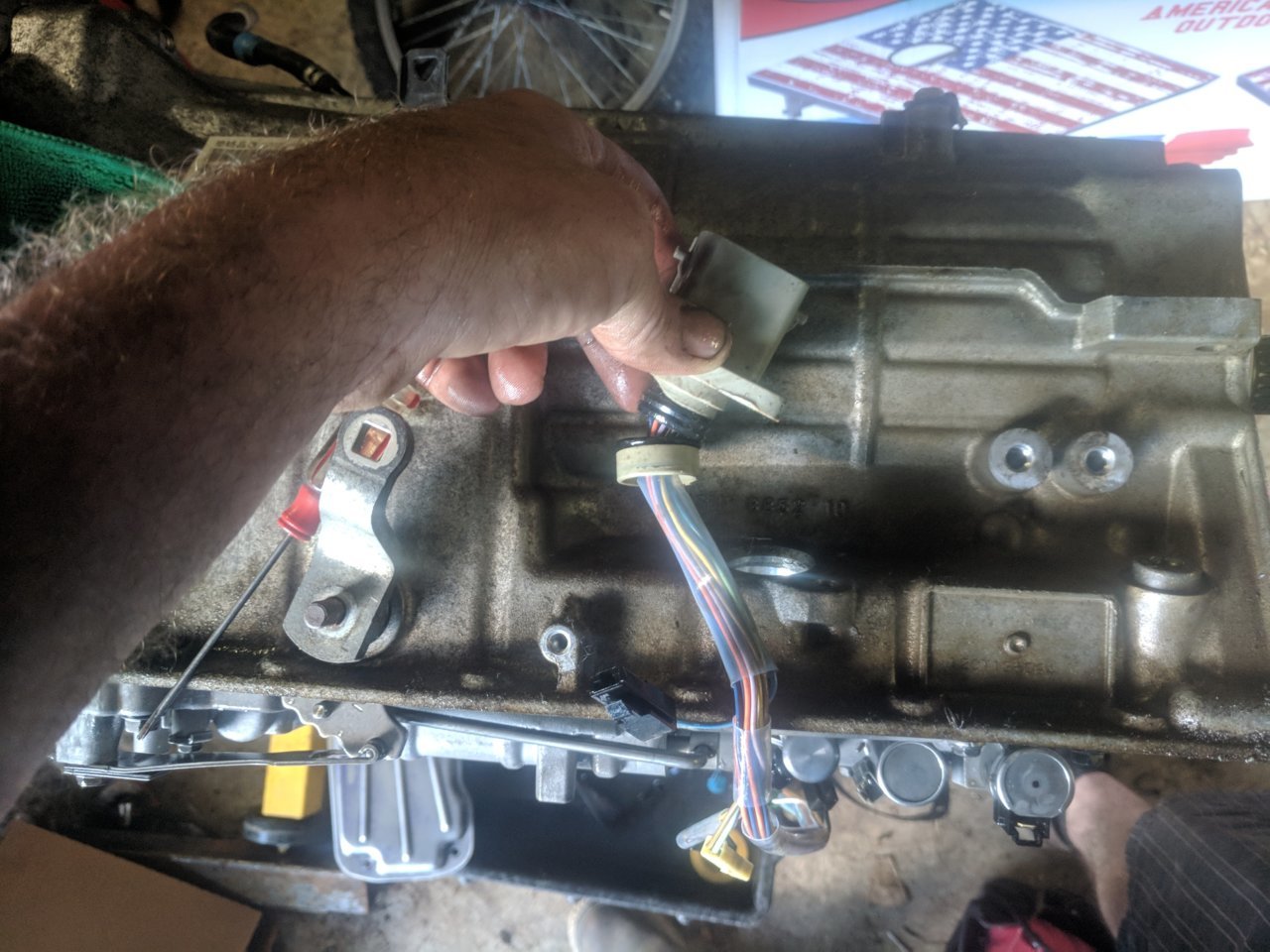

    Found some spare time tonight to swap the solenoid harness and replace the filter. Since it's on the stand now, I was able to rotate the transmission 180° and do this task head on, instead of on my head. No shift kit for now, just a basic filter/pan gasket job and replacing the broken harness. Sometime in the near future I'll get the twin stick kit and disassemble the tcase for that install.
    Attached are pics showing the filter removed and routing of the harness for removal/reinstallation. Using a small tipped flathead and gently depressing the retaining clips all solenoid plugs are removed. The last 2 (blue plugs) require unbolting of the 10mm keepers as shown. Pay attention to the orientation of the keepers as they will only fit one way. Install of harness and filter is opposite of removal, and also making sure the harness is free of pinching when reinstalling the filter. The last 2 pics show the broken collar on the main harness plug vs replacement harness.
