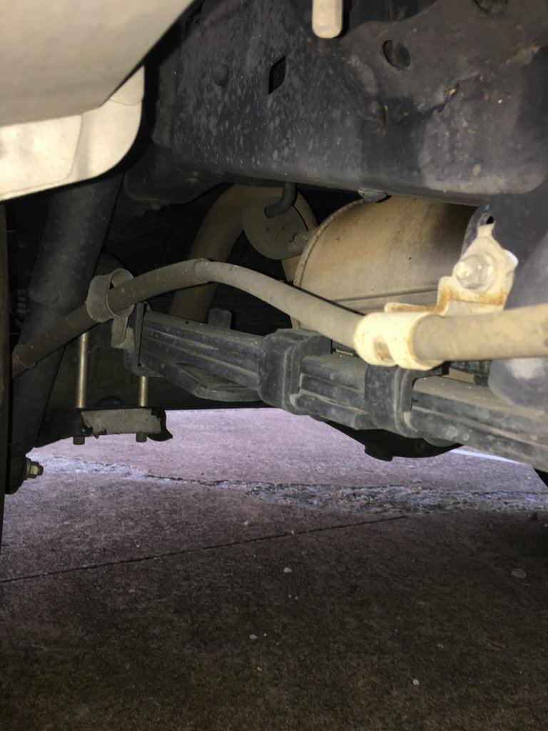

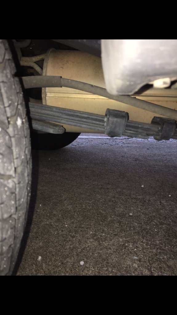

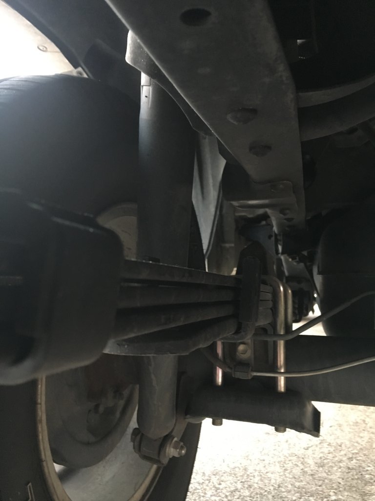

    Can you send pics? I am about 3 days away from placing order for AAL and had just posted a question as to whether the AAL would cause bad vibes or wear on the carrier bearing and u-joints and whether or not I should get shims? Here are pics of mine Recall replacement pack. Looks rather flat ever since and rides all loosey goosey .IMG_2433.jpgIMG_2441.jpgIMG_2439.jpg
