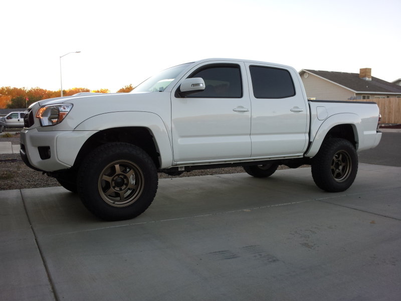

    I just got mine installed.
    1.5" Toytec AAL.
    Truck is a 2012 Sport with OEM 4 leaf pack, and Billies up front at 1.75" and 265/70/17's. Picture was taken 5 miles after install
    The whole install only took 90 minutes, and that was by myself, not too bad, thanks to these great directions!
