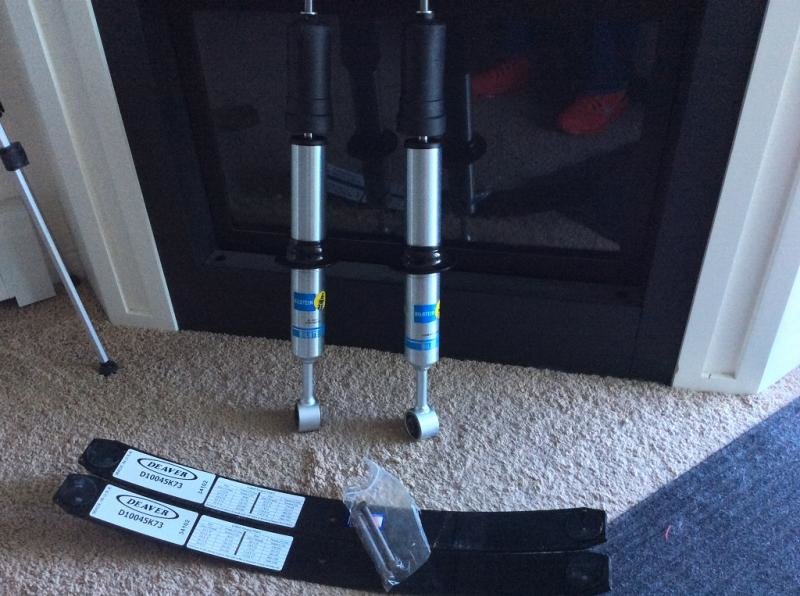

    Great thread. I couldn't have installed my aal and 5100s without it. Took about 3 hours to do it alone.
