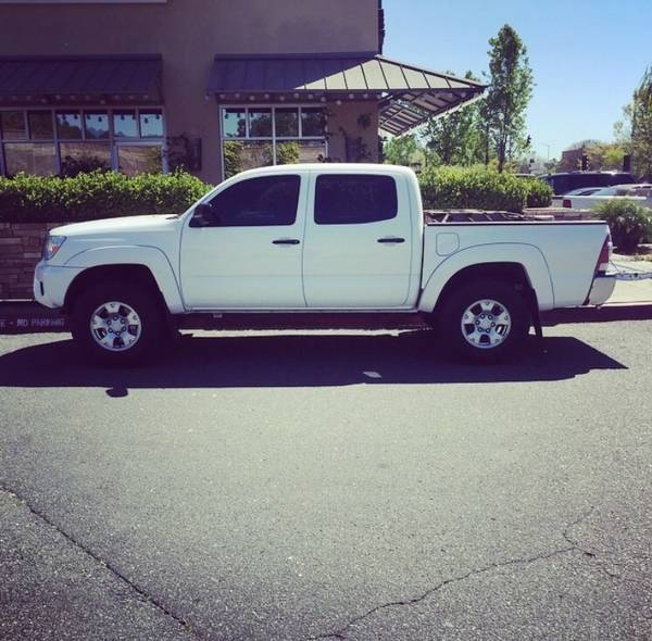

  9. Apr 5, 2015 at 4:58 PM
    #409
    WhiteTaco7
    WhiteTaco7 Member
    Mar 15, 2015
    #150962
    22
    PA
    15' White DCLB Sport
    Bilstein 5100's, OME 885's, 2" Toytec AAL (3 leaf), Bronze Level 8 MK6's w/ 32" MT's, Go Rhino Dominator II's, BPF TRD Skid Plate, AFE Pro Dry S, WeatherTech Mats.
    Finally got everything on, only thing is my Go Rhino's haven't come in yet, but everything else went on pretty smooth!
  10. Apr 5, 2015 at 5:07 PM
    #410
    SSG665
    SSG665 Well-Known Member
    Jul 24, 2011
    #60437
    781
    Georgia
    18 Tacoma
    That looks freakin awesome!!
  11. Apr 5, 2015 at 5:09 PM
    #411
    SSG665
    Jul 24, 2011
    #60437
    781
    Georgia
    18 Tacoma
    Are you clearing your front flaps?Any rubbing?
  12. Apr 5, 2015 at 5:46 PM
    #412
    WhiteTaco7
    WhiteTaco7 Member
    Mar 15, 2015
    #150962
    22
    PA
    I clear the mud flaps, but at almost full turns I do hit the little flaps that come off of the front bumper, nothing too bad though. I'll probably either trim them slightly or heat them up and bend em' a lil. Which ever is gonna look the cleanest.
