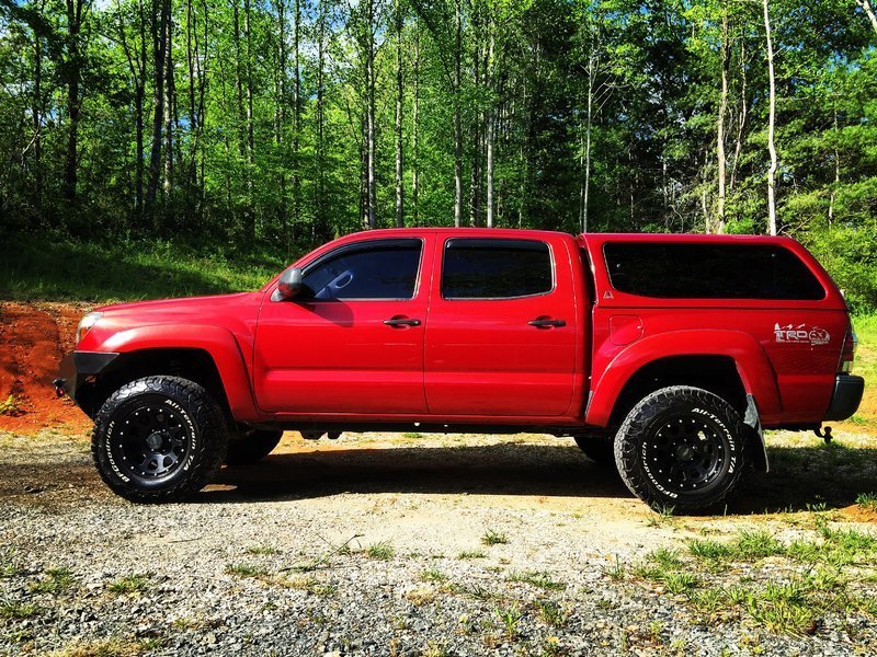

    Before 3 leaf pack installed
    After install, and this is the wheelers 3 leaf pack that they offer.
    ruffridha9, Lord Helmet and MTopp like this.
