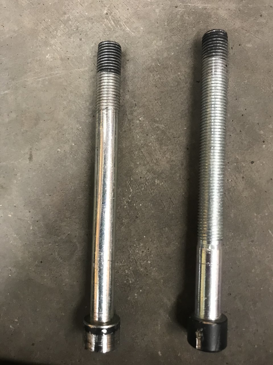

    Installing 3leaf AAL from Wheelers. Might have stripped last few threads of the centerpin bolt. But the threads don’t run down the entire bolt. That made it way to easy to strip last few threads. And if I wouldn’t have chosen to leave the overload spring in the centerpin bolt never would have worked to begin with. Now I’m stuck for the night. Hopefully I can find a new centerpin bolt tomorrow!
    Anyone else ever had this problem? Suggestions?
    Put the other leaf spring bolt with the full threads in easy breezy. No problems. Think Wheelers just messed up by packing wrong bolt.
    jafrisi likes this.

    Not Wheelers, but I had issues with theToytec pins as well. Not sure they were grade 8 or threads were tough enough or what, but the threads got jacked up waaay too easily. We used better ones From Ace and it made it much easier.
    KingFisher[QUOTED] likes this.

    Yeah. Thought about that but for peace of mind d I’ll just order new pin.

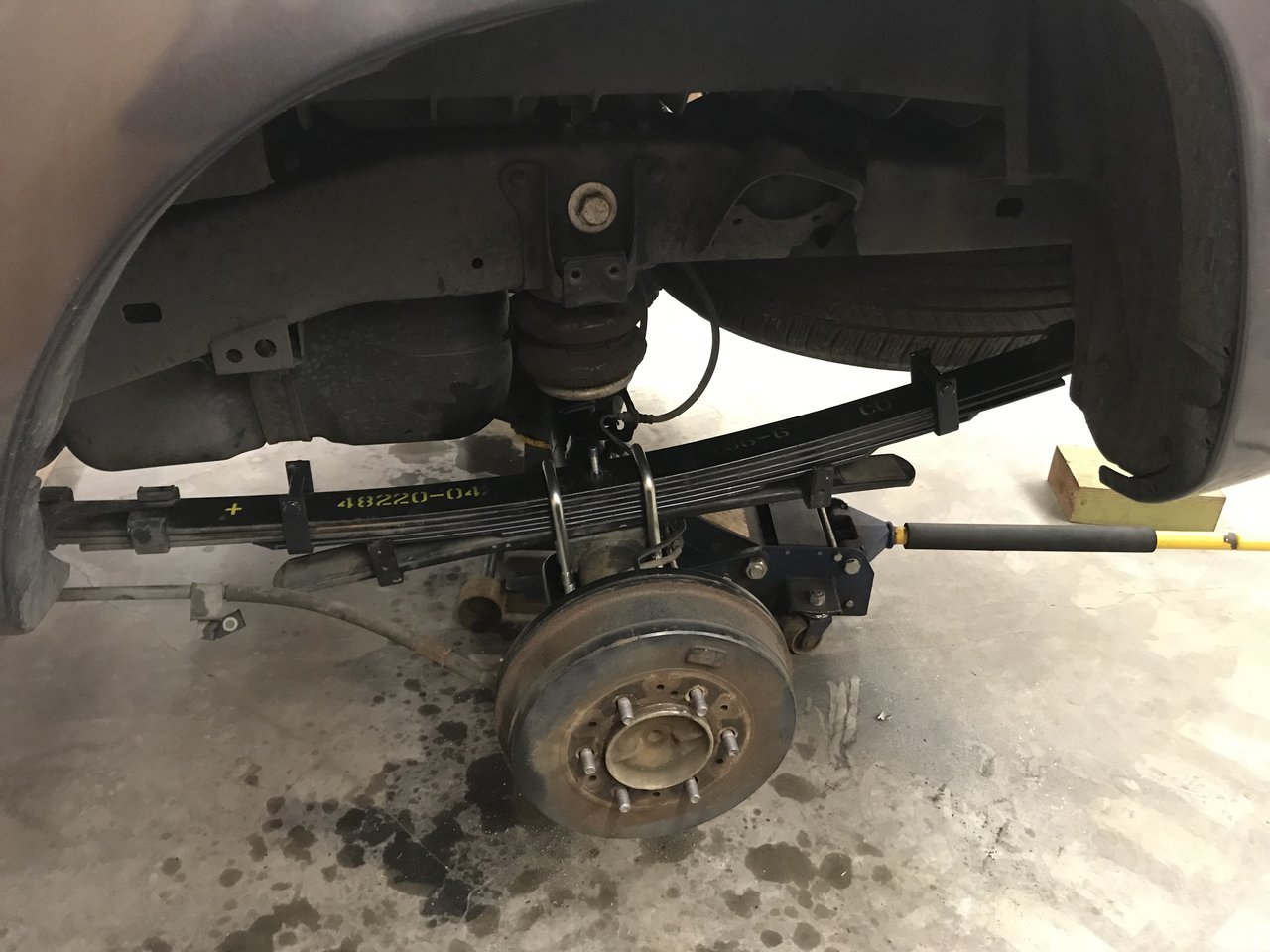

    Amazing how many years this post has been excellent information! Just received my Headstrong progressive 3 leaf AAL..struggling with leaving in the overload spring. I am installing 5100s all-around and OME888 coils up front which is about as much lift as I can buy with my budget...almost 3”. Should I leave the OL leaf in or not....I need a solid answer please. The ride quality plays second to lift and level on this question. I don’t have a shell or bumper....just want that day-2-day badass stance! Reagardless, it will take on the best of them.....thanks all!
  18. Apr 3, 2018 at 4:23 PM
    #578
    EatSleepTacos
    Mar 24, 2015
    #151688
    59,845
    Randy
    West Valley, AZ
    2017 4Runner
    I would leave it in. Its purpose is to keep the leafs from bending over backwards with a heavy load in the back, so it serves an important purpose
