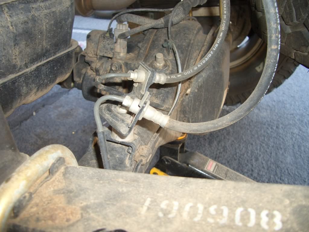

    Hi Chris,
    I noticed that you use a spacer in the brake line bracket. Is this necessary?
  9. Oct 3, 2009 at 7:25 PM
    #49
    chris4x4
    chris4x4 [OP] With sufficient thrust, pigs fly just fine. Moderator
    May 8, 2008
    #6497
    112,751,697
    FlimFlubberJAM
    Tenoe, AZ
    2019 Rubicon 4 Door,
    4.10 gears, sliders, and lots of buttons.
    No. Its not nessesary at all. It was already on Packerfans truck, so I left it. Its not hurting anything being in there.

    Thank Chris. I saw this one being used in a Tuff Country AAL install. It looks like it is used to maintain the play of the brake lines, so I installed one anyway.
    By the way, when do we need to use longer brake lines? When using longer shocks? Will it be necessary in 5100 rear?

    You really only need longer brake lines if your lifting more than 3"
