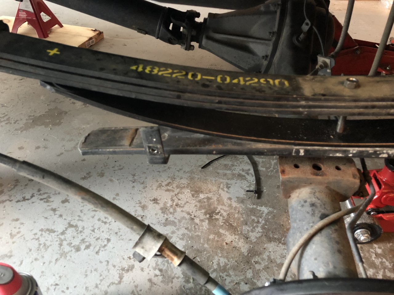

    2845A9D3-D454-4377-A7C3-438BDBDC2331.jpg What do y’all do about that bracket? In the OP it looks like those are longer to hold all leafs in place
  13. Jul 11, 2018 at 5:08 PM
    #593
    EatSleepTacos
    Mar 24, 2015
    #151688
    59,845
    Randy
    West Valley, AZ
    2017 4Runner
    No need to do anything about it. The centering pin holds all leafs in place.

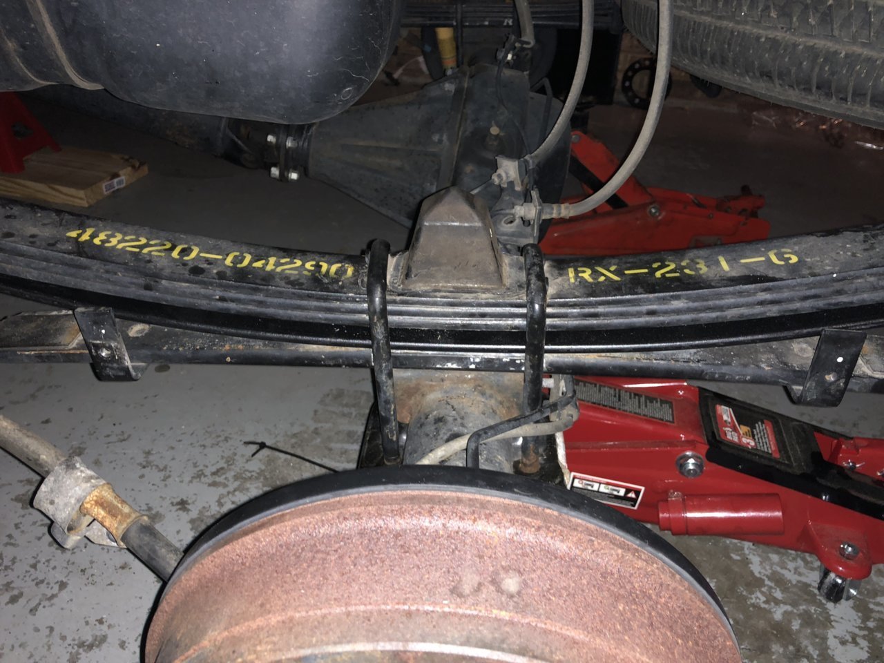

    Is the center pin supposed to be tightened to we’re all leaves are touching?
    Current state:
    OP:
  15. Jul 12, 2018 at 1:41 AM
    #595
    EatSleepTacos
    Mar 24, 2015
    #151688
    59,845
    Randy
    West Valley, AZ
    2017 4Runner
    Yes, center pin should be tightened to where all leaves are touching and snug together.
