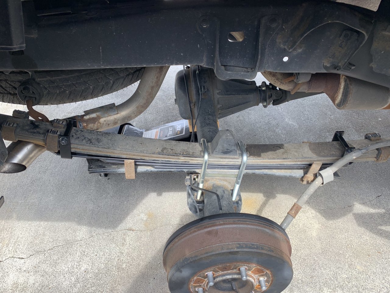

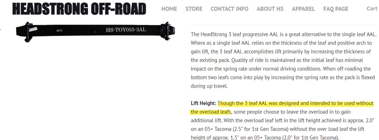

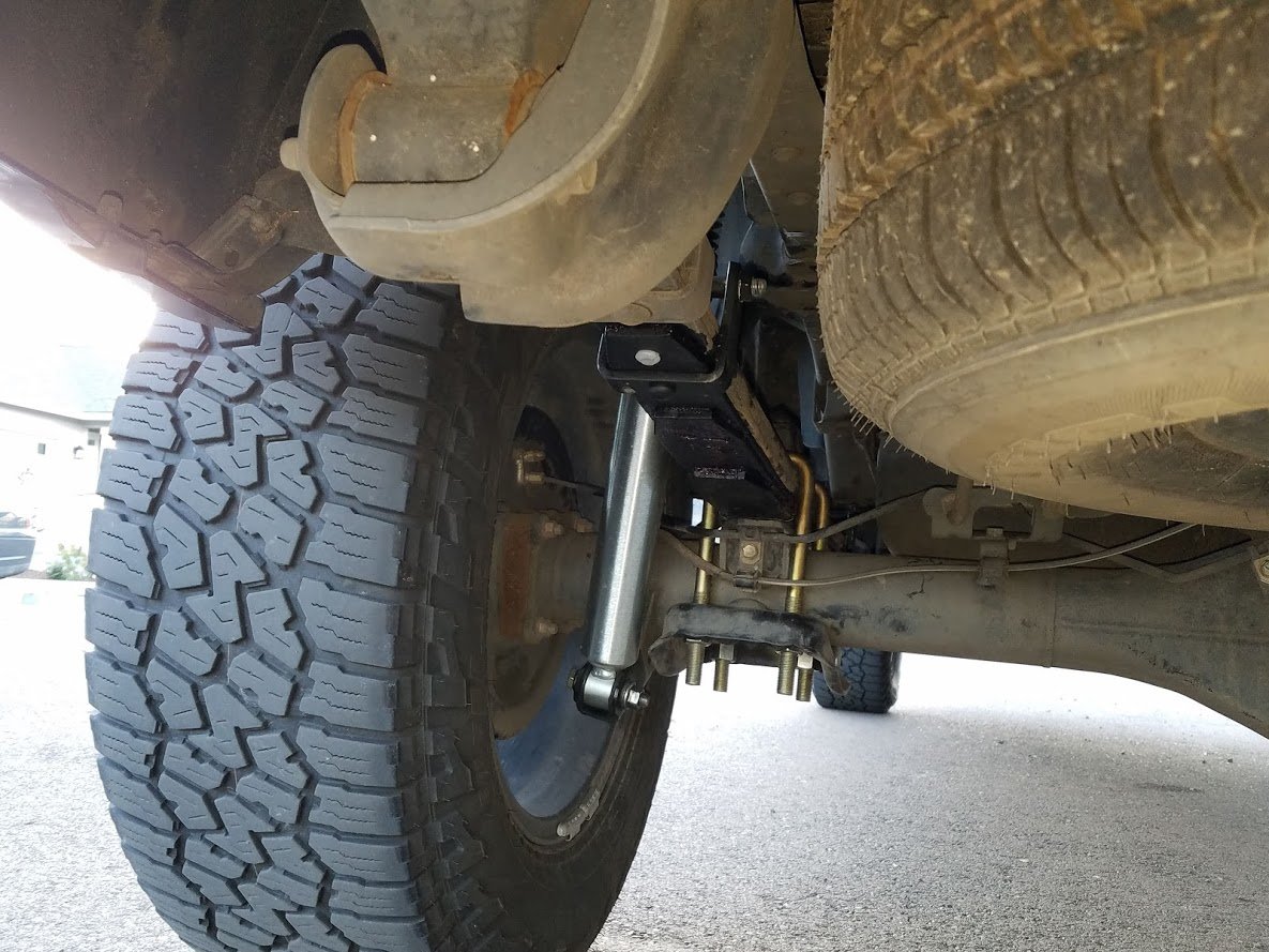

    My reason for leaving it out was this sentence:
    That, and the conflicting info on whether or not the rear 5100s I bought would tolerate 2" of lift. Some sites say 0"-1", some 0"-2"... I settled in between with the 1.5", although I'll probably put it back in eventually. I'm happy with how it rides now, so much smoother/stiffer.

    Nope, I didn't cut anything. The bracket that held the brake cable was on the overload,which I left out. I mounted the cable to the front bolt/bracket of the AAL. I wouldn't recommend that though, because mine looks a little stressed.

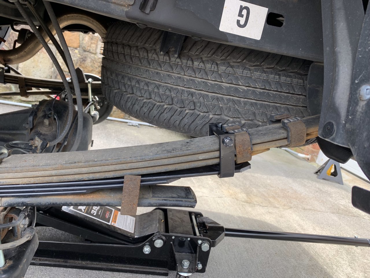

    Anybody have this issue? Do I need to cut the rivets and remove that clamp or is it ok to run it like that? The top leaf on the AAL is touching the bottom of the rivet.
