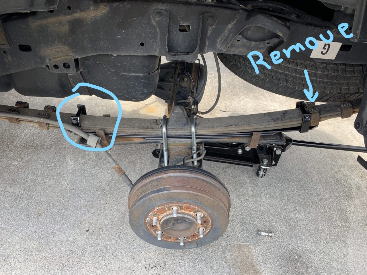

    I removed this clamp. Also, you might get some contact here with the overload when under load. I have the same setup and can hear it contacting sometimes.
    308savage[QUOTED] likes this.

    No problem. I'm thinking about cutting 2 inches off the front of the overload to clear the rivet on the forward aal pack bracket.

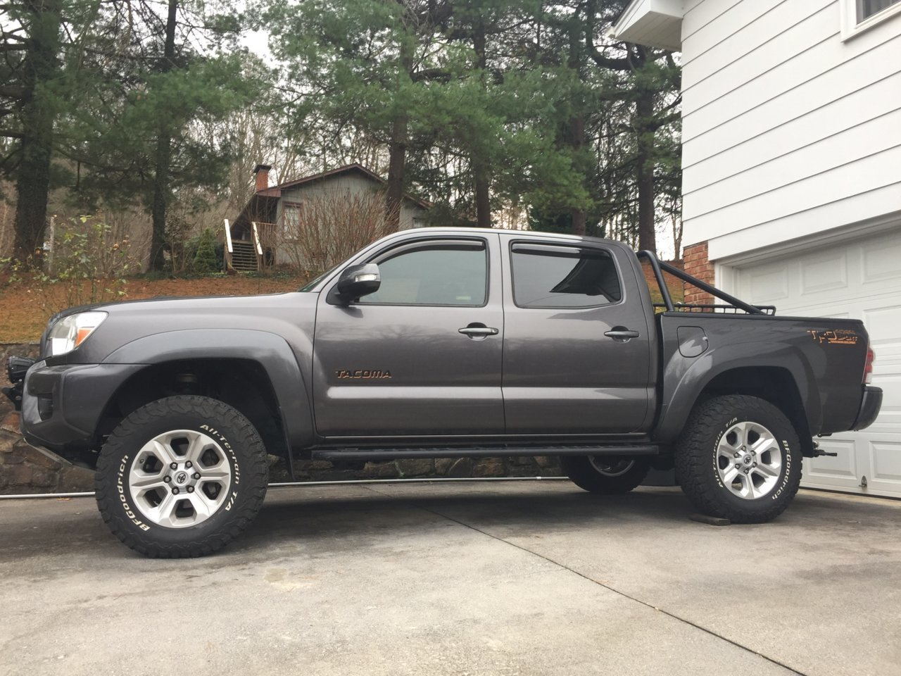

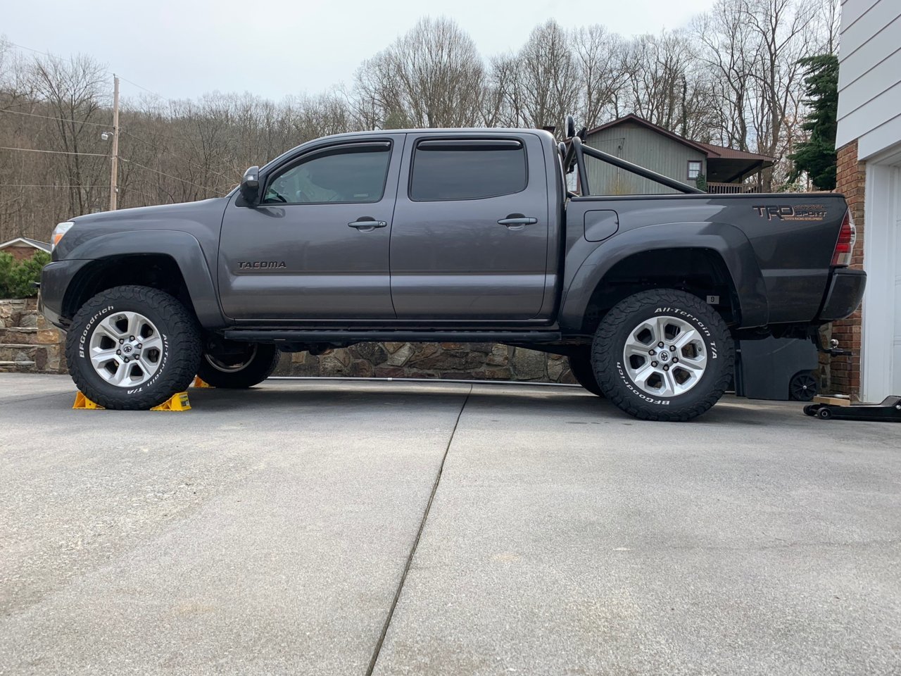

    Before and after (Wheelers 3 leaf progressive and a 1/2” shim)
    2417C433-3F20-4702-B639-976F313B7493.jpg 93FF4307-0DD2-4A99-B9A5-5BE07C12352E.jpg
    Kolter45 and supralee like this.

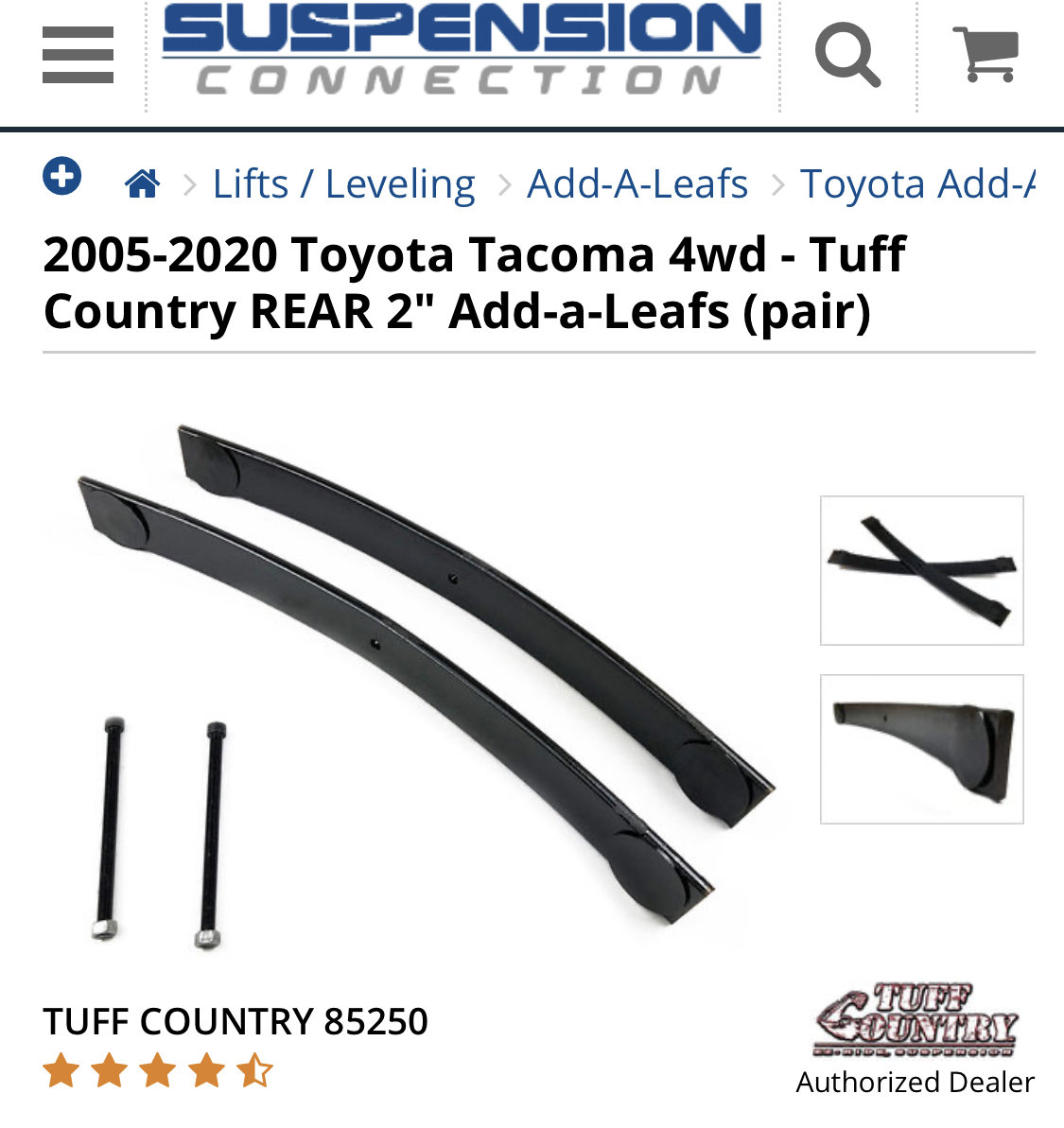

    Bought this today, looking to install it on my 2WD TRD. It says it’s for 4x4 but in the question and answer it says it will work with my truck. Anyone purchased and used the tuff country AAL for 2WD trd 2nd gen Tacoma?

    What did you do on the one you circled on the picture?

    I cut the overload back a few inches so it didn't contact the rivet on the bottom of the circled bracket
