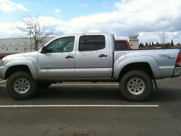

    just added my 2" aal from procomp huge diff
