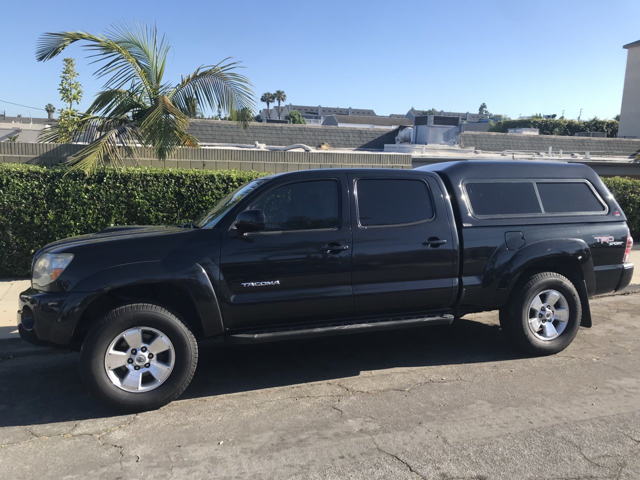

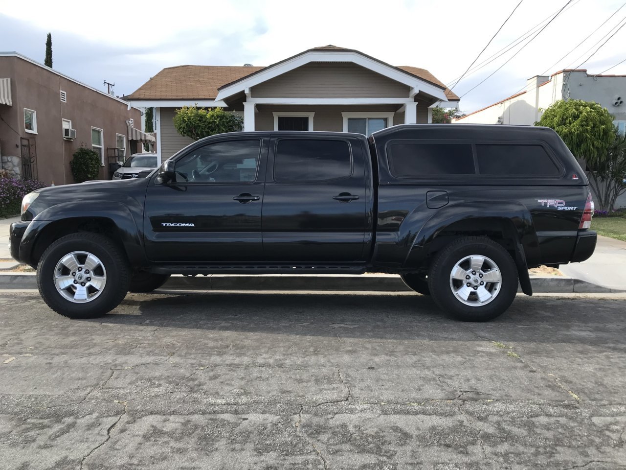

    So i read a ton of posts on AAL and Leaf packs, I have called 4 wheel parts but they dont seem to be too much of a help over the phone. I am in need of some advice on my rear leaf springs.
    I have a 2010 TRD sport Double Cab
    2 years ago I installed Bilstein 5100's all aorund. I set the front struts at the 1in adjustable plate, with the original trd sport springs.
    I did it to level out the slight rake from stock suspension.
    that worked fine for some time but now i have a taller camper shell, still not that much more weight (maybe 250lbs), a dual battery system (about 60lbs), and some small gear at all times.
    When i go camping i fill it more with gear and sometimes take a small motorcycle.
    Now it sags a tad bit, maybe about a inch lower than the front. The front seems to be at about 21in and rear is at about 20in from center hub to fender.
    Should i get a new leaf pack or add an AAL.
    My leaf springs seem to be pretty flat if not bending the opposite way. They are the original TRD sport leaf pack (3 leafs + 1 overload). I would love to get a new leaf pack like the OME EL095R, i have heard great things and you have a more stable controlled truck, but it seems that will give me way too much lift in the rear (2.75in) . is that too much rake ? I guess i could level it out in the front by stepping up to a higher ring on the 5100's but again i heard the higgher you go on the 5100s with stock springs the worst the ride gets. I like to have decent smooth ride. I dont do too much off-roading, just camping trails, beaches and highway mostly.
    Any advice would be much appreciated. Thank you all

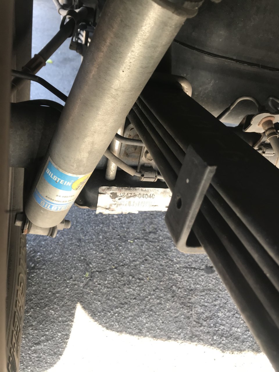

    I have an Icon 3 leaf progressive AAL (same design and style as the HS kit) in my 2009 TRD sport. It’s been on there for about four years with the Toyota TSB replacement 3+1 leaf pack. I left the overload leaf in place and also gained about 2” of lift. I’d recommend this setup to anyone wanting a mild rear lift on a budget. However, I would highly recommend removing the overload leaf if you decide to go with a progressive AAL kit.
    What I’ve learned in the almost four years I’ve had my AAL with overload kit installed is that sure, you’ll get the extra 1/2” of lift leaving the overload and it will ride great (better than stock), most of the time. I don’t haul much extra weight or tow very often, and the Icon kit has handled moderate weight in the bed and/or towing without a problem. But over time, especially with excess weight applied, you’ll find that retaining the overload leaf poses a big ride comfort issue.
    I’m actually in the process of removing my overload leaf right now. While doing some work on the rear of my truck, I noticed a round indentation on the top of the overload on both sides. This is because the metal rivet head on the AAL clamp has been sitting on, or making contact with, the overload for a while. This means, I’ve basically been riding on the overload leaf a lot more often than intended, which has resulted in a rougher ride. I’ve also noticed that over the course of the last year or so, the truck has been much more harsh over bumps in the rear. The progressive AAL has a relatively small third leaf that is not intended to make contact with anything, specifically an overload leaf. And while my leaf springs are no where near “flat” I guarantee with 200-300 pounds in the bed or a loaded trailer hooked up, the AAL clamps are both making contact with and digging into the overload.
    If you want ~1.5” of rear lift, install a progressive AAL kit (without the overload) and call it a day. If you want or need 2” of lift then consider a replacement leaf pack or what I’m doing, add a 1/2” flat shim under the entire leaf pack, instead of the overload leaf. As long as the AAL kit doesn’t make contact with anything, it will give you the lift you want and ride better than the stock pack alone (or blocks). But again, I wouldn’t recommend installing a progressive AAL kit with the overload as it’s not intended to be used that way and your ride quality will suffer.

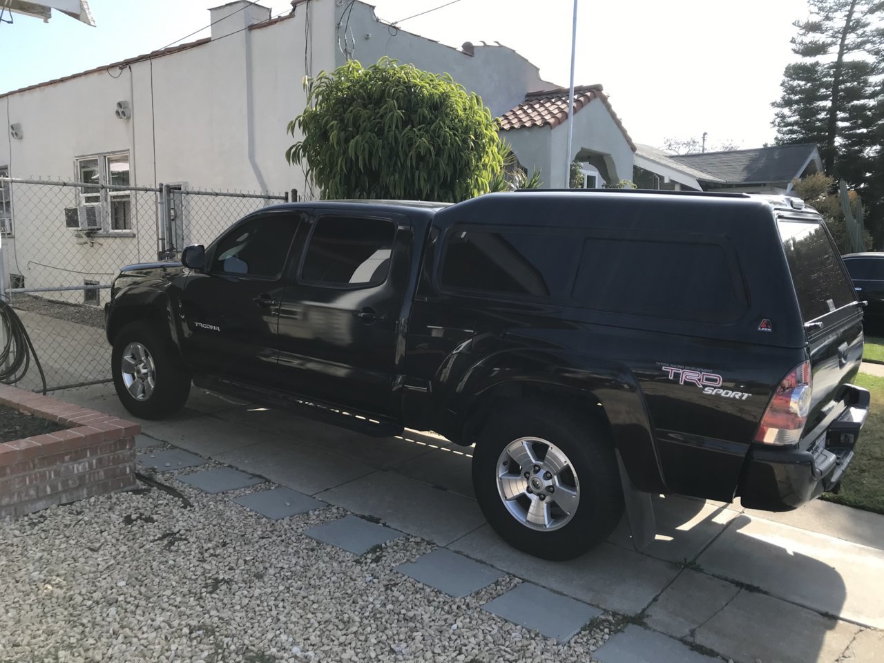

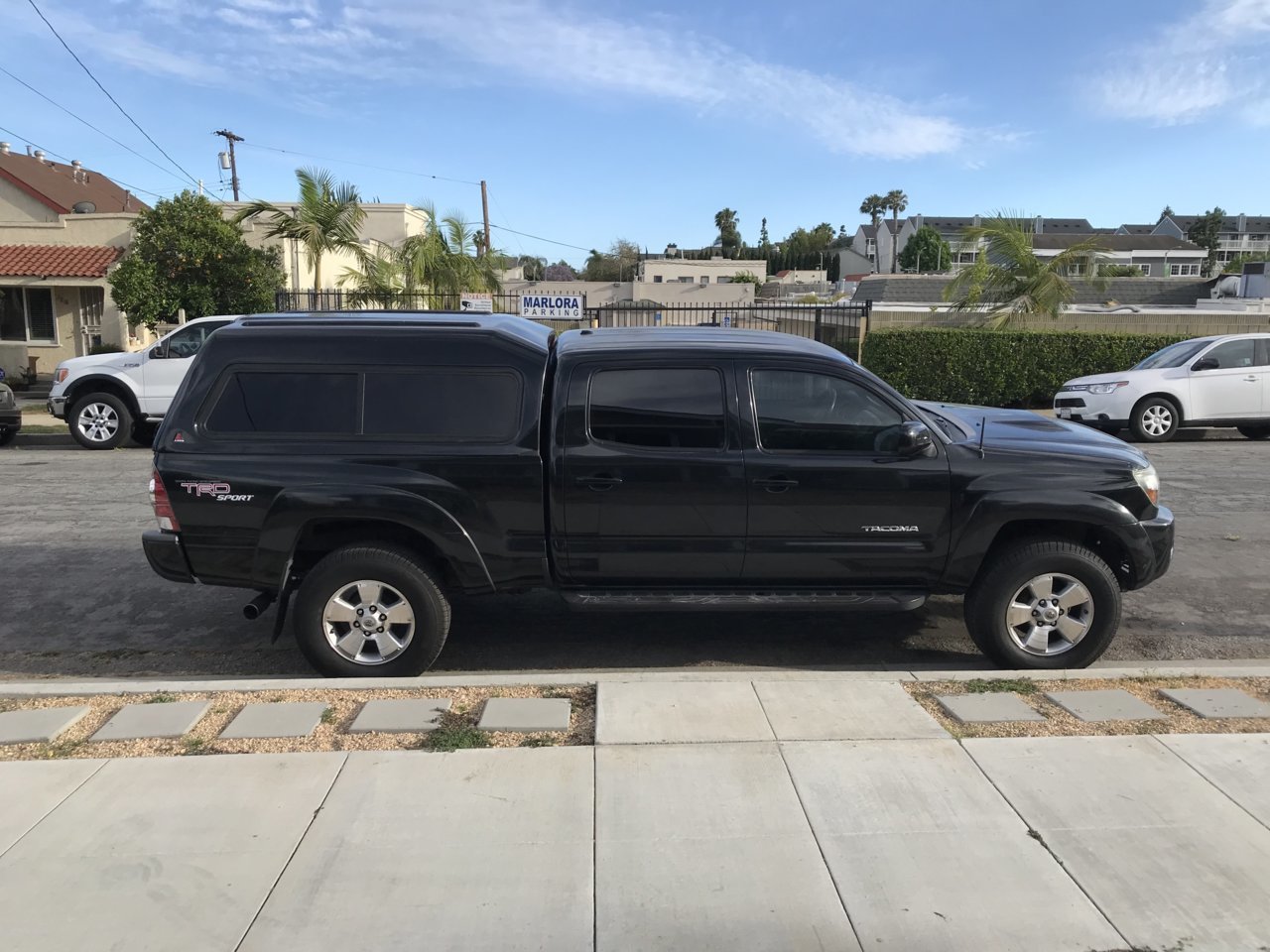

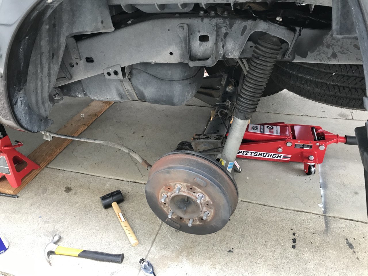

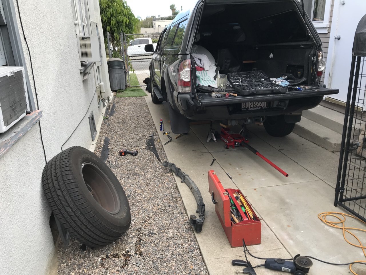

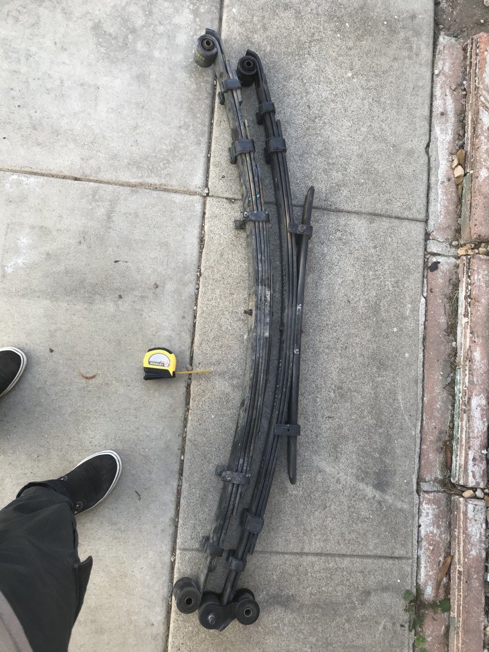

    Ok thanks everyone for help and responses. It really helped a lot.
    So I ended up finding a used but fairly new pair of 2019 factory tacoma springs with an Icon progressive 1.5 AAL already installed. The owner was kind enough to let me take them for $100. I figured it was worth the test project even if it didnt work out.
    I figured my current leafs were so tired that a new stock set and an progressive AAL would do the job for me with minimal bed weight use.
    I decided to do the install myself after watching a couple youtube videos. Ive never done leaf springs so the first side took me about 2.5 hours. I was working very slow and by myself, I went and got a decent jack from harbor freight that cost me $100 and had 4 jack stands total. The second side was a breeze once i figured out the process, it took me about 1 hour. In fact, after doing the first side i realized i didnt even half to remove the shock to swap a leaf pack. It took a little bit more muscle but saved me the time i would have spent struggling with that spinning top screw.
    After my install, it sits perfect now with a slight rake which is what i wanted. I measured hub to fender, passenger side was sitting at 23" and driver was sitting at just over 22". curious if this is normal, or if the springs are dedicated per side. The + sings were identical on both springs. by driveway isnt perfectly level nor is the street, not sure if that would matter.
    Maybe I need to install the taco lean spacer? where would that be if it was already installed on my truck ? front driver strut?
    I am going to drive it around for a couple days and check my torque again.

    Your post is exactly what I’m looking for. My progressive AAL rivers are digging into the overload as well. I still want that extra 1/2” of lift, and am thinking of cutting the overload shorter so it acts as a shim without contacting the rivets. Did you consider this?

    I did consider that as an option. But, the shims were less than $50 shipped and I didn’t have to worry about cutting straight or grinding down sharp edges. And here are some pictures after I removed the overload and replaced it with the 1/2” shim.
    I hit everything with a coat of Rustoleum Rust Reformer after reassembly, so the shim is there in the second picture, just painted black now. And the truck is still “under construction” so I haven’t driven on the new suspension yet, but once it’s back on the road, I’m excited to no longer be riding on the overload leaf!

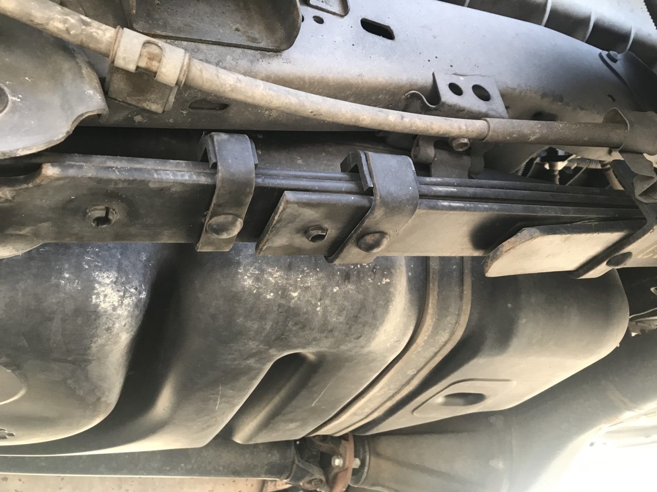

    I decided to go ahead and cut my overload down on both ends, shortening it to about the length of the shortest leaf. Essentially creating a 1/2” block. Your way is much cleaner, but this way I didn’t have to take the leafs apart!

    I'll have to let you know! I may not notice a difference honestly as put the 3 leaf AAL in just last week.
    I'm curious why the rivet contacting the overload isn't a more common issue. I searched all over TW and only found your post and one other post. My guess is that I'm using the re-designed HS 3 leaf AAL, which is recommended for use without an overload. Nonetheless, glad we both caught that rivet contact point- not a good thing to have rubbing constantly in the leaf pack.

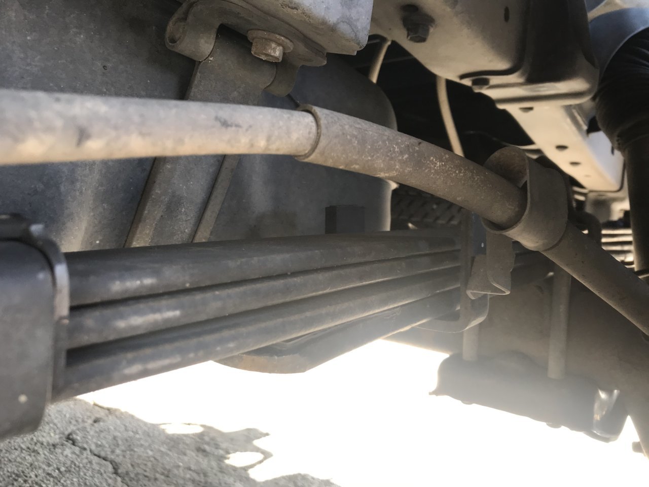

    Three plus years of use. You can see the rivet head indentation clearly. The one on the right (passenger side) was making contact far worse than the one on the left. Kind of odd considering the truck has more weight on the driver’s side of the frame.

    That's wild! My rivet was contacting the pads near the ends of the overload, but had already started to peel that pad back. I can't say I've noticed a difference in ride quality driving around today, but then again, my new 3 leaf AAL has been installed for less than a week.
