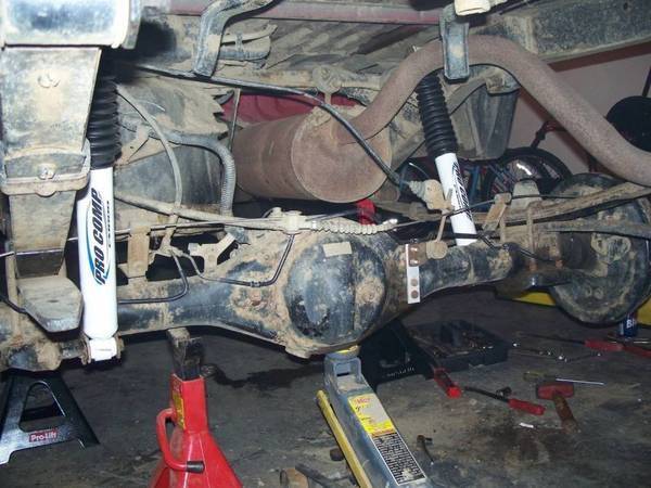

    Anyone have a picture of the AAL on their ride... Going to Add this mod but would like to see it on there. Trying to decide if I can install it myself or does a real mechanic have too./... I just have floor jacks and jack stands..... anyone done this at home who isn;t a hard core wrencher...

    Here are the AALs and new shocks I installed last year. If you can turn a wrench, you should be able to manage this install without anymore prblems than getting some tough bolts loose.

    I dont think I have any pics, But, All you need is a jack stand, bottle jack, basic tools, and a "C" clamp. Preferably 2 of them. Also, you may need a new centering bolt. To be safe you should pics up 2, one for each side. Its not a hard job to do, and it helps to have a buddy, so he can lend a han and you can yell at him if something goes wrong. It should take 1 hour per side if you havent done it before. Maybe longer if you are very cautious. Im sure you can get the help you need on the board. :)

    I think the Totec AALs come with new centering bolts. You may need to cut them(centering bolts) once they're in.

    they do come with new center bolts....
