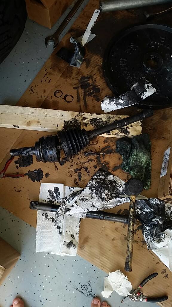

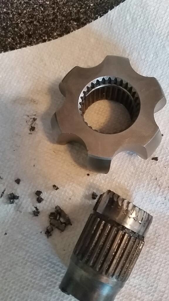

    First CV I did went way too smooth. This one has been a nightmare. Had to use a puller on the tulip and cut the half shaft so I can get the stub pressed out. The slide hammer pipe trick did not work. I tried that for about an hour. :anonymous:

  9. Jul 28, 2014 at 2:20 PM
    #529
    AaronArf
    AaronArf [OP] Well-Known Member
    Nov 12, 2011
    #66926
    4,218
    Aaron
    VA Beach
    2023 LR OR DCSB

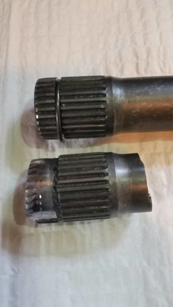

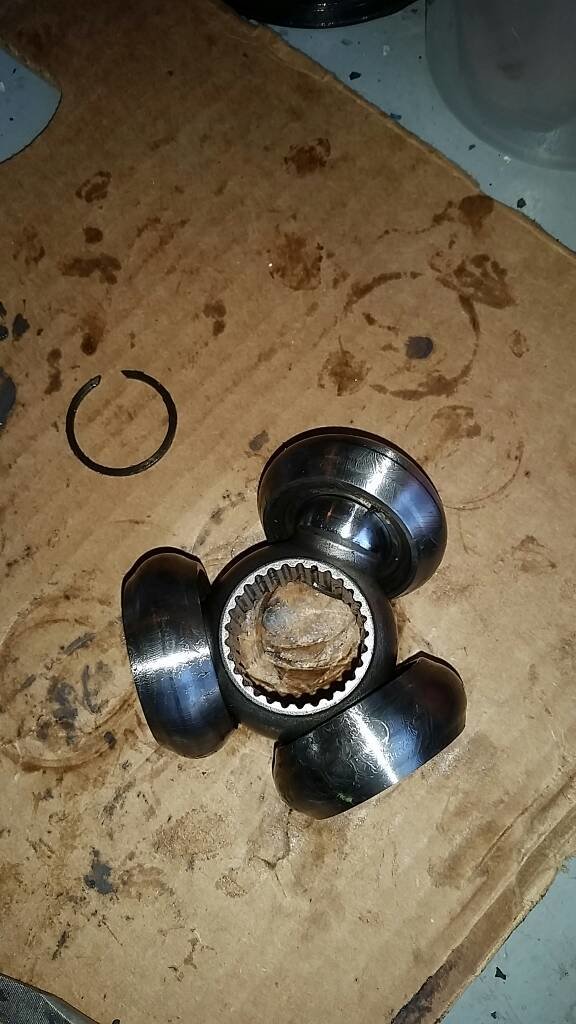

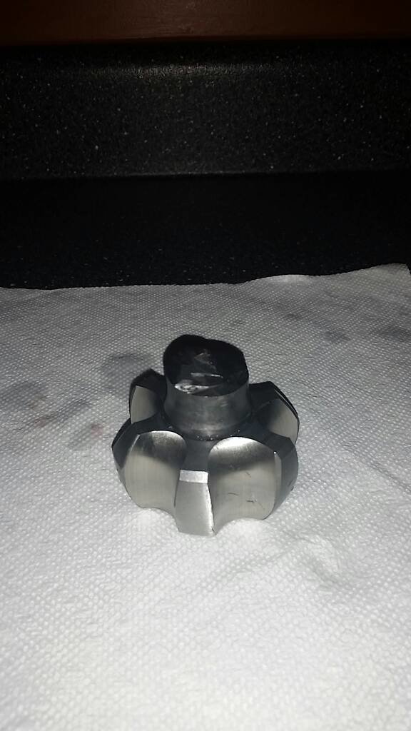

    ata4uhes_ec9b69422699a5d300a86c00800e7812e3a63030.jpgema9y9ej_dffee6ac3d644af55b3a2ea0b2fd541b8b9611d3.jpg
    Phew, Got it apart. Went to a local drive shaft shop that has a serious press (100 ton) and he was able to get it pressed out. The e clip didn't break, it held strong and actually sheared the splines off the shaft. Luckily I was able to use a punch and dead blow to clean out the splines, then pry the bastard clip out. old guy said he'd never seen one so tough.

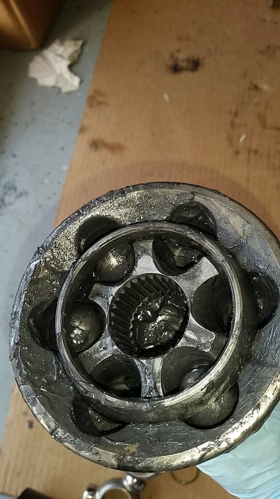

  19. Jul 30, 2014 at 3:27 PM
    #539
    AaronArf
    Nov 12, 2011
    #66926
    4,218
    Aaron
    VA Beach
    2023 LR OR DCSB

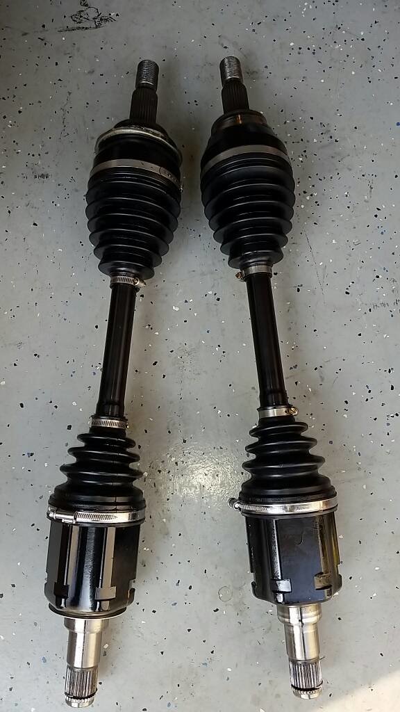

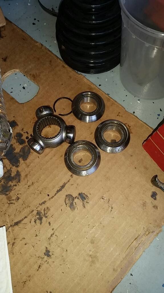

    The LT prep continues.
    Finished my first pair of +2 CV axles. That was messy....
    Birfield apart
    Some of the balls back in the cage
    Greased back up
    Inner joint components broken down
    almost there!
    Crom likes this.
