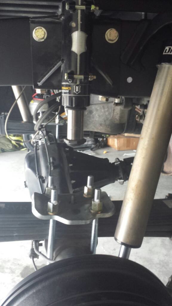

    Well its a land Cruiser with a diesel so I've got that going for me.
    Dis bitch needs longer shackles!!! And SUA is not only a waste of money but reduces ground clearance...save your money and do a decent shock relocation!

    :itllbuffout:fab strikes again. :oldglory:
    Looks great, except for those cruddy Fabcrap shocks! :D

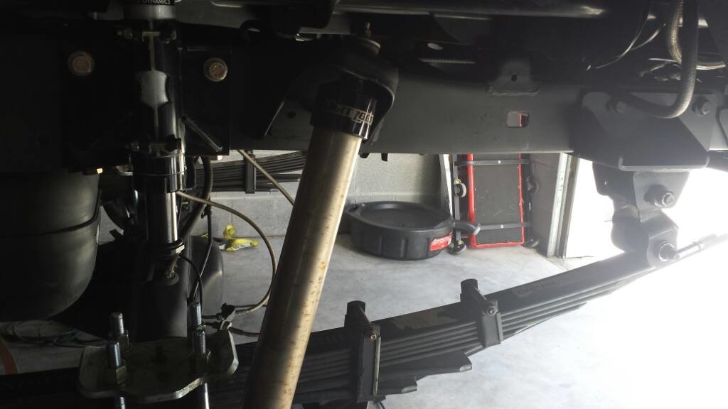

    Dear Aaron,
    This is how your shit should look when done working on it...please note the torque paint...just gotta get them shitty wheels of yours on and she done.
    Sincerely,
    Your mechanics at Shit Buff Out Fab
