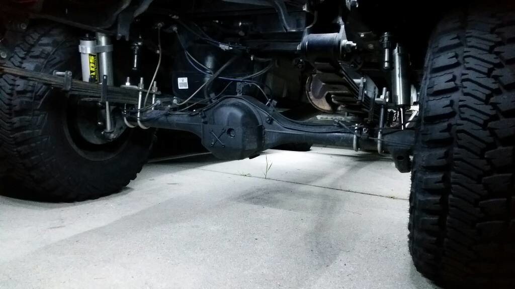

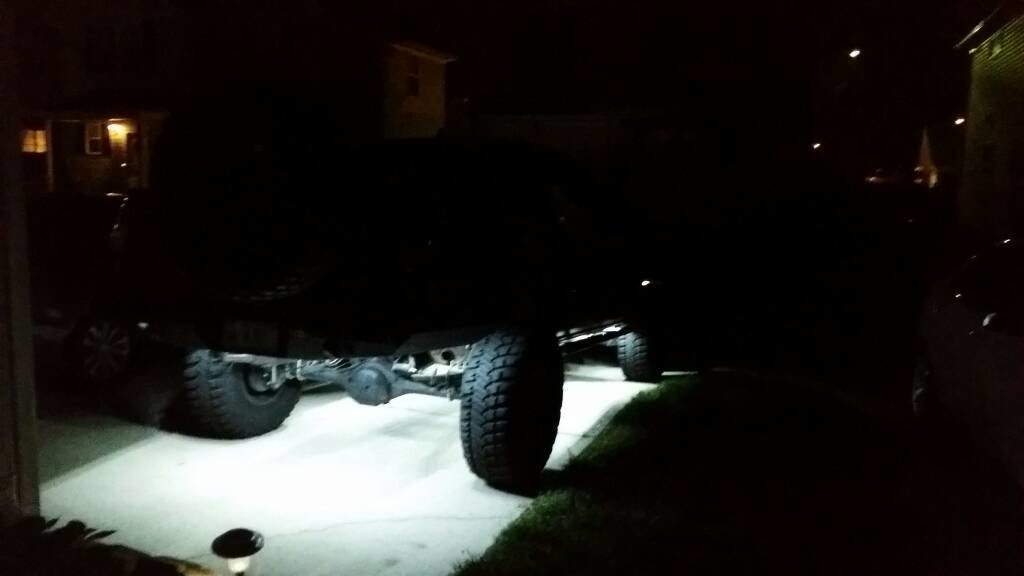

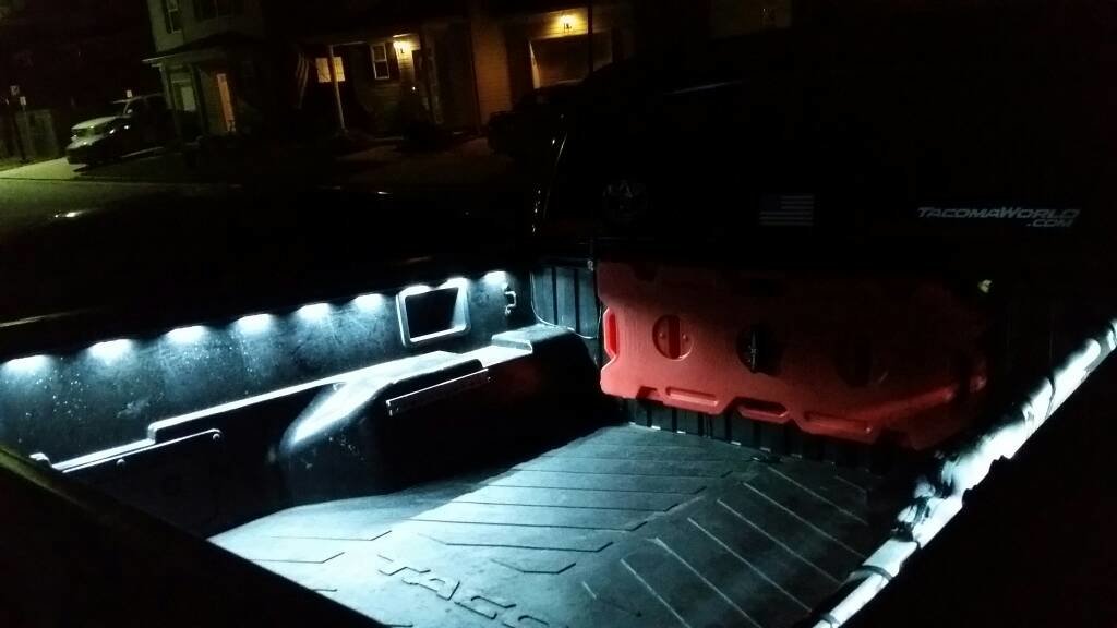

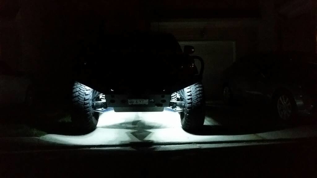

    Rock lights finished, bed lights revision two installed and Rotopax mounted in the bed. One step closer to being ready for moab!

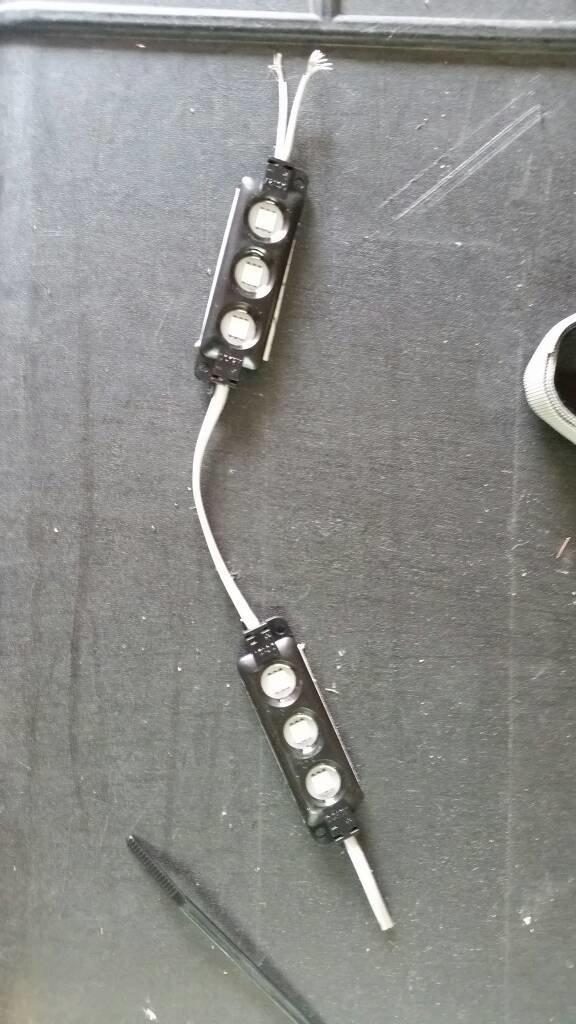

    Lights work great. What ones did you use?

    Oznium led modules. They're awesome! 0c1b02348613e0c7c5db29e44db6ef37_50f96a608ace1f9024ee9b45a50e658ed207debf.jpg

    They look it. How many did you use? Looks like you got the entire ground underneath light up

    48 total, between the bed lights and rock lights. Wasn't too bad to install and any connection I soldered/heat shrink and wire loomed.

    Never said it didn't take forever. definitely a solid days work if you solder and all that. Could just plop them under there and use butt connectors, You'd be done in a third of the time.

    Your rock lights have perfect coverage! How many did you use underneath. Where did you put them?

    Thanks man, I'll grab some pics to post up. But 8 on each rocker panel, 3 in each of the front wheel well, 2 in the rear wheel wells and 4 across my air tank between the rear frame rail.
    30 total, cool white
    Used 18 for the bed rails, 9 each side. None up front
    http://www.oznium.com/premium-led-module
