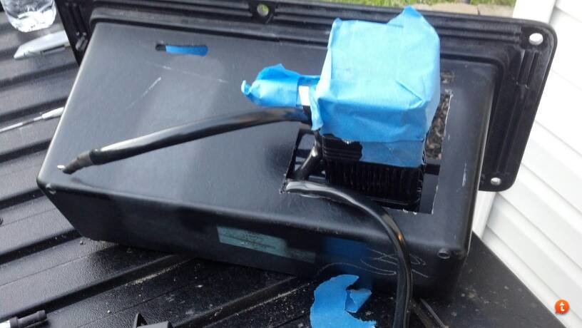

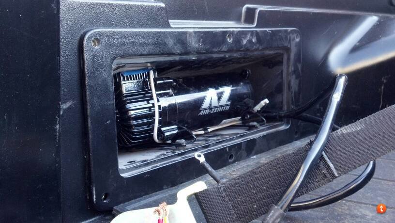

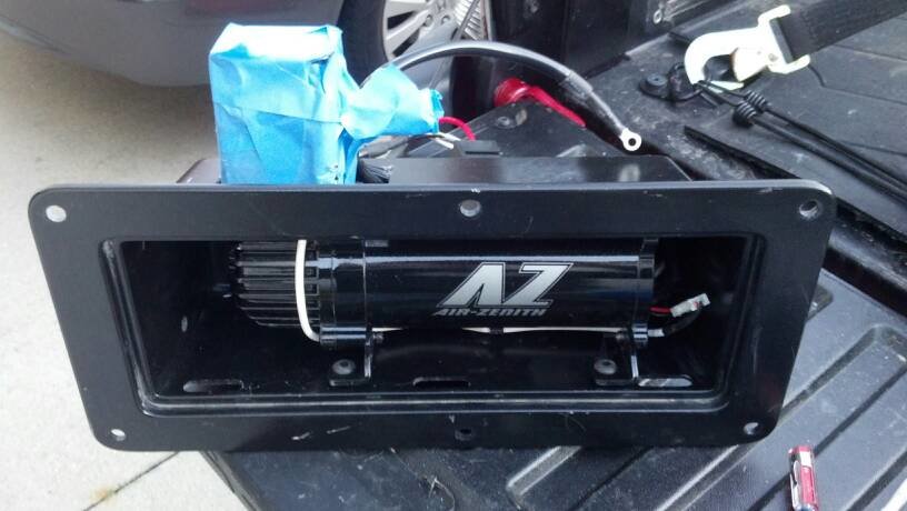

    Aaron, do you still like your Zenith OB2 air compressor? Any issues with the mounting location, dust, etc? I'm thinking of acquiring the same compressor and wanted your opinoin. Thanks.
    Nate87 likes this.
  20. Sep 12, 2015 at 8:33 AM
    #1240
    AaronArf
    AaronArf [OP] Well-Known Member
    Nov 12, 2011
    #66926
    4,218
    Aaron
    VA Beach
    2023 LR OR DCSB
    The compressor works great, real fast. The mounting location has been fine through mud, water and sand. I just make sure to fill my tank prior to getting into the real nasty stuff and turn the compressor off. I ran my lockers for ~4 days constantly on and off in Moab without having the compressor kick on once.
    Although If I were to do it again I'd just go with a ARB dual. Plumbing a non-arb compressor for air lockers was a pain.
    (npt to aussie fittings, regulator etc)
    2ndGenJonny and Crom[QUOTED] like this.
