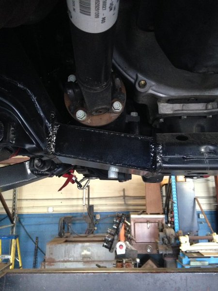

    What do you guys do for the part of the frame that was cutout when you get rid of the DB lift? Do you save the section of frame and weld it back in?

    Nope, new piece of tube steel goes in there

    Depends on who is doing the work and how much of the OEM cross member is left.
    Fabtech directs you to cut the entire thing out and cap it. Pro Comp and BDS do not, they just have you cut a small section for the front drive shaft. Theoretically you could be re-weld it in but I'd say ditch that and weld in beefier stuff.
    On mine its got a big piece of square tube and a big piece of angle iron for the front diff mount, makes it easier to get the diff out now.

    I had a PC DB so the cut out was small but in a very awkward spot and a very complex shape to reproduce...unless you did save the cut out piece. Mine went into a trash can back in 06' so we capped off the open ends with some plate to create so flat surfaces to build off of then we made our own boxed section out of plate. When I get my skids we will just have to add a tab or mounting point in that spot more than likely.

    Interesting fix - a lot easier then recreating the Diff mount.

    I don't have a photo of the diff mount on the front of that new boxed piece but it is basically just a simple tab. We installed the diff at the front mounting locations, measured the OE diff mount location on a friends truck and cut out a tab from plate. We installed the tab to the diff with OE hardware and then jacked the back of the diff until it sat in place then tacked the tab on...hope that makes sense.
    In hindsight it was pointless to spend $ on the OE rear diff bolt and nut. The bolt is just a stud like a wheel stud that you can buy anywhere and we could have just used s regular nut vs that funky OE nut. If you are not going to try to sell your used DB kit you could even just reuse the PC rear diff mount.
