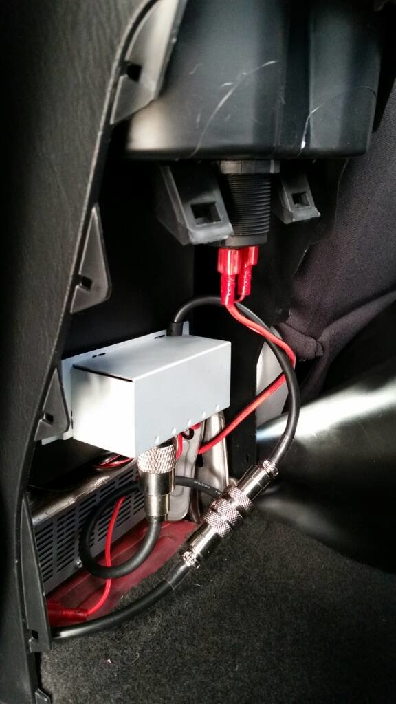

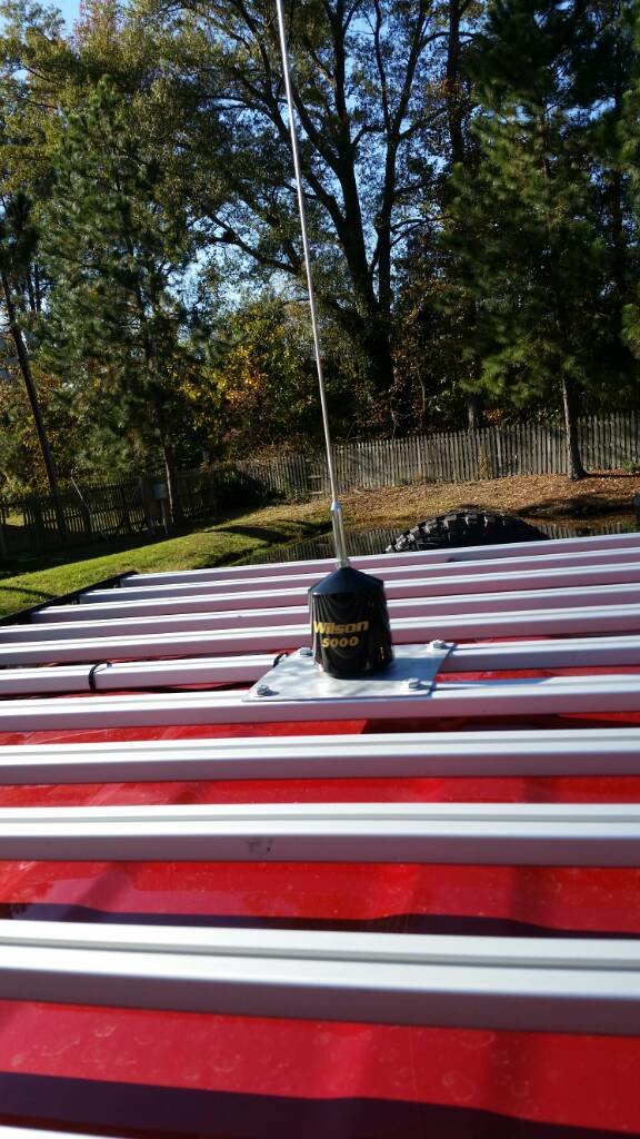

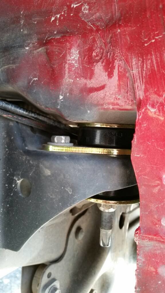

    Crappy Pic of the Wilson 5000 mounted
    Cobra 75 CB install cleaned up, moved from just floating under the shifter/cup holder area to secured on the back side of the console. (Freeing up space for something like a FJ case)
    You can also see the bottom side of the Blue sea USB charger that I have in the cup holder.

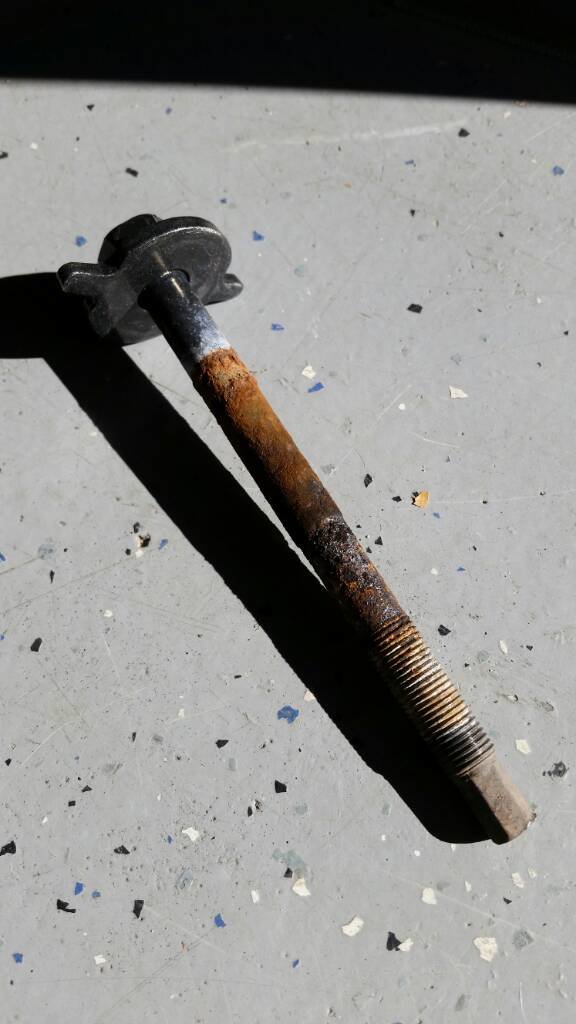

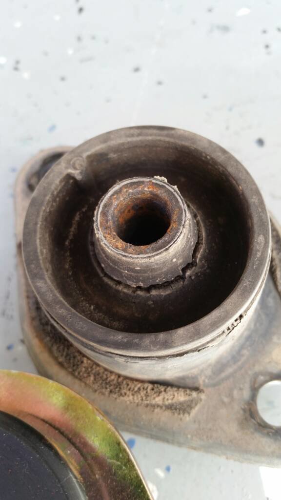

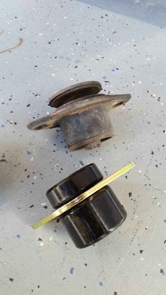

    Energy Suspension Body mount bushings installed...Wasn't a bad job.
    The 14mm bolts on each mount were fun to get off because you can't get a ratchet in there and no leverage on a box wrench. Rear 17mm body mount bolts had a lot of corrosion that had it seized to the sleeve. Lots of BFH... 52k miles on the odometer, for reference. Cleaned up all the threads and shank and coated liberally with anti-seize.
    Fronts didn't look too bad...
    Rear looked a little more rough

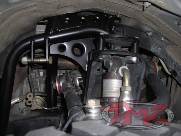

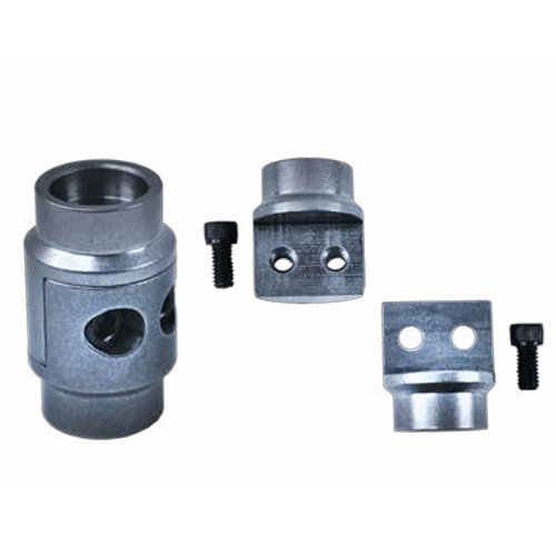

    Continued from the Dirt Design cross brace group buy thread:
    The top plate of the DD cross brace will help your sliced and diced coil buckets if you weld them on to the coil bucket.
    To add more rigidity to the DD cross brace I would weld the whole thing together, cut the cross tube and install these to make the cross tube removable.
    tube-connectors-4140-chromoly-tubing-dis_a8ebbaf08c0eeeef9f5f107db82163a7ec362d63.jpg
    If I was to do a cross brace to help firm up the frame, this is a better way of doing it. The double shock tower is a TC product.

    Cool idea if understand correctly. You want to use the DD coil tower piece and incorporate the disconnect?
    @ckeene9 did you buy the DD product?
  19. Dec 5, 2015 at 10:00 AM
    #1359
    Evenflow
    Evenflow Well-Known Member
    Jul 15, 2013
    #108344
    5,773
    Jason
    San Diego, CA
    06' DCSB 4x4
    Yes
    The DD tower piece already un bolts at the " hinge " ( it's not a hinge tho it is a solid bolted joint ) so he DD set up is already removable without having to add any addition tube connectors into the mix
  20. Dec 5, 2015 at 10:04 AM
    #1360
    2ndGenJonny
    2ndGenJonny Well-Known Member Vendor
    Jan 3, 2013
    #94306
    18,457
    Jon
    Gilbert, AZ
    Ok, I see that. It's already a tight fit in there as it is. I have the TC CB gussets already and sooner or later I will add a brace. I'm just curious as to what Drew is saying.
