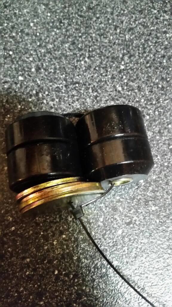

    Any opinion on the new rad support bushings now that you have a few miles on them?

    For sure a worthwhile "fix" - if you plan on ever doing the body mounts as well just buy the entire body mount kit it comes with some for the radiator support. :thumbsup: About 500 miles on all my poly bushings, no noise yet. @ckeene9 reported some noise in the cold the other night on his truck....might be hearing shit though! :crapstorm:

    I thought I read that the rad bushings that came with the cab mount kit weren't very good? Is that what you used?

    I would have used them, I did my rad support before ordering the other kit...they might not be good if your radiator support was already toasted and you wanted the taller one on top. I'll dig em out and take a pic if you'd like

    I'd appreciate it. My rad support is still okay so this is more preventative maintenance for me.

    Here you go! Same material as the universal ones, sleeved and comes with washers.

    Looks fine to me. One of the posts in the other thread said they were a softer material though. Not so much?

    I really don't think it's softer material, even if it is slightly they still are 20x better than stock

    Thanks. I'll put it on my list of future mods and just get the one kit.
