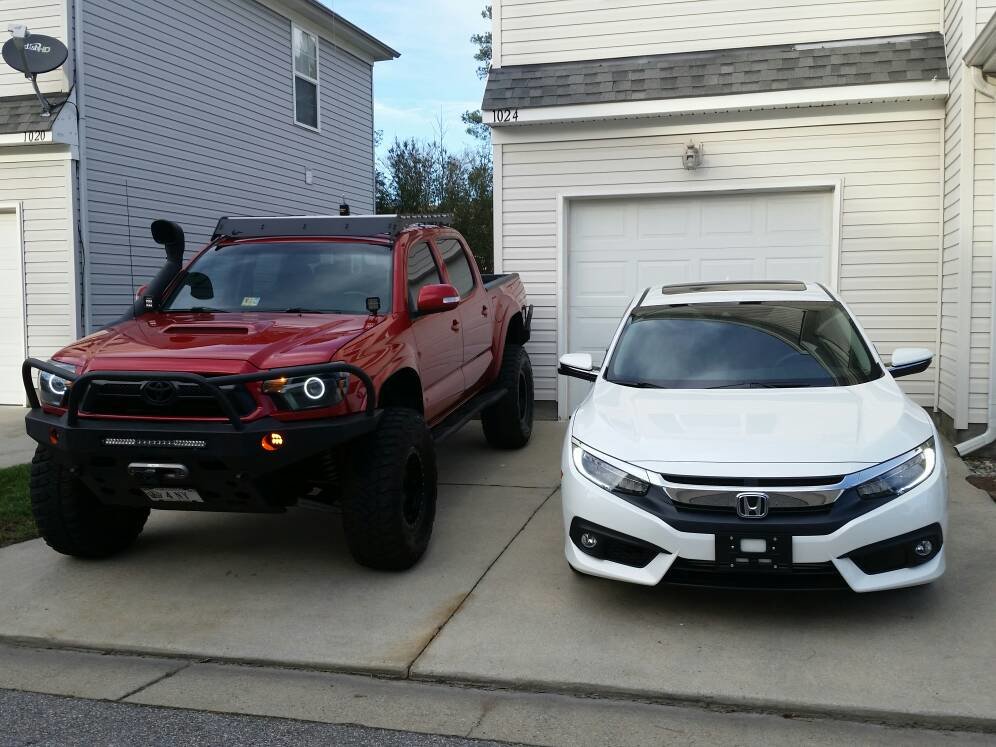

    My truck is finally not my DD. Got a 2016 Honda Civic since I'll be commuting A LOT for work now and on the weekends.
    Washed and waxed them both today.

    That civic looks nice!

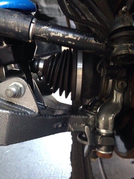

    Not sure if this trick will work with your non race series lowers guys but I had a problem getting to mine too because there was not enough to room between the bottom of the CV and the top of the uniball to get a socket on it. ( see solution below )My lower uniballs have a square socket hole in the top so you literally just put a ratchet directly onto the uniball but again the space is too tight to fit a ratchet in - looks like this :

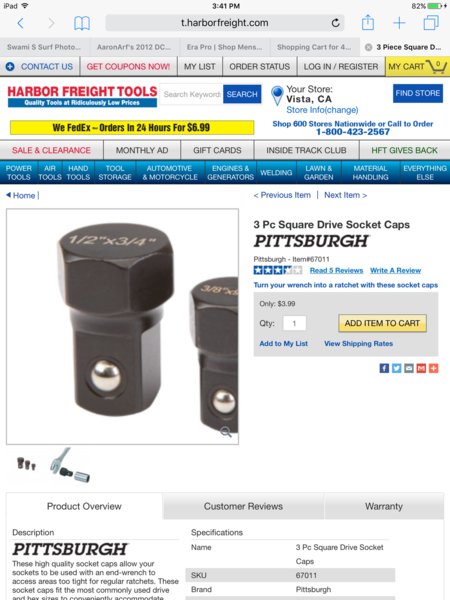

    So, I was going to have my fab buddy weld a small chunk of square stock to a piece of flat bar to make my own low profile tool but then I found these online and ended finding them at harbor freight. Just drop this into the top of the uniball then hold it with a crescent wrench or box wrench :

    Top of ours is an allen head. The clearance is so tight though I don't think you could get anything in there. I wondered how it doesn't rub the CV to be honest. I love my non race stock length lowers aside from this one fact.
    I did find however that I could hold the top in place with vice grips in a pinch.
