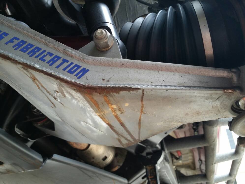

    @Evenflow here's your half moon lol e0237c8dd99e20b899073e624e9f19d7_9fd83cdb7a2c7e14897070260bc4a16ab9b63459.jpg
    Damn rocks. Should have stuck to mall crawling, my beautiful TC arms look like chit.
