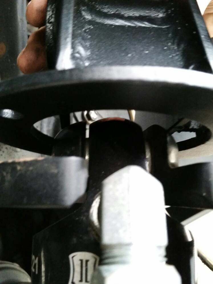

    Aaron, the inner lip of the ball joint cradle needs to be trimmed a little. That's right where the half moon is :D Or maybe it's the misalignment spacers on the lower bj cradle?
    see page 5, this is for FJ/4Runner instructions, couldn't fine Tacoma ones on the Race series should be the same though.

    oh shit :/ I was actually talking about the top side of the LCA and the CV hitting the top side at droop. Do you have marks on the top too ?
    The marks on the bottom mean that your bumps are not set tall enough because the lower bj adapt is contacting it.

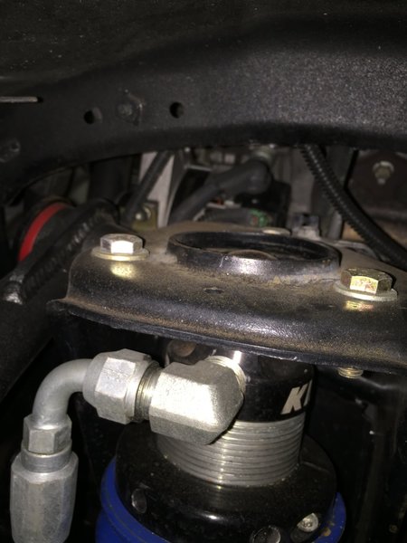

    yeah I am fearful of that too, can you post a pic of how much yours sticks up...curious to compare. Dirt Designs should refund anyone with that prob IMO...pretty much a part that will be used on a truck with aftermarket CO's :/
    edit - i should be ok with just a washer to clear that lip around the hole :

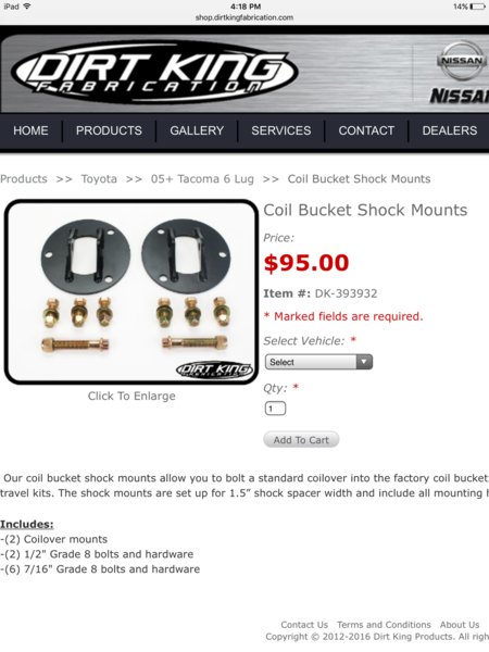

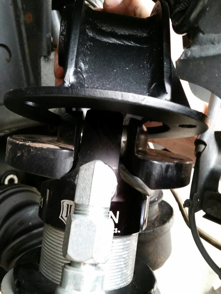

    Oh that Icon top hat to coil bucket adapter is funky huh...You could just get a different top hat adapter for the CO, quite a few of the fab shops make them :

    Wait....Aaron can you just flip that existing Icon adapter over ?
