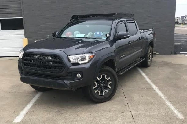

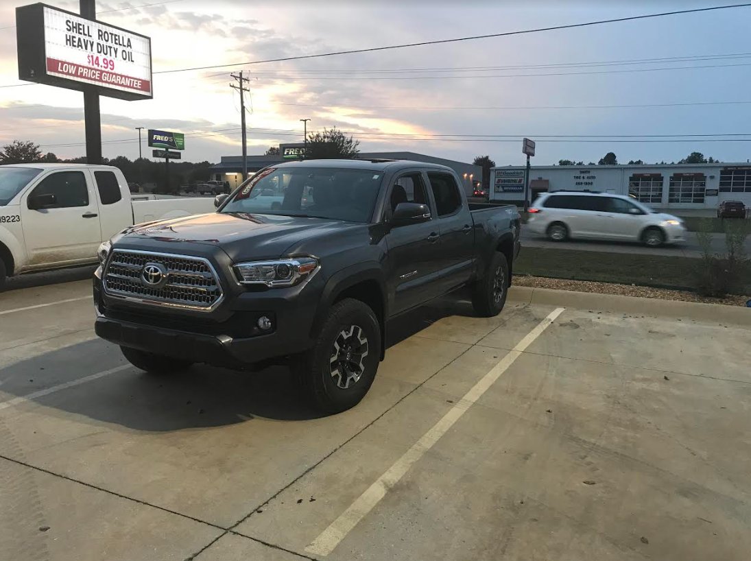

    Here's out it was when I had first bought it. It's a 2017 TRD Off Road DCLB with tech package.
    I made the choice early on that I wanted the long bed, predominantly because I was thinking about going the sleeping platform route. Being 6'2", it'd work out fine. The extra foot has proved very helpful during my time driving it. No regrets at all. When I bought the truck, I also had a little Hyundai Accent that I thought I'd drive to and from work...that didn't last long. There's times I'd still like to have a second vehicle, but I'd rather have a little more interesting project car if I do. The Hyundai was fine, but...you know.

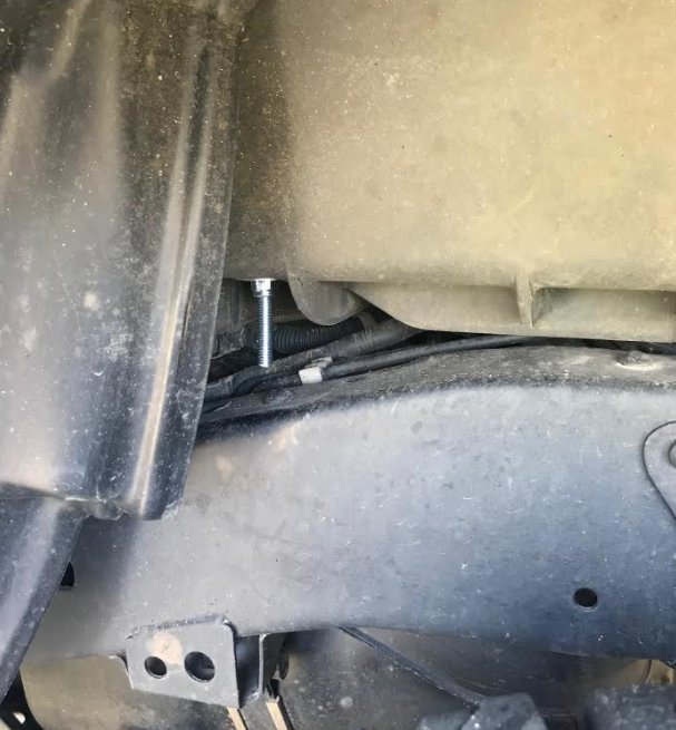

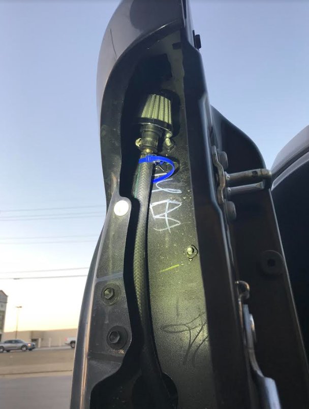

    I have my rear diff breather behind the driver's side taillight:

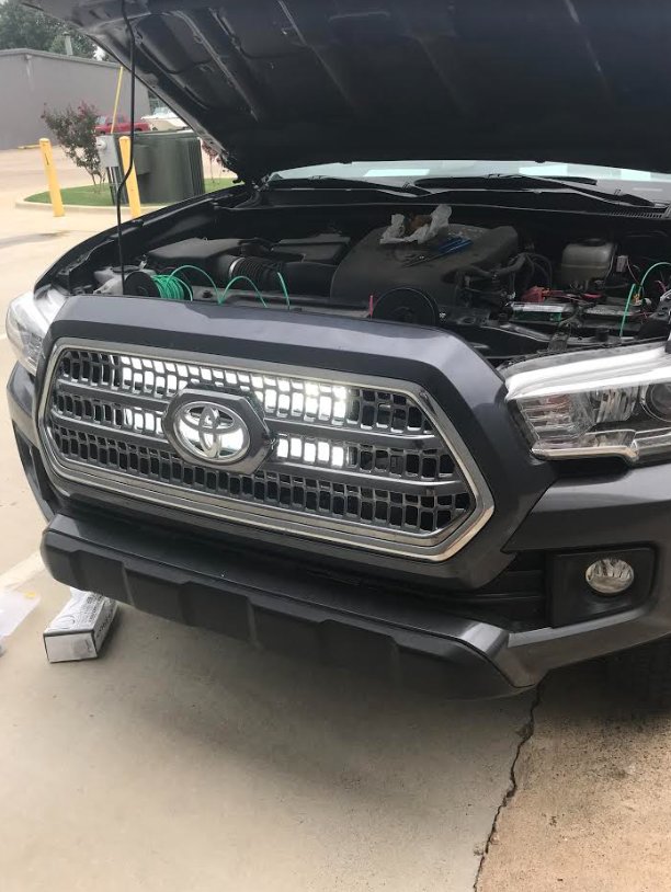

    I added a couple cheapo Amazon curved light bars behind the grill:
    I now have a 40" Rigid on my roof rack; so, these are pretty much pointless. I'll pull them off and put them on a boat probably.

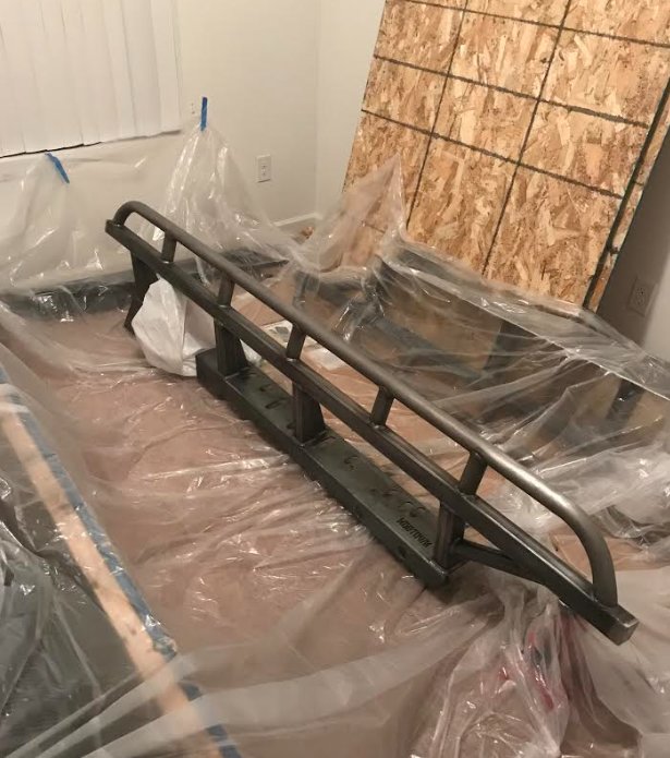

    Speaking of sketch, I got Mobtown bolt on sliders while I still lived in the apartment. Still painted them there though!
    I know. Ventilation. Blah blah. ^Worked^
    Only passed out twice. Hahaha, kidding.

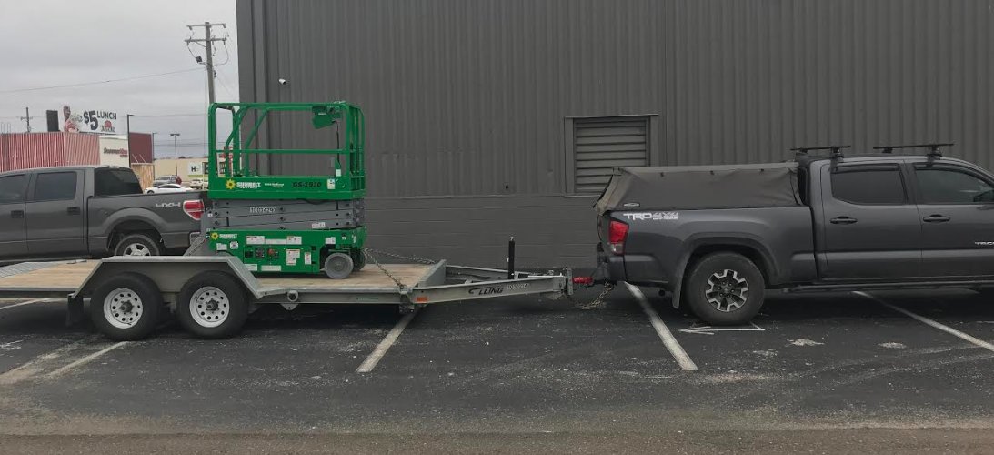

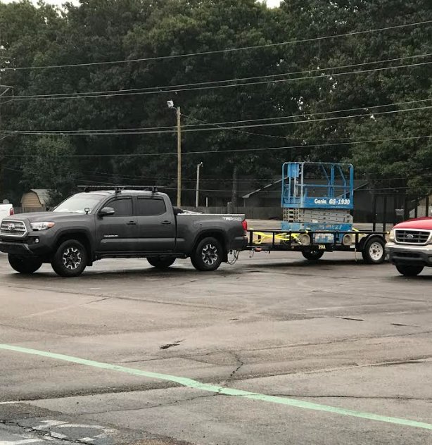

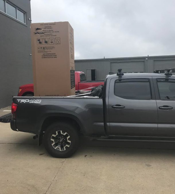

    At current I don't have a lot of stuff to tow, but I do get conned into towing other people's stuff. Once I learned how to back up with them, they became kinda fun. To a point, of course, they get to be a handle before long too.
    I hated this one:
    It was more than I wanted. No dual axle, tilting, car haulers for me anymore, thank you. Oof.

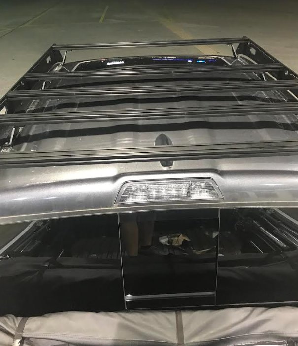

    Then I pulled the Yakima bars off and installed a Sherpa Co. rack:
    The main difference between this rack and the Prinsu is how the actual rack attaches to the feet. The feet on the Sherpa are directly under crossbars, and therefore, the weight on the rack rests directly on the feet, instead of being transferred from the crossbars to the side plate and then to the feet. That's how I believe the Prinsu is. This should technically be stouter since it doesn't completely rely on the shear (?) strength of the bolts holding the cross bars in. Either way, I'm a fan of Sherpa and would recommend their racks.

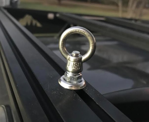

    I made these neat little tie downs for it.
    These prove especially useful when attaching the kayak, or anything really. These can be moved along the extrusion crossbar so that the strap pulls the boat directly down to the rack, and that angle is incredibly better at stabilizing a load compared to tying off to both sides of the rack, ie.
    They are each a 1/4-20 carriage bolt, washer of some sort, 1/4-20 nut for a spacer, and a 1/4-20 eye nut. If you have a shorter carriage bolt, you don't need the spacer nut obviously. They work well.

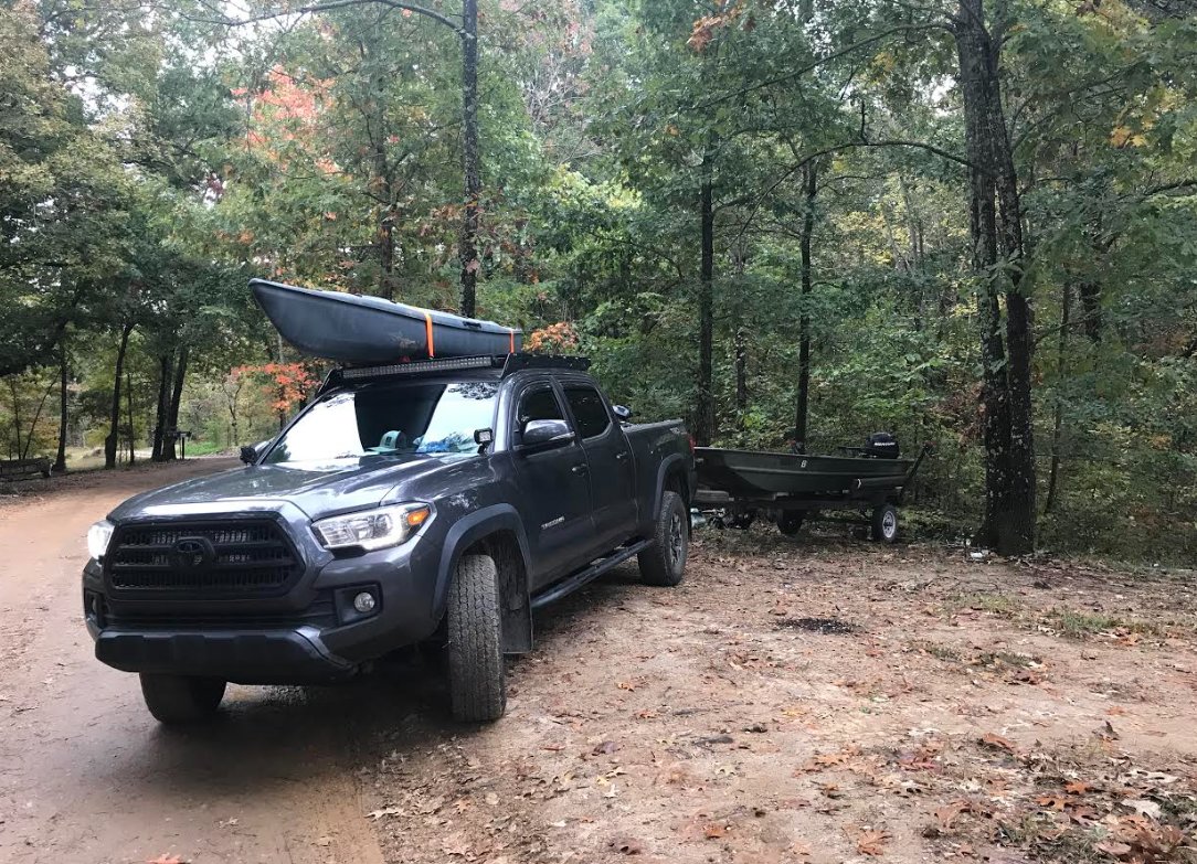

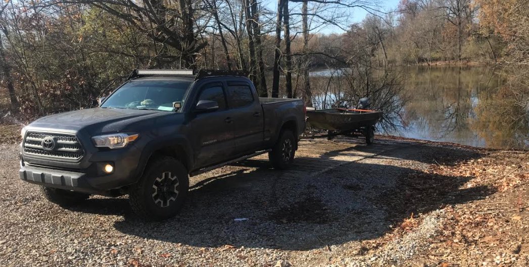

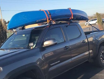

    Boat season:
    You can also see where I plasti-dipped the grill black and installed the 40" Rigid lightbar. And yes, I plasti-dipped the grill in my apartment's second bathtub. Harbor Freight blue tarp for the win.
    I traded my sit-in blue kayak in for this sit-on grey kayak in the attempt of hunting with it. I've rigged up a trolling motor mount to it, and the day this picture was taken, we were heading out to test it. Jon boat as backup. As a note, I duck hunted in the timber with the kayak once. It's a handle. Private land could work, but it's still a handle.

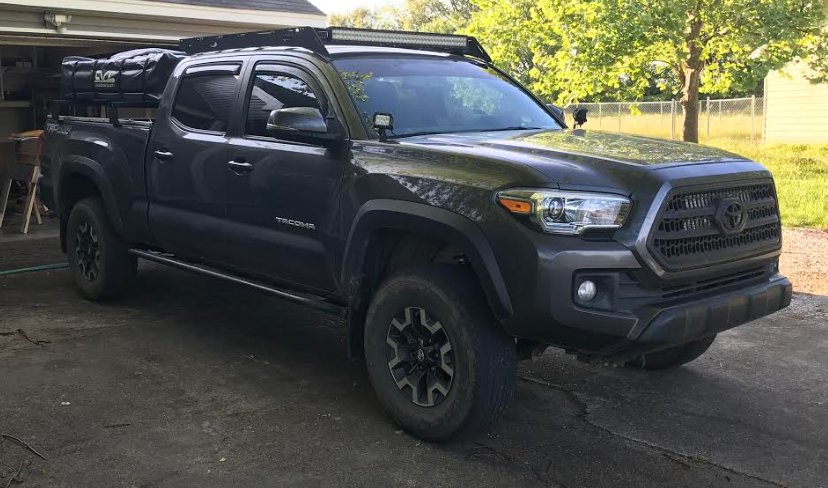

    Suspension seems to be something that never ends.
    I first had a Wheeler's AAL, Dobinson's C59-314, and Dobinson's shocks all around.
    Issue was the weight up front. The Mobtown sliders are great, but they do add weight. I had also added a steel IFS skid from Mobtown. That's heavy too. I underestimated the weight of them, and the front sagged more than it should.

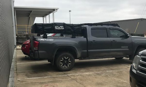

    I then acquired a CVT extended Summit Mt. Rainier locally off a guy selling his camping stuff. It got mounted on KB Voodoo hi-rise crossbars.
    The KB Voodoo crossbars seem kinda finicky. I've got a chain hoist in my garage to install/remove the tent, but the crossbars get bound up with their mounts and make it hard to get the tent off easily. I'm considering making my own bed height tall crossbars out of extrusion, but I haven't done it yet. These hi-rise bars also seem to chatter a lot with the tent on. BUT, I haven't fully associated that rattling with the bar/mount area or the bar/tent area. Needs investigation probably.
    Like I said, the C59-314's weren't enough, so I upped to C59-352's. They're 730# coils; so, they're stout. Stout enough that I'm considering a winch more and more. At that same time, I changed out the stock pack + AAL for medium Dakars. I ALSO changed the UCAs for SPC UCAs.

    It's kind of a multi-faceted comment really. I can speak to the Dobinson's stuff that I've had, but I can also only compare it to what I had directly before. But with that caveat, the initial 314's (590#, I think) that I had up front rode great for a while. Actually, they rode nice all the time I had them for the most part. Before those, I had the added weight of sliders and that IFS skid on the squatted stock coils. This made it ride rough, sit low, and didn't look as good either. The 314's lifted it up, and it rode nicer as the suspension was no longer suffering from hitting the rock wall of sagging, precompressed coils (pretty sure those aren't technically correct words, but you know what I mean). But, as the weight that I didn't particularly account for began sagging the 314's, it started to hit that rock wall upon compression like before. Not nearly as bad as stock, but it still did.
    Now, with the 352's, I'm probably over-sprung. I like to say that it rides stiff. BUT, unlike the lower # coils that were squatted, the 352's actually feel to have proper travel of the suspension. Still stiff, mind you, but the suspension moves the way it should despite the added weight. I think having a hidden winch mounted up front will do good things for the ride.
    Shock-wise, they're fine. The only comparison I have is to the stock Bilstein 4600s. Any complaints I had with that stock setup were to blame on the springs not handling the added weight. I do think these Dobinson's shocks allow the truck to roll in corners more. I'm not confident in the same at-speed, on-road cornering that I used to be. That lies somewhere in the combination of, primarily, the shocks but also in the truck sitting higher (higher center of gravity). I forget which is progressive and which is digressive, but Dobinson's and Billie's are opposites. The Dobinson's will induce more body roll, but the Billie's will be harsher on sudden impacts from the road, I would think. No personal experience with 5100s. Digressive and progressive is the difference there.
    I got medium Dakars for leaf packs, and they're stiffer. But they're also rated for constant 300# over stock all the time. I'm probably at half that. But I will say, with the AAL and full medium Dakar leaf pack, that sine wave vibration feeling that would happen with the stock truck when going over speed bumps went away. You'd probably experience that with the new Dobinson's leaf pack too.
    I don't think you'll be disappointed with Dobinson's. A lot of it depends on your added weight and coil selection. I need to go back and add it to the original post, but I also did the ECGS bushing when I first put Dobinson's in. So, I haven't had any experience with a lifted truck without that in there.

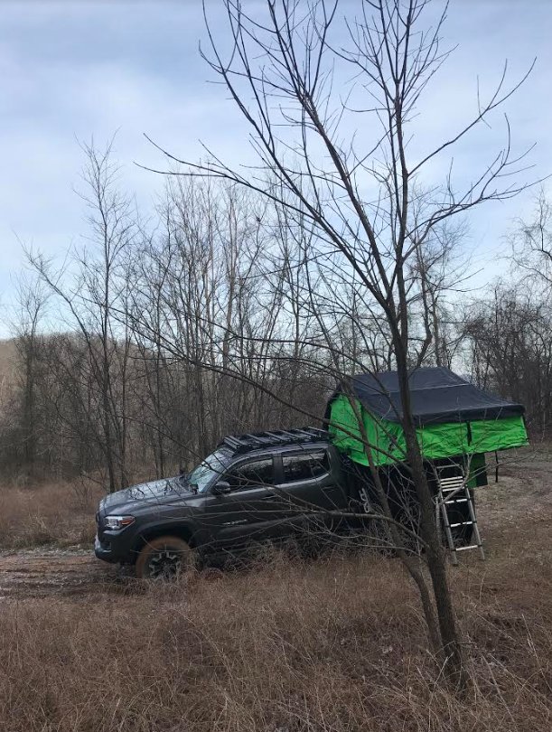

    The first night I took the CVT out it was in the 20s. The insulation pad on the bottom of the tent along with my Grizzly sleeping bag kept me warm...enough.
    ^also, camera's at a angle, obviously. lol

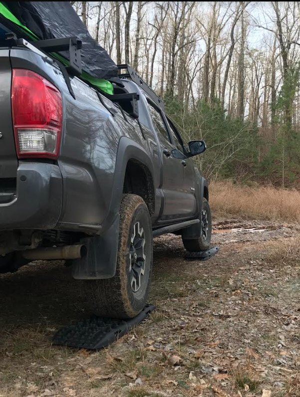

    I also carry cheap, X-Bull recovery boards. I bought them on Amazon for less that $100/pair, I think. They don't seat together nicely like Maxtrax, but they do their job. I've used them for leveling like below; I've also used them to recovery my dumb riding lawn mower when I was too ambitious, along with a few other various vehicles. Not my own truck yet, just other people's.

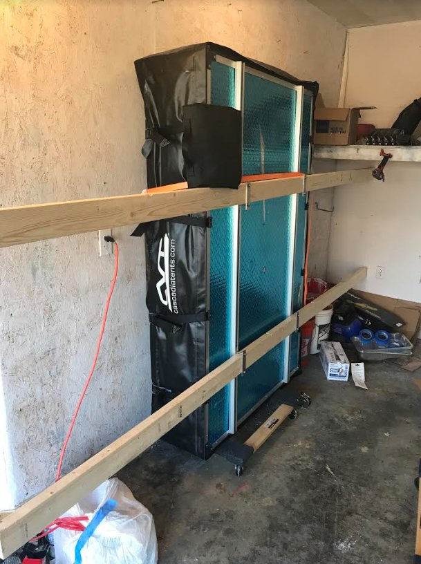

    Incidentally, this is how the tent gets stored when I'm not planning on camping.
    Yes, I put the tent on once using 16' 2x4's. It...uhh...*worked. But it isn't ideal. I now have a chain hoist, which works well. But, it would work much better if my ceiling had two more feet to it. That's part of the reason I'd like to go with slightly lower crossbars over the bed. I'm toying with the idea of getting some aluminum extrusion lengths and making custom brackets to hold it to the factory bed rails (the same way the KB Voodoo ones mount). I just haven't done that yet.

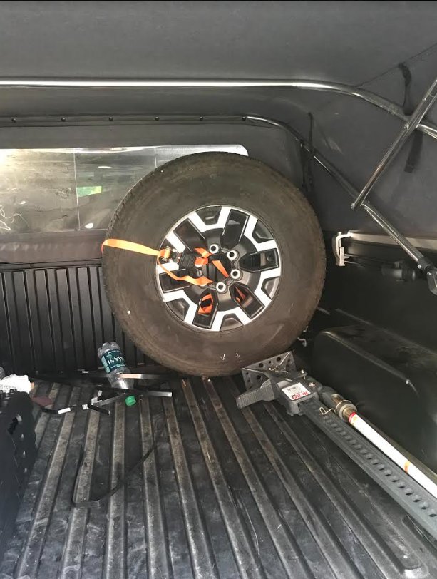

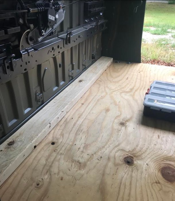

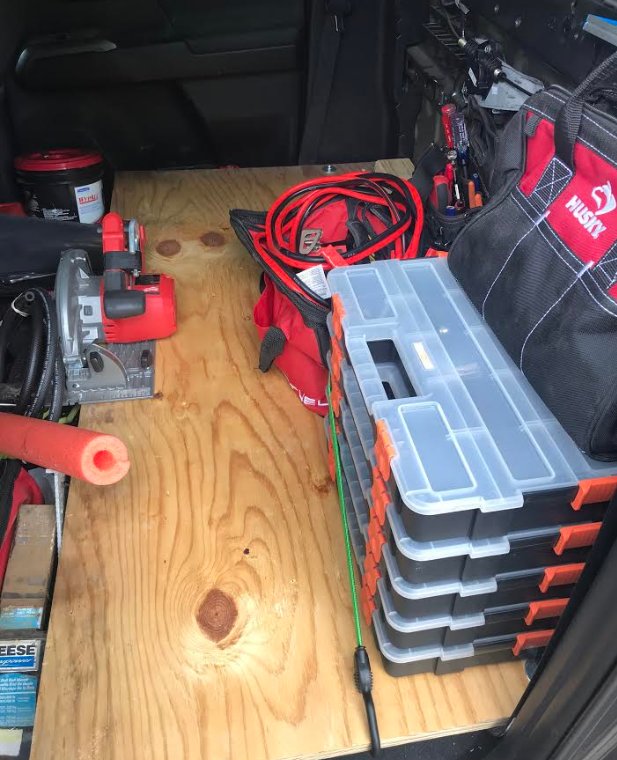

    So I removed the rear seat and the panel behind it maybe a month ago. It's kinda noisy without it, but I knew I wanted to go rear seat delete. I keep plenty of tools with me cuz you never know where you'll need them. These people that run around with no tools blow my mind.
    I had some plywood from a floor I removed sitting around; so, I had no reason to not go ahead and work on it. It's cut to fit and bolted using the OEM seat mount holes. They're M8-1.25 x 50mm with fender washers for the floor. I have a feeling I'm going to need longer ones for the back piece if I mount it directly to the sheet metal. I'm also considering cutting a strip of wood to mount to the sheet metal right under the rear window and mounting the back sheet to that. That would allow me to manipulate the angle of that strip so it would seat nicely to the back sheet of plywood. That's my thought at current: subject to change when I actually get to it.
    I can already tell it will be way more space efficient storage for my tools, which will allow room for a cooler in the middle and room for my dog or gear storage on the other side.
    It just needs the back sheet mounted, paint/bedliner it all, sound insulated, and install tie down anchors. I opted for some triangle type mounts that are very similar to the OEM ones installed in the bed. L track is cool but dang expensive. Should be safer in the unfortunate event of a wreck too. Having some of that heavy stuff anchored to something solid would be a big positive in that instance, I'd think.

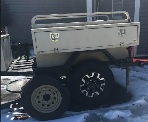

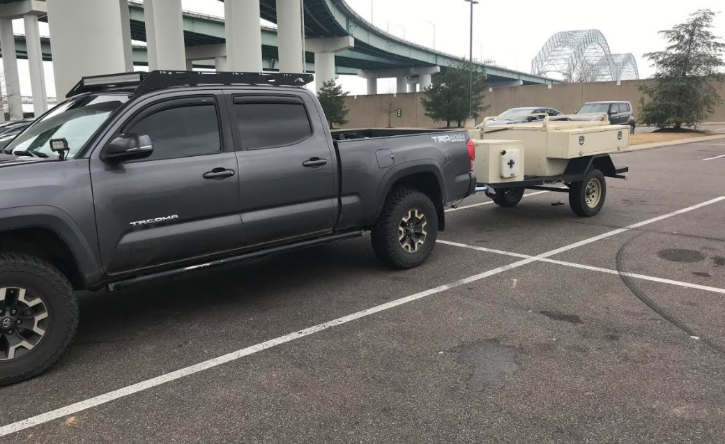

    Another thing I've done is I've purchased this trailer:
    It's a Safari Equipment USA trailer, and I've been unable to find that much info about them. There's a thread on some forum from 2014 about them, but that's all I've seen. It'll be a neat setup since I can mount the CVT to it, back it in the garage, and hook up to it whenever I feel like camping. The kbvoodoo bars I had worked fine, but the hoist on my garage ceiling is about 6 inches too short for it to be a simple mount/unmount. The lug pattern is 6x5.5; so regular toyota wheels will fit, but it either needs spacers or a slightly longer axle to clear the back of the tires:
    That'll give me the opportunity to run what's left of the Goodyear stockies, and I'll get a little more clearance.
    The trailer is really pretty simple. The main box lid opens up with gas shocks, has a side-opening door for the rear, has two toploaders, and a standard tongue box. It needs some paint which will hopefully get addressed once it warms up a bit. I'd like it to be a dark grey color to kind of go with the truck's MGM paint. It'd be really cool to have onboard water and electrics built out in it. But honestly, I need to take it on some trips to get a feel for what I really need.

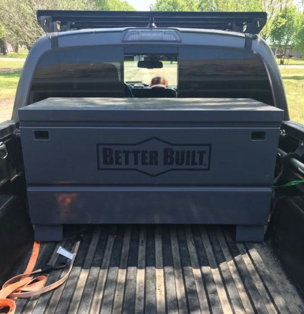

    I will comment too on the rear seat delete. I love it for putting gear in the truck; however, my current tool storage situation doesn't stay tidy. The cheapo home depot keep all the tools separated well, but they're a pain to take apart to get one thing only to have to stack them all back up. If they were sitting with the handles straight up and could be pulled out as needed, that'd be nice. It's making me consider going to a bed toolbox. I've got the 6' bed, and I've recently noticed that I leave my Amazon special traction boards up there all the time. So I wonder if I'm not actually using that space that much? I've looked at crossover boxes, and those seem expensive for how break-in resistant they are. It leaves me thinking about this:
    At 42" wide, it should fit just within the wheel wells.
    https://www.lifebetterbuilt.com/products/jobsite/JobsiteStorage/2042-BB
    Quite a few contractors run 48"/60" job boxes in their diesel truck beds around here, and I love that this one is grey...
    Not a lot of job boxes mounted in tacoma beds from what I've been able to find, but those boxes are pretty tough comparatively speaking. I'm open to suggestions haha

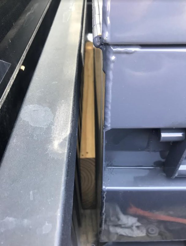

    Well, the rear seat delete has been fun, and maybe it'd be more useful to somebody who's going for a full expedition rig setup. But in reality, it's kinda noisy, and my tools/gear just won't exactly stay in place. I have tie downs installed on it, but who wants to tie down stuff every time? Boxes, even if messy, contain all the gear. And there are times that I really would like to have the seats in the back. Not often, but every once in a while. So, I went the job box route.
    It's a Better Built 2042. 42" is as wide as you can go between the fender wells. There's about a 7 inch gap on both sides of the box up at the front. This Better Built jobbox has the square holes in the feet for 3/8" carriage bolts. There's 2 carriage bolt holes on each foot, but the outside ones are 1" from each corner, both ways. I ran 3" long bolts, but could have gotten away with 2" ones. This maybe adds to the security of it, who knows. With good locks in it, you can still break into these boxes if you have enough time, but they're a handle. Nylon locknuts and fender washers are a must. The rearward bolts could be cut with a reciprocating saw, but the front ones are not nearly as accessible. It'd take about as much time to cut them off as it would to undo them with a ratchet wrench (which, btw, is the only good way to run locknuts down 3" bolts in a confined space). Unfortunately for installers and potential "uninstallers" alike, none of the bolts really have access to run deep-well sockets.
    A 2x8" worked great for me to set the space between the front of the bed so the lid clears the glass nicely:
    Aside from organization stuff on the interior of the box, I plan to add foam gasket around the lip of the lid and pipe insulation around the side handles (because the clank). I'm a big fan so far, and I'll be glad to have some seating back for friends occasionally (but not too much...).
