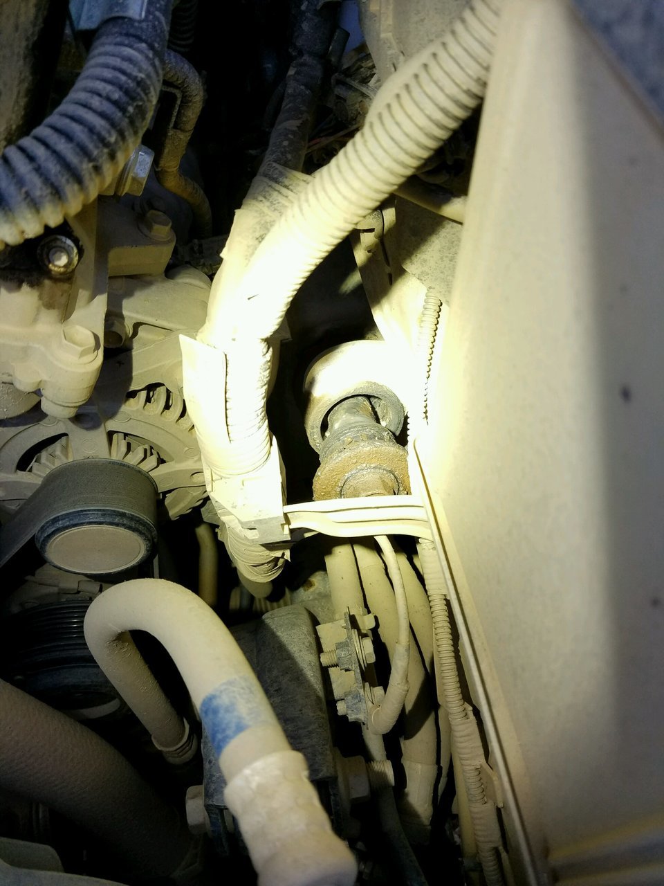

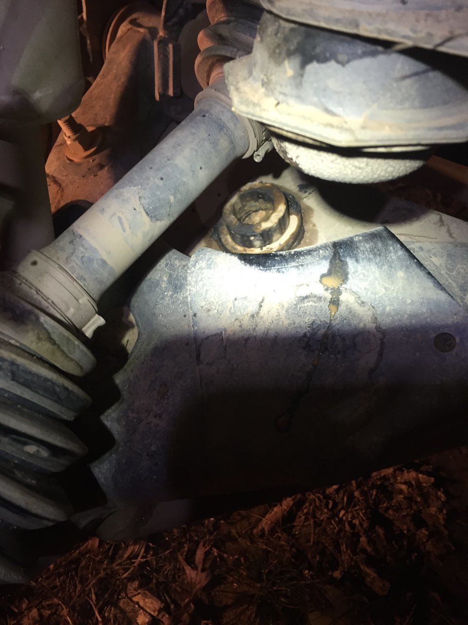

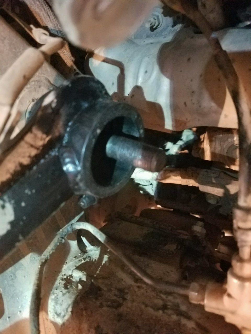

    This was on the correct way and torqued properly. It backed out and the bushing fell off while the bolt worked its way forward. @BeeSharp its a small body tab under the hood you can not see. After we repaired it and limped it home we use the factory nut with a nylon lock nut also. Reason for this other than a cotter pin is when you have to grease them you back the nut off a little and grease it, drive it around then tighten it back up. With a cotter pin it can be a pain to get in there.

    That’s pretty smart to use nylock nut on top of the factory one. I’m gonna suggest this from now on when people talk about UCA installation. Do you happen to remember the size?

    Not but i remember we had a birch of a time locating it when we were in Hot Springs Arkansas. Went to 10 stores but I don’t remember the size.

    Just found the answer in another thread in case you were curious. M14x1.5
