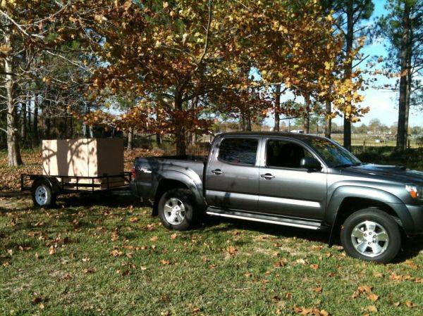

    Currently I have 5100's all around, eibach springs set at 0, and the TSB leaf pack in the back. I'd love to buy the OME 2" lift, but I can't make myself spend the money on that. I'm trying to keep the front end from sagging. If I set the 5100's at 0.85 will I stay where I'm at now, or sag?
    If it will sag, what are my options? Can I use an OME spring up front instead of the eibach for the time being?
    Thanks
    I have a decent load in the bed so the back end looks low in this picture.
