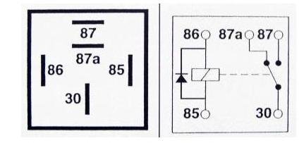

    It must be on/on and I've never heard of a double throw switch capable of on, off & on... wouldn't that be triple throw?
    Here's a pic that explains how the 5pin relay works controlled by a single throw switch:321F5E3A-BF8E-4F1F-B882-09720A841F16-683-0000009F25890210.jpg
    In simple terms, rather than using your finger to flip the DT switch you use a ST switch to make a relay act like a DT switch

    just finished wiring up the switch- couldn't have been easier. big thanks to @landphil and the TW crew for all the help!

    tracked down a SPDT on-on switch via Grainger and followed @landphil's directions.

    This actually inspired me to use a factory VSC off switch I had laying around. Wired up a 5 pin relay this weekend only to find out the stupid switch is momentary! Now I have - for the time being - the ugliest toggle switch operating the relay.
    Is that switch you posted really An on/off type?
    Or any wizards out there know how to operate a relay with a momentary switch?

    ya, unfortunately the CH4X4 Switch is on/off. i ended up using an on/on from Grainger. maybe someone smarter than me can help with the relay

    No the relay isn't the problem. Thanks, you answered my question. I'll be able to use the CH4x4 switch. The factory VSC switch which I have is a momentary so it doesn't work . Unless I wanna hold it down all the time haha
