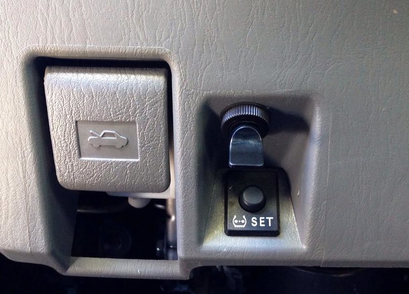

    To all the folks that put your ABS kill sw. In an inconspicuous spot, GOOD FOR YOU!!
    took truck in to dealer to have seat heater fixed. They bumped my dash mounted sw. Freaked out over the ABS "codes" they were getting. Reflashed truck with kill sw in the "killed" state. Now as soon as you start the truck and move a couple inches the TRAC light comes on and all my safety and traction features don't work. Had tons of fun explaining this one but now they flashed again with kill sw in "normal" state and all is well.
