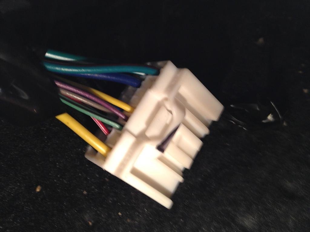

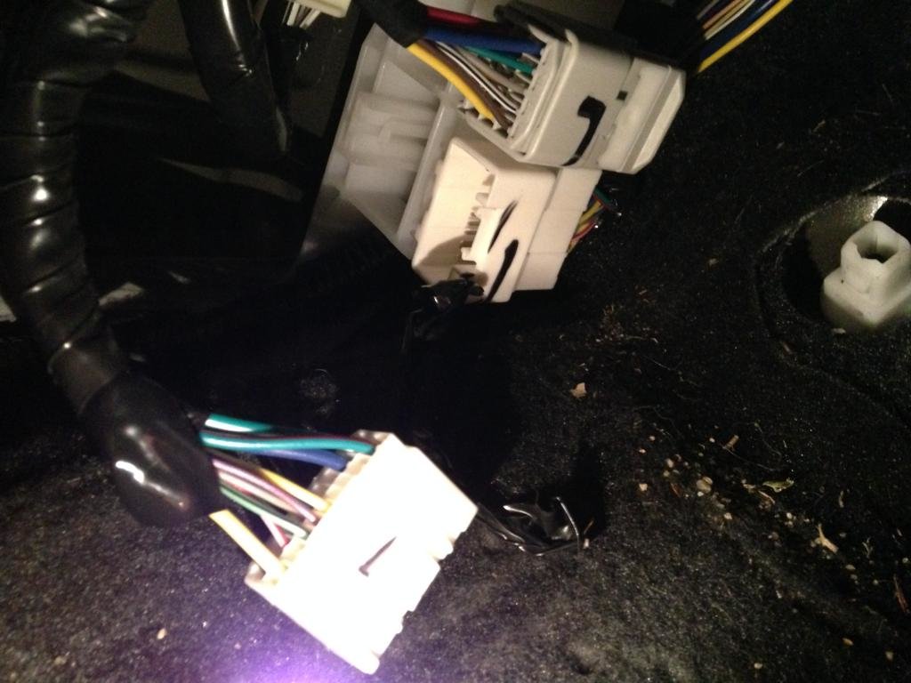

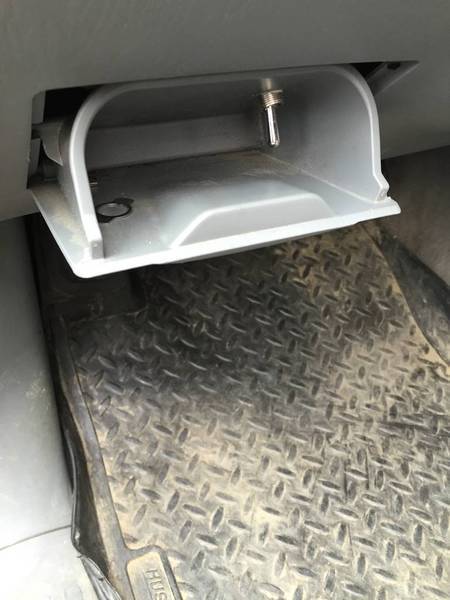

    Okay so I have my switch soldered, ground mounted... And my harness looks different?! I don't see the blue/yellow. Can someone help me out here?

    It's a 2013 TRD off road btw

    Nvm. Wrong module

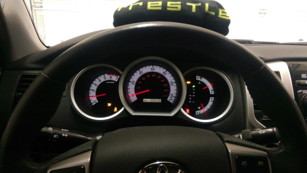

    I just did this mod and need help, I followed croms write up to a T. I have a 06 with 4x4, vsc, and locker. When I am at a stop and I hit the switch my abs, locker, vsc and the car with squiggly lines lights are on so all is good right? My problem is when I am driving if I hit the switch all of those lights will light up but another one will also light up, the vsc trac light and if i hit the switch again they will all stay on until I turn off the truck and turn it back on. anyone know what the deal is?
