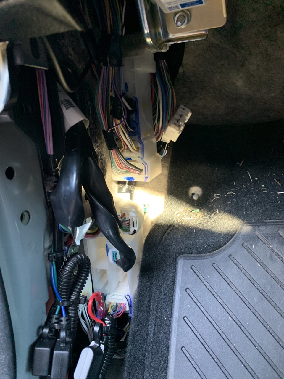

    Help, 2018 I got different plugs see photo

  3. Jan 21, 2019 at 4:58 PM
    #543
    TXpro4X4
    TXpro4X4 Fuck Cancer!
    Oct 29, 2011
    #66093
    29,537
    Bryan
    Costa Mesa, CA
    2011 TOY
    Welcome Shane
    I would need to do more research to help.
    Did you get it?
