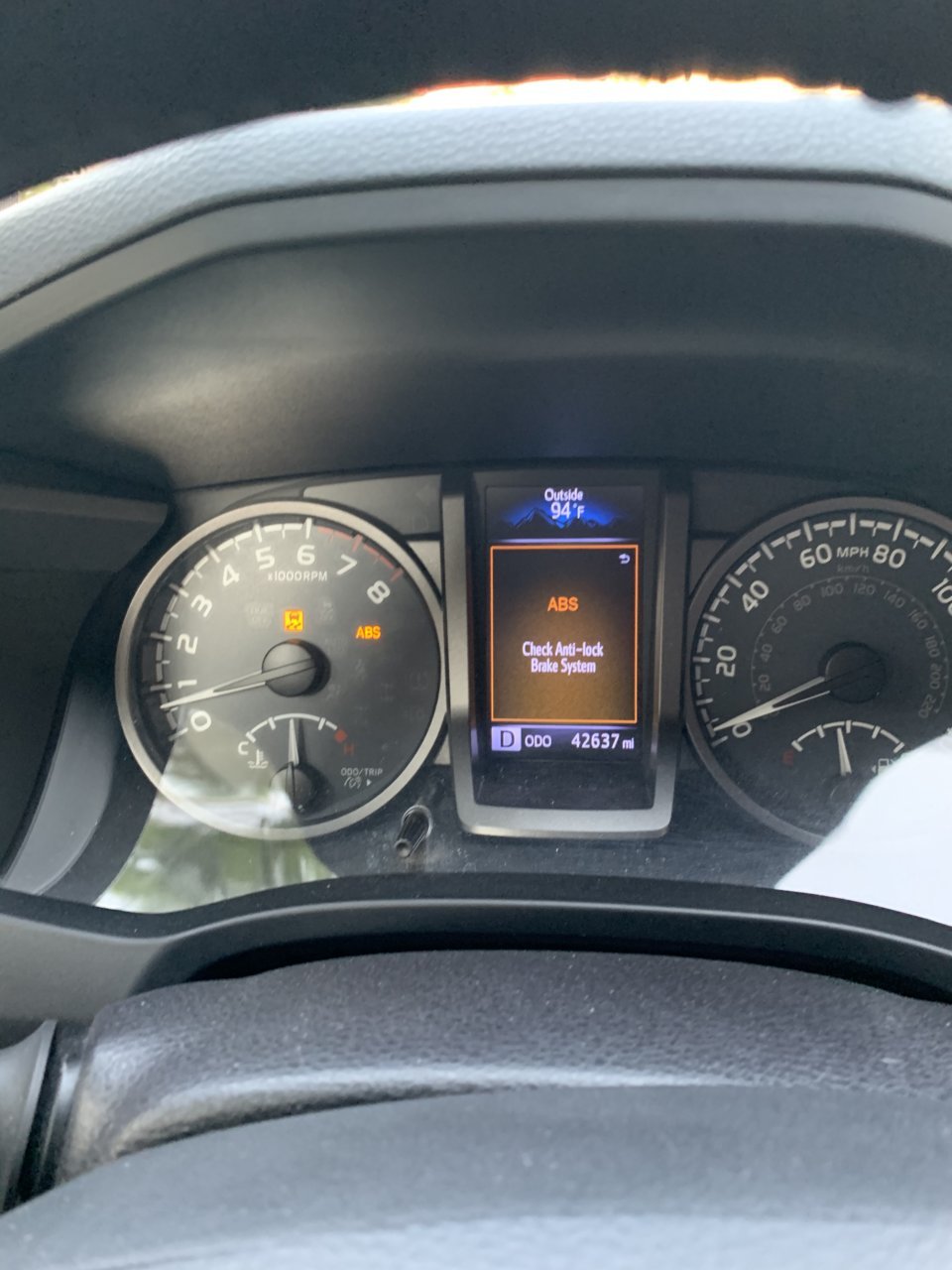

    This came on for 20 minutes and went away on its own the other day, now it’s back.
    any suggestions on how to fix this? Is it still safe to drive?

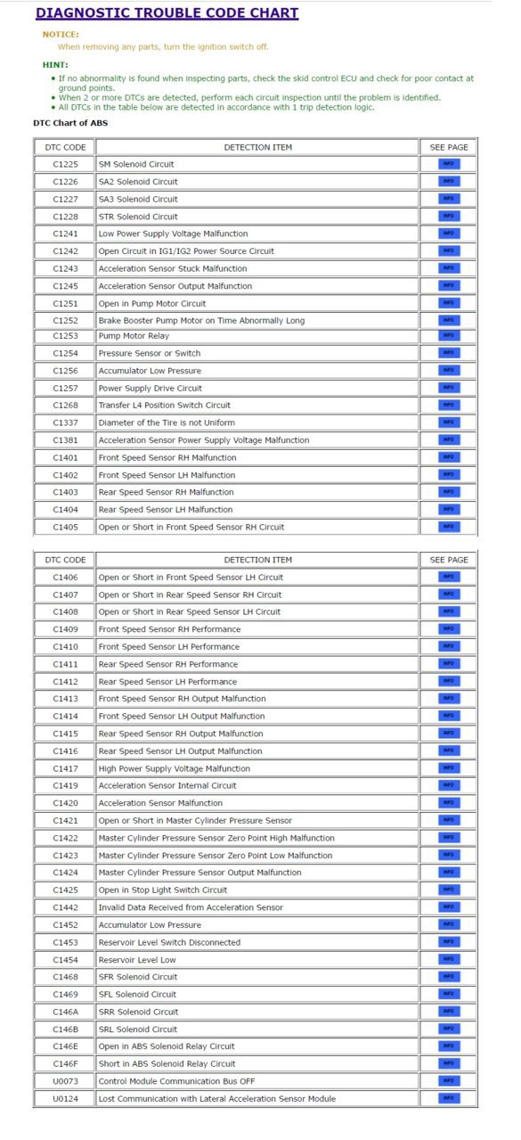

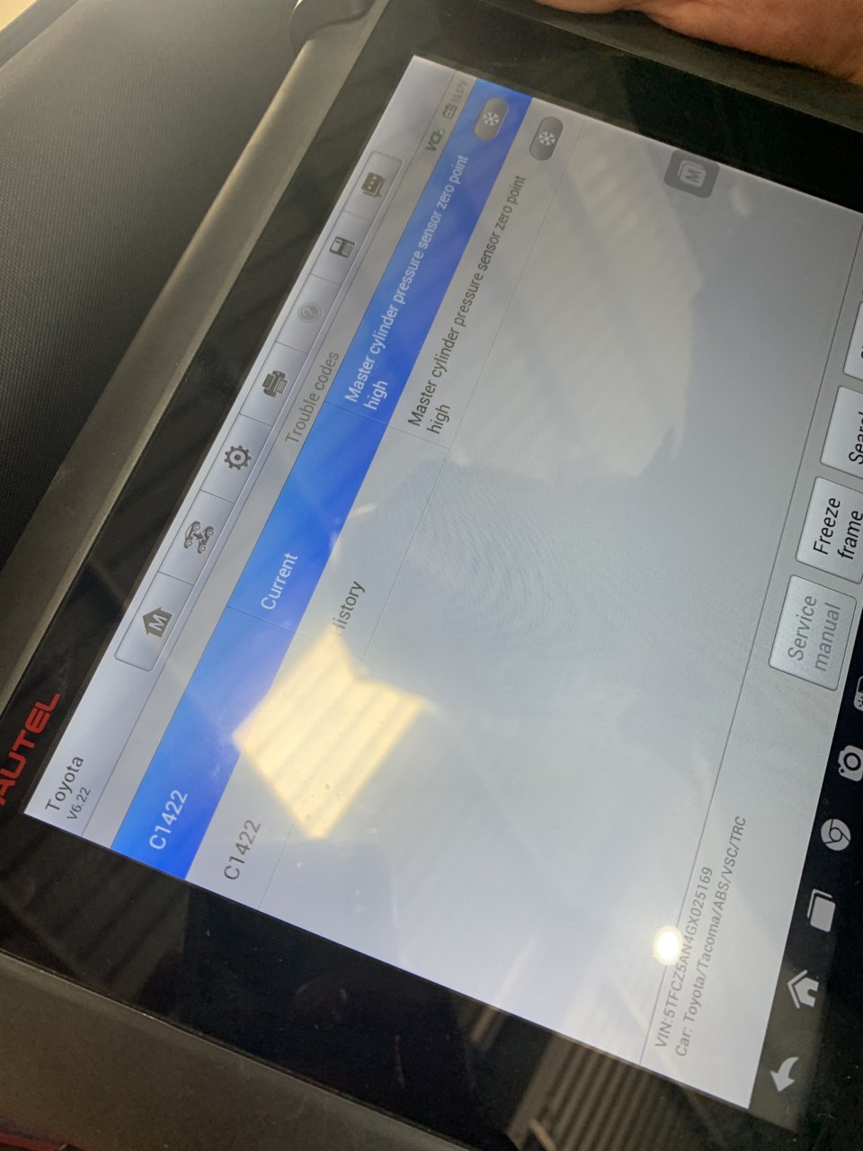

    This is the code I got

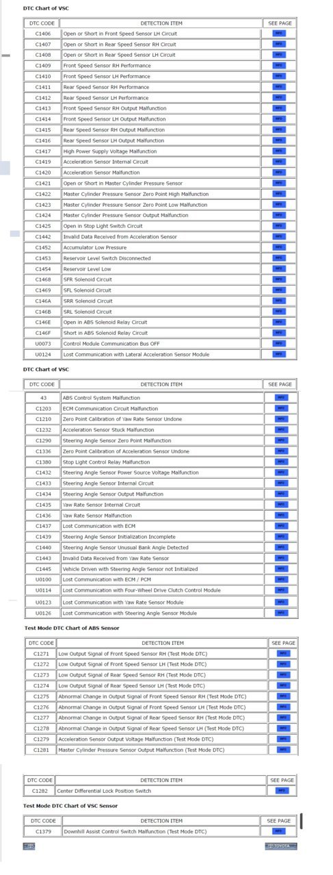

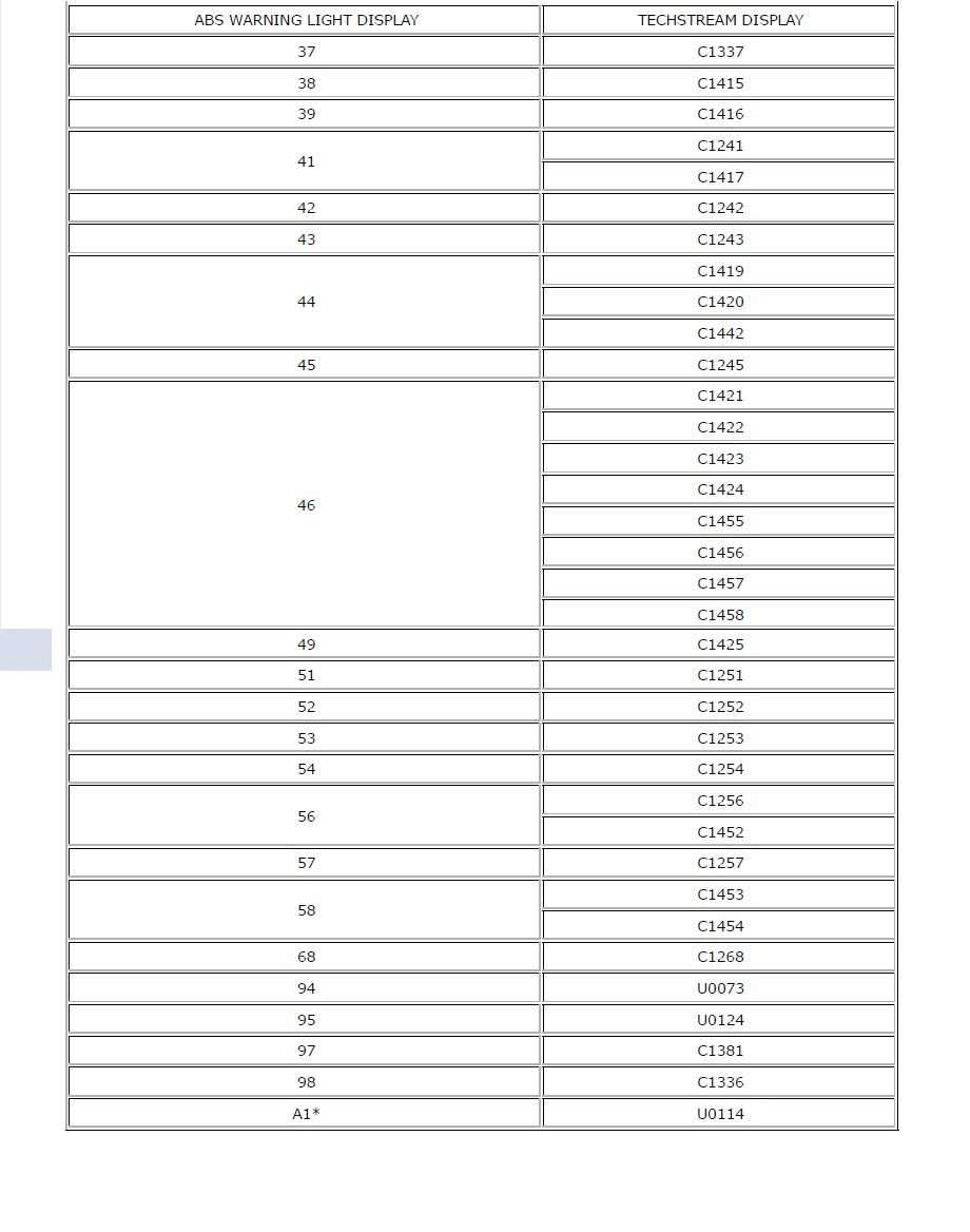

    Now you have an idea. The trouble shooting in the FSM seems to think this is more likely triggered by the stop light switch circuit rather than the master cylinder pressure sensor circuit.
    If it was me, I would hook up techstream and check function of master cylinder pressure sensor checking that it reads <0.86 V with brake pedal not pressed and increases in voltage as the brake pedal is applied. I would then check that the stop light switch is off with the brake pedal not pressed and that the brake light switch comes on with the pedal depressed.
    If all this checks out I would clear this particular code, confirm truck brakes normally, the brake lights function, and not investigate further unless it re-triggers.
    If it triggers again you need to determine if the stop light switch isn't coming on when you press the brake pedal or if the master cylinder pressure sensor reads high with the brakes not applied.

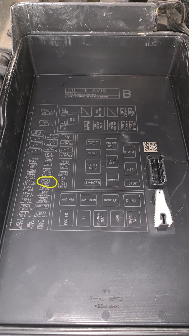

    The “stop” fuse has a 7.5 amp instead of a 10. Should I replace it with a 10 a ? Think this could be the issue?
    thanks.

    It could be the issue if it's blown.
    BigWhiteTRD and landphil like this.

    C1422

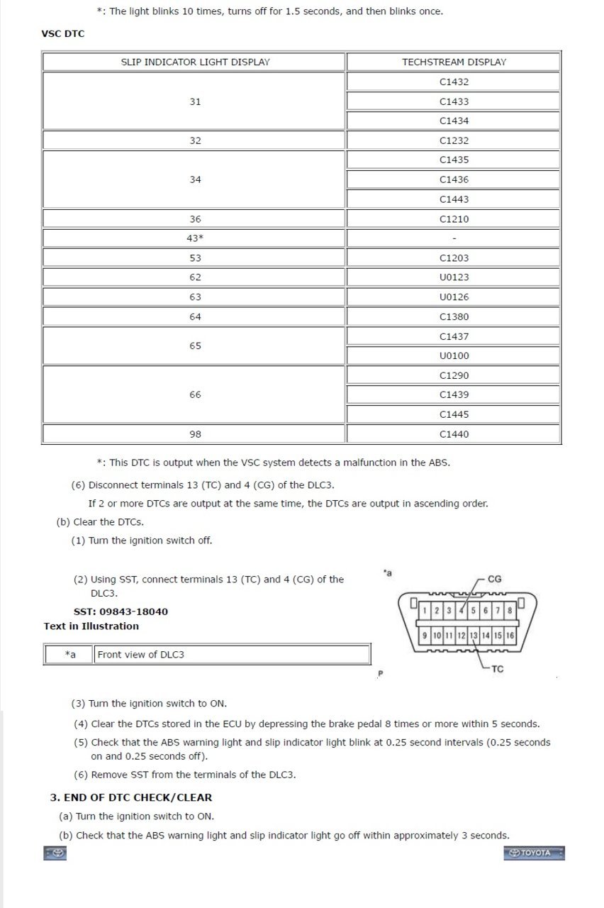

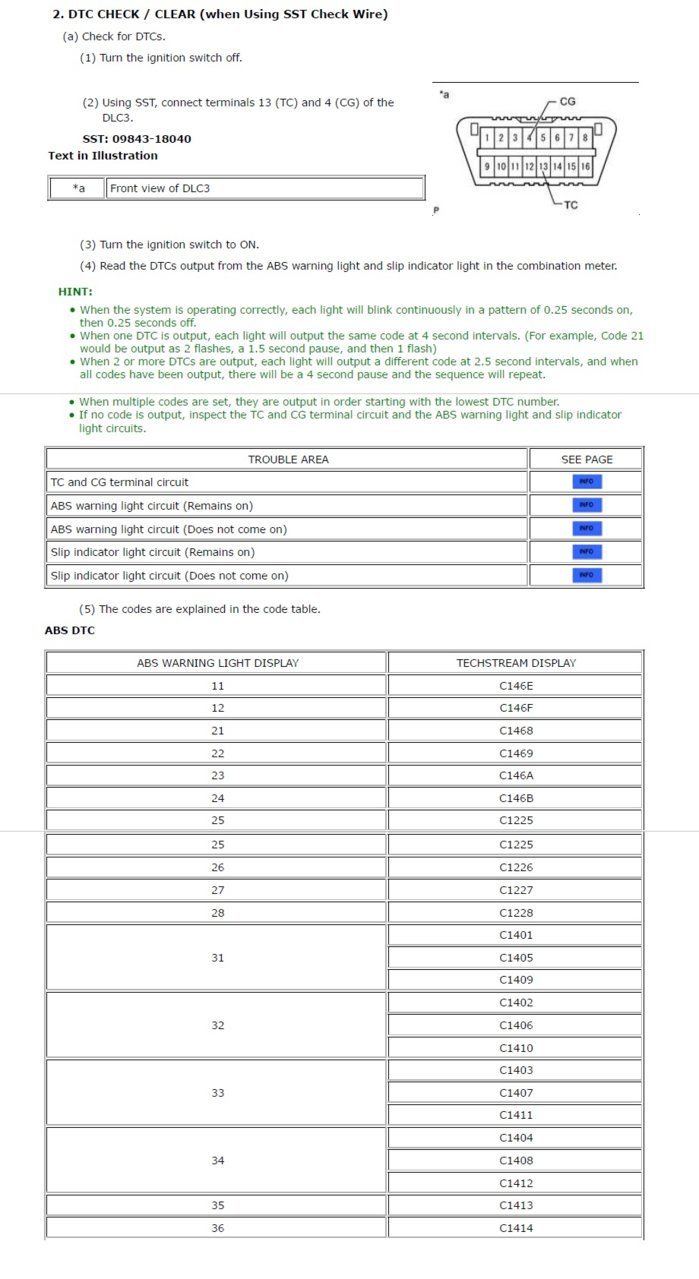

    If I understand, it looks like.... nevermind, Ben (@ShimStack) beat me to it by a good margin
    ShimStack likes this.

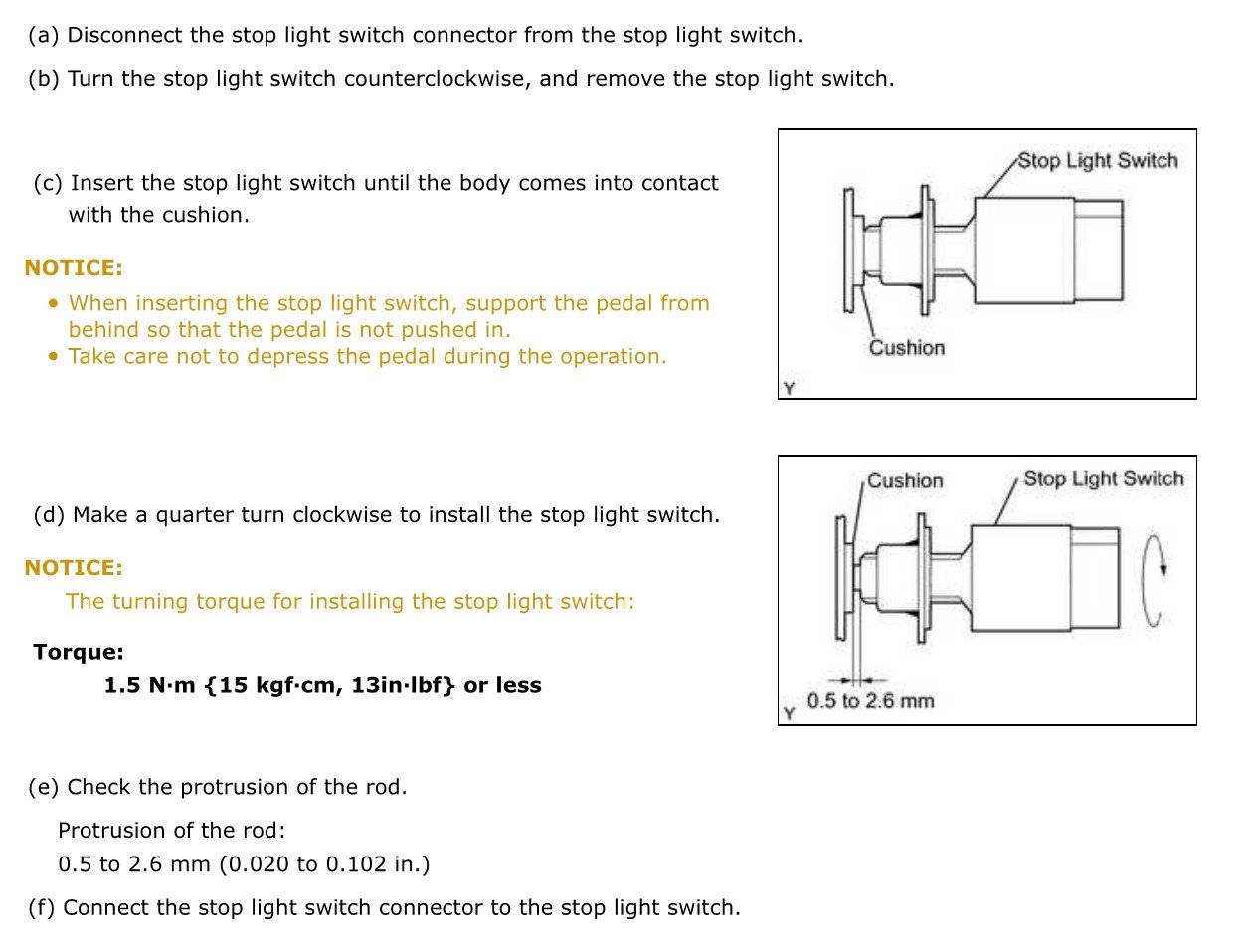

    Haha, dang, I had the snap from the FSM and forgot to attach it. Beat me to that! :thumbsup:

    Think we've determined the root cause!

    I adjusted the brake light switch and the abs light is gone. Turns out it was pushed in too far.
    I fixed this gap.
