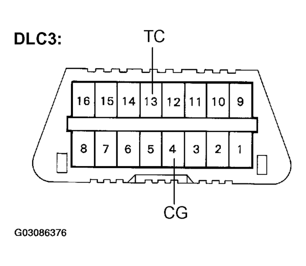

    Try this. No scanner needed

    Is that the OBD II harness? Or is that something else?

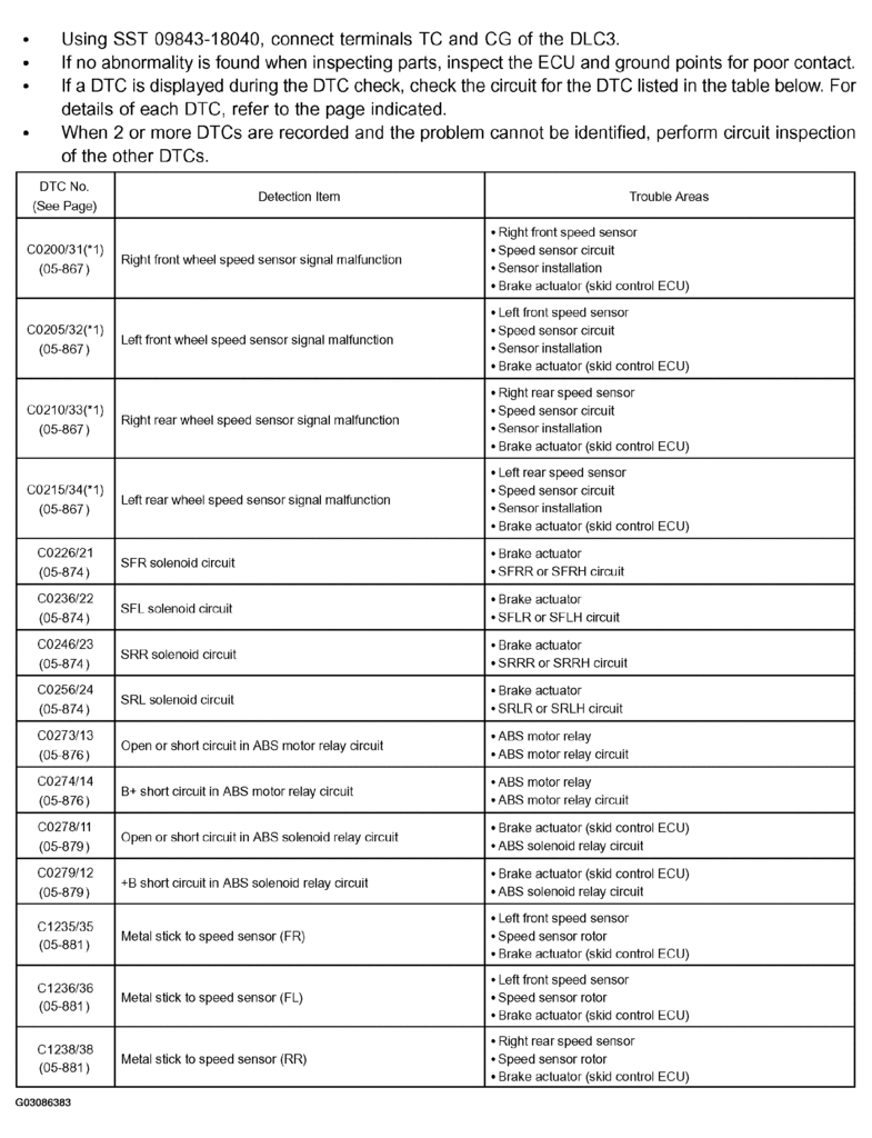

    Im trying to diagnose an issue form this thread...
    http://www.tacomaworld.com/forum/te...ke-light-after-tire-blow-out.html#post6970128
    but came across the chart you posted:
    I jumped the OBDII and it gave me
    34
    41
    sound like left rear (34)
    and a battery issue? ( 41)
    BUT, in the chart there is an * that says, even after repair a certain procedure must be followed to reset the ABS light.

    The *1 just means you need to fix the problem & the system should self clear the code. The system automatically checks for issues when you first turn the key on, if there are no issues the light will stay off. Another way to possibly ensure that the codes are cleared is to disconnect the battery for 30 mins so the computers completely shut down and lose all memory (this doesn't always work though). Sometimes you have to drive it a few miles to get it to clear too, depending upon the code the system sometimes wants to see wheel speed data to verify repair as well.
    To me it seems you need the left rear wheel speed sensor (possibly) and a new battery (possibly). I would start with the sensor & go from there.

    Is there a way to clear the abs code without a "real" scanner? Ive seen several things about jumping pin 4 and 13, and tapping the brake 8 times in 5 seconds, i dont want to short anything out in the OBDII if that wont work.
