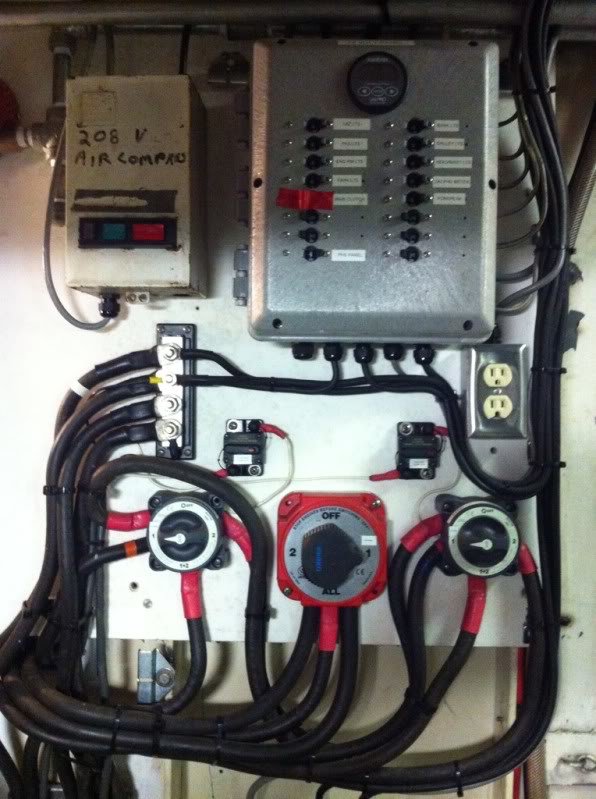

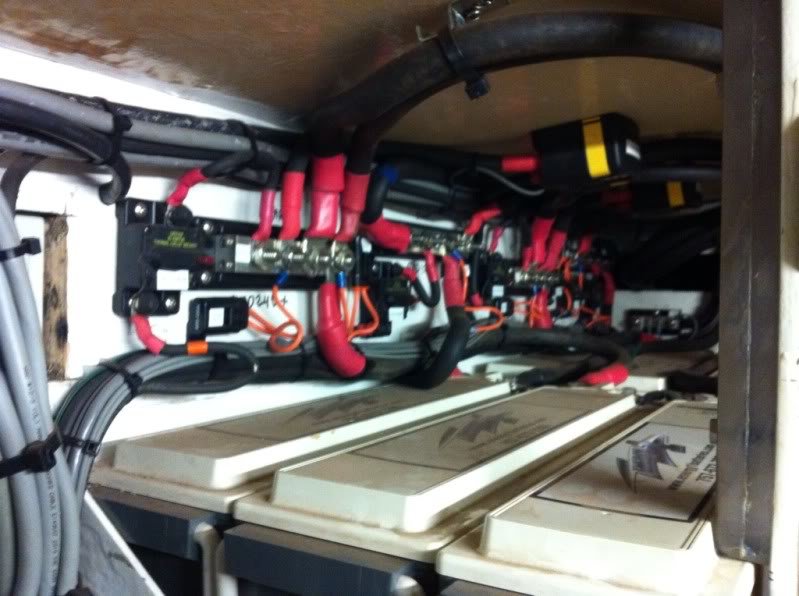

    Not to thread jack...but, I think you and I are a little biased when it comes to 12V system wiring.
    Here's what it should look like.

    I'll take a wild stab in the dark and say it's because you didn't disconnect the negative battery cable on your battery. It's just a good rule of thumb to treat any electrical wire as if it were live.
  17. Jun 5, 2012 at 3:26 PM
    #17
    Pugga
    Jun 18, 2010
    #39131
    38,707
    Massachusetts
    '19 Ford F-250 6.7 SCrew
    F-250 Land Yacht Mod
    I'd go with this. Also, don't just twist the wire back together and throw some tape on it. Learn your lesson and at least fix it correctly using solder and heat shrink so it doesn't short out again.
