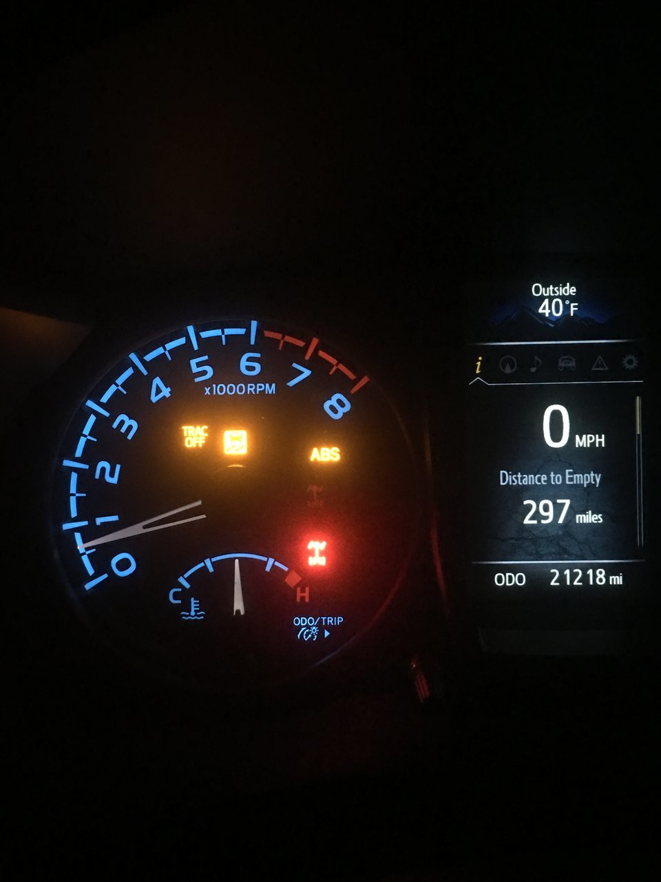

    2017 TRD OR Manual Transmission here with what looks to be a similar problem. All yellow dash indicator lights are solid, rear diff lock blinks. Has yet to go away. Recently had my rear differential worked on. May be related to a sensor back there?

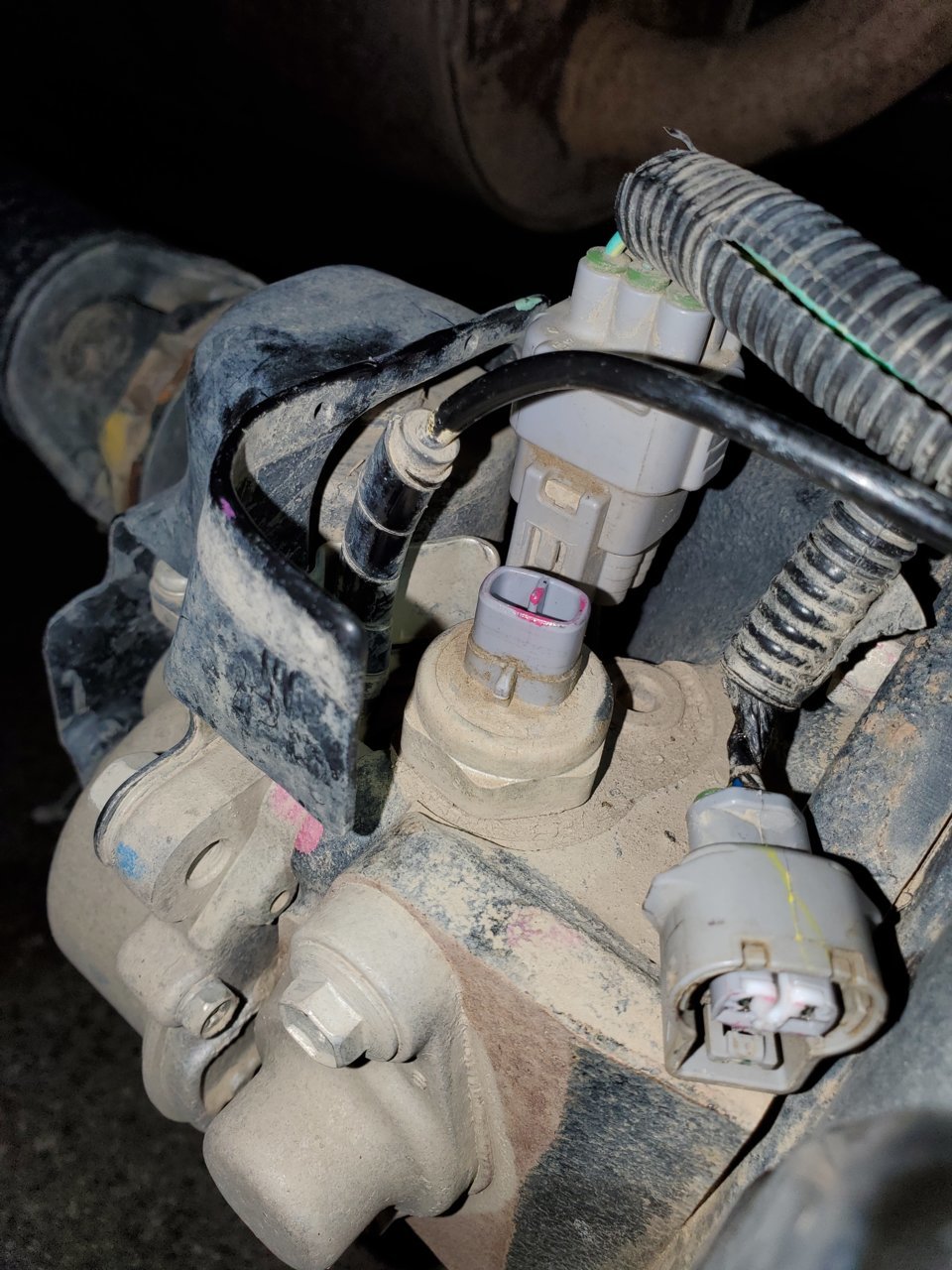

    I would be investigating the wiring to the rear end locker. From the dim light indicator that comes and goes on its own I would suspect a ground on the wiring somewhere.

    Yes look at the rear diff lock connector and the actual sensor as when the diff is locked it sends a signal back to turn OFF the ABS, TRAC, and VSC so you can dig yourself out without the engine management ramping down the throttle and tapping the brakes to reduce wheel spin. That is the Off-Road model advantage. Do dash lights go off when you disconnect the diff lock connector on the diff?

    Saw these replies at work today. Decided to start disconnecting cables in the parking lot since the lights came back on during my lunch break. First connector I disconnected did the trick.... all the lights went out. Reconnected and they were all back on. Repeated these steps a few times to be sure. Got home and looked up the component and it's center diff lock switch. I took it off and cleaned it as best I could with a rag and some DeoxIT spray and then reinstalled. Lights are out now. Really hoping this did the trick! Will report back after I've put some more miles on it.
